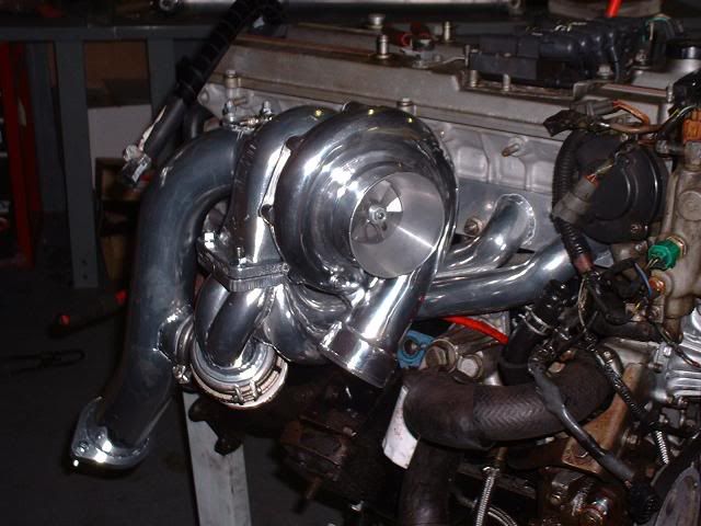

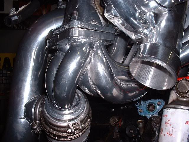

LOL Seth. My w/g is actually connected like this
I'm sticking with the same setup, no looking to spend extra $$$ when what I have is good and plenty, lol.

Hey Manny,
Yea you might find minimal gain in figuring out a way to get the angle of entry not so sharp as it is 90 degrees now and can cause turbulance in the flow.
As for the back pressure issue why does a 4" DP help spool? Less back pressure on the turbine blade so in theory if the WG is causing turbulance which causes some back pressure on the turbine it could hurt boost.
With that said seeing the numbers you are making it is not hurting you too much ;)
