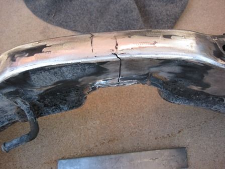

Subframe might be cracked which is twisting and causing your pull...

power...

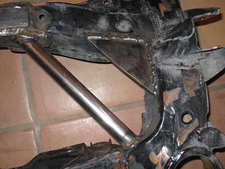

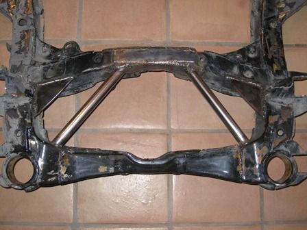

my car is virtually rust free and when I dropped the subframe to do the bushings it was cracked in half. I braced and reinforced it and now it pulls straight as an arrow, even under full load.

The common place for them to crack is above the diff...so it would be really hard to see without removing it...not impossible but tough...and without looking for it, they might have missed it.
You would have to drop the subframe (actually pretty easy) then weld in some supports. I welded some plates around the area that cracked, then the triangle plates and the cross bars. I then had it all powder coated, but a good coat of paint would work.
might consider replacing the subframe bushings while it is out....
