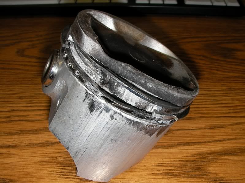

PTE IS JUST LIKE VENOM. Some people started saying they had no problems with theirs, maybe they had a good run and then a bad run, but either way it's not worth risking your engine. Look at the pic below if you don't believe it. The flow sheet had them at 380cc up to 520cc, but not one was even close to 550cc. The car idled fine, the afr was 12:1, and the egt showed ok, but the temp sensor was in the #6 exhaust runner where the 520cc injector happened to be. The melted piston was where the 400cc injector was. They are not using new 550cc injectors, they take a cheap lower cc injector and drill the hole/s bigger to increase the flow. The problem is that the needle inside is matched to the shape of the tapered hole. Even if the flow ends up being ok, the spray pattern will be terrible, which costs you horsepower.
They were purchased from Ebay. I sent them an email describing my problem, there was no reply.
