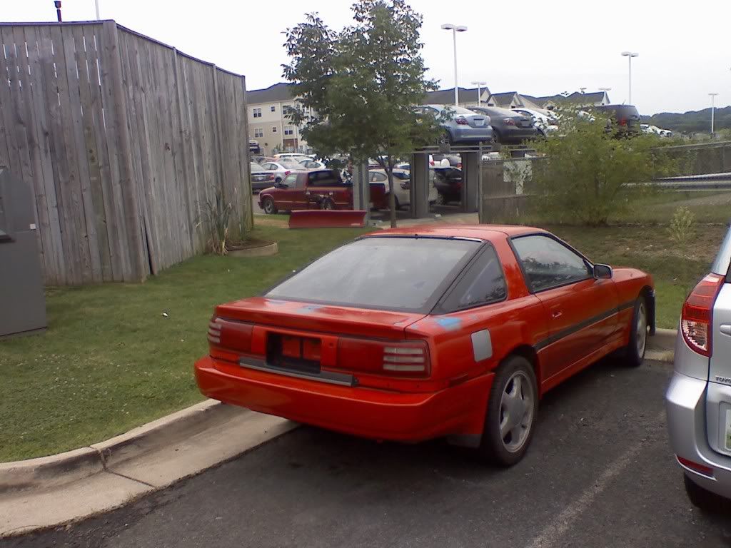

I have a 91 supra turbo which was purchased from another SM member back in FEB. i drove from MD to TENN to trade a 00' toyota celica. Which i had just put a new shortblock in and clutch.But let me explain the celica which is a very slow female car , i got it for $2,500 cant pass that up but the only reason i had to purchase this was i had recently totaled my 89 turbo , ahhh worst day of my life my first car gone in a flash .
For this the love of my life.
As soon as i got back home with the car i started to fix all the leaks ..i had the parts in no time cause my pops is the parts manger at the toyota i work at. I pulled everthing off to replace the oil return line off the turbo and the valve cover gasket,dry rotted hoses and the valley gasket. Well when i went to put everything back together i noticed i was missing things which i hadnt removed before and the wiring harness was destroyed . So after a week of frustration of trying to fix the harness i said F@#$ it. I was at a point were i had many choices sell the car of my dreams which at the time was a sleeping beauty ,buy another harness or swap the hole thing for a 1jz. Selling was not gona happen ,could just buy a hrness but had no money ,ifigured if i yank the motor and sold it i could use it to fund a 1jz so the choice was made .

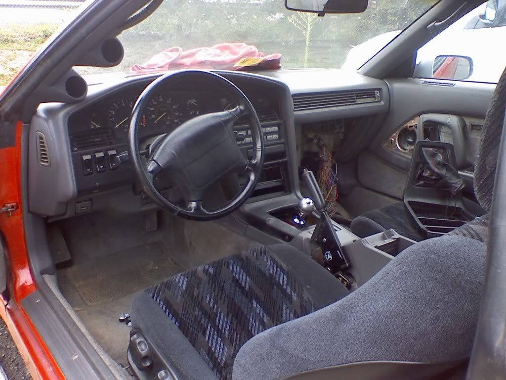

But while i waited for my engine wassmart enuff to do other htings such as interior i added a AEM wideband installed to the dash and a greddy turbo timer. I also started to paint my interior black heres what i have so far

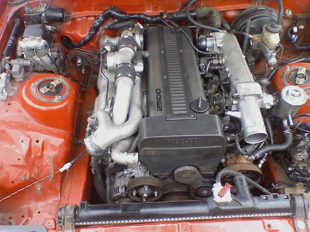

and in no time i had her in there...
But of coarse came across another problem the motor mounts just wouldnt go in ahhh wtf !
so now i am going to call the place i ordered the engine from because i was told and i read toyota supra 1jzgte but ibelieve i have soarer mounts not cool bro not cool untill tommaro for a update.

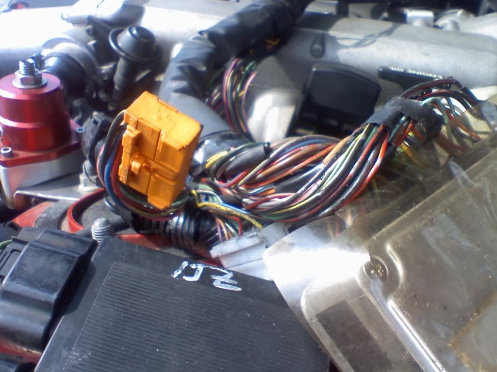

Dude im trying i ran the part number for the ECU and im starting to believe its a soarer engine and if thats the case isnt the wiring diff? isnt alot of s@#$ diff? if someone could let me kno that would be sweet.
yea the spot the the AEM wb is pretty sick .
Look at the coil pack cover.....its says JZZ30 - its not a 1JZ out of a Supra for sure. Supras did not come with clutch fans either ans yours looks like it did looking at the water pump..unless ofcourse you replaced it.
Ja70 does not have orange plug o nthe harness and if you look at the ecu plugs, it should be four rows of pins instead of the two rows on each plug for a Supra.
suprastanger507mgte
2x88+2x89+1x91+2x92=ME
3,148
Hayward , Ca
yeah you can probably just ask them to switch out the ecu and harness rather than the whole engine. Or if you feeling adventurous, you can get this running in your car either way. look at AF1jz's writeup thread and he has outlined everything to use this setup in a Supra. But you will still need to get the mounts/brackets for a jza70.

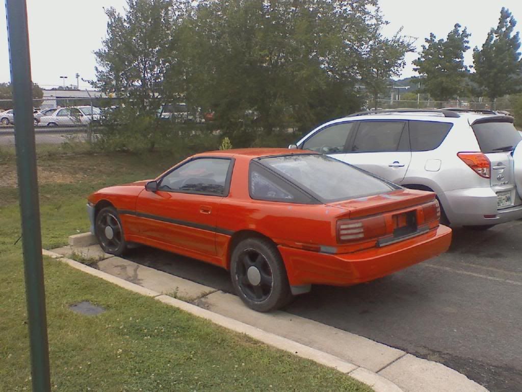

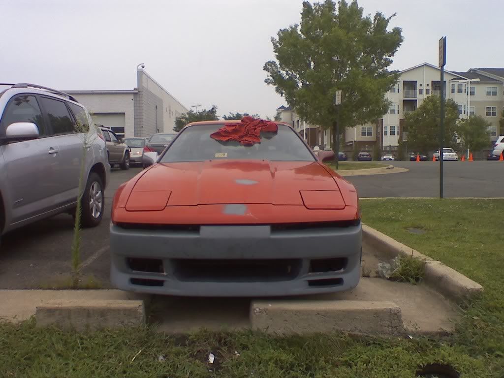

OK update so i bought a shell from slow sc and a bunch of other shit and he cam and helped mep ut it in so no more life story ima take pics and let you guys see how far ive gotten . thanks for the attention

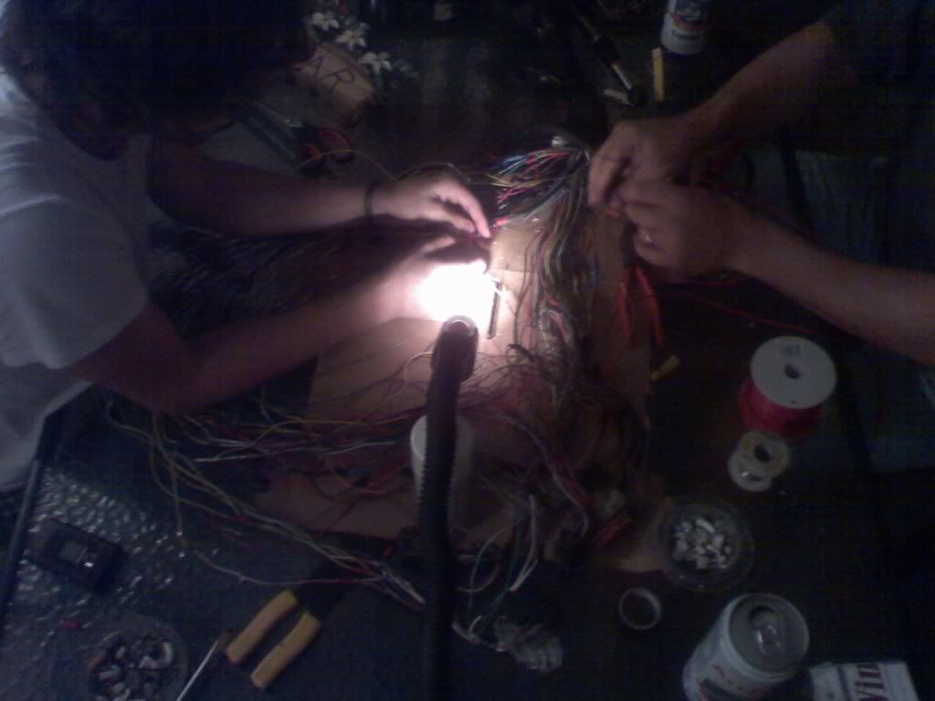

extending the harness = hell
Bought shell from slow sc the new shell

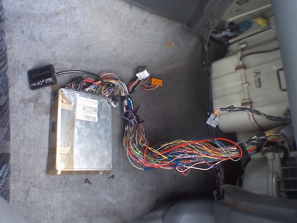

The harness in the car

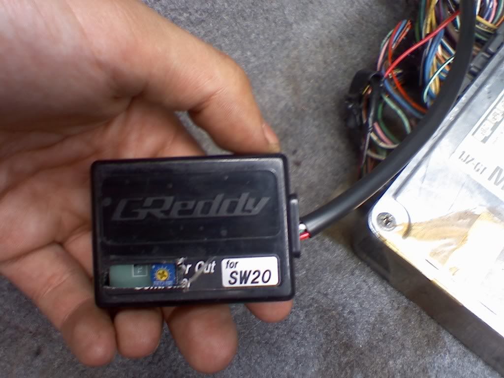

Greddy BCC wired in
