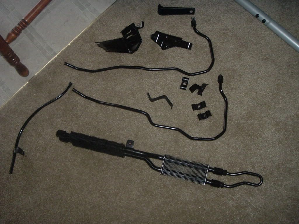

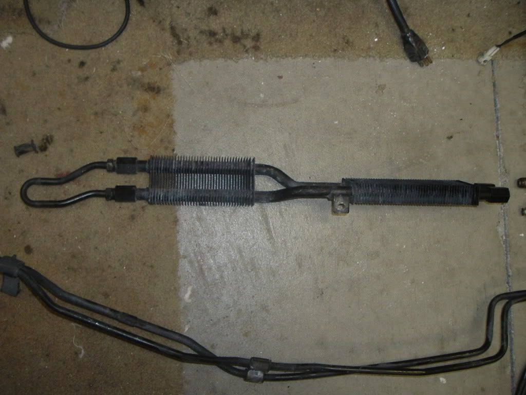

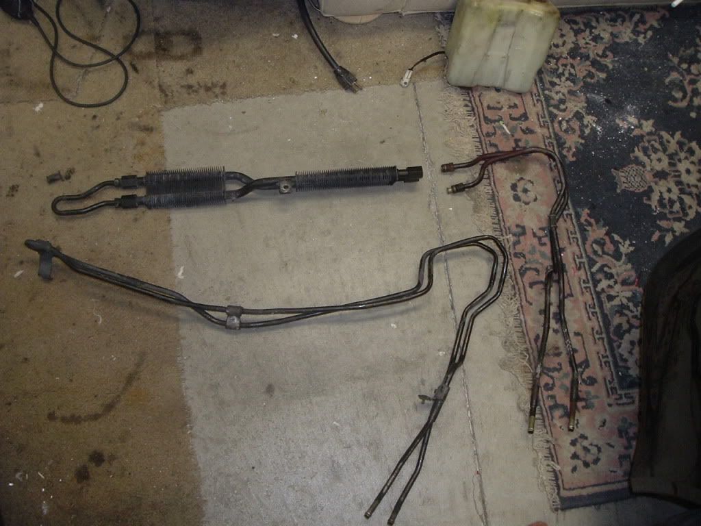

What year supra do you own? You might want to just upgrade to a 91-92 ps cooler. It is what I did, best part is it bolts right up, clean install and ez to upgrade (if you can find one)
A couple pics, Im sure you can figure out witch one is from the 91 sup ;)

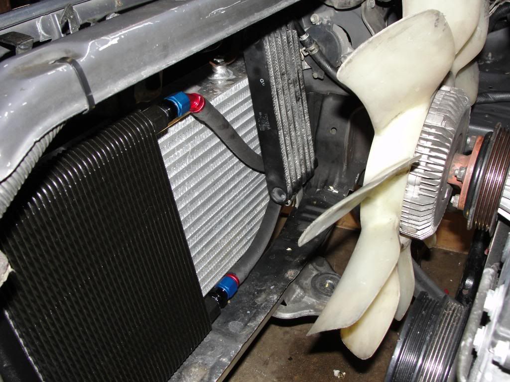

Here's how I mounted my coolers- Full-flow oil cooler on DS, stock oil cooler (as a power steering cooler on the PS)
Note: I have no A/C, so that may make a difference for sme people!
