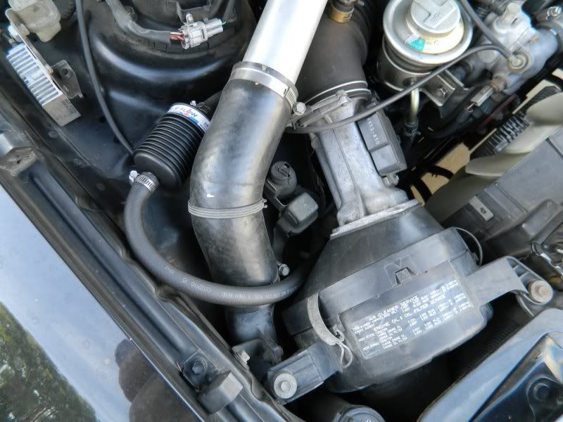

theres a dirt screen in the resovoier tank. over the years dirt plugs that and as such it cant suck the fluid out fast enough. use some q tips and very carefully scrap the screen. dont push to hard or you will rip it.
i had same issue, and i ended up stabing it with a screwdriver to get it to work. now i use a GE style tank and works awesome.

^ jet jock what filter do you recommend? I am moving my ps resoviour and if i can add a filter i would love to.
jetjock
creepy-ass cracka
Jul 11, 2005
9,439
^ This. I used the Magnefine under the AFM but a small remote mounted spin-on can also be used even if it's not a true hydraulic filter. One place for it is up front in the return line. A engine oil filter will do although I prefer to use a Trasko in such applications. Anything is better than the stock suction screen.
All this goes double for automatic transmissions. I normally stick with a Trasko on them due to its combination of high flow and depth filtration. The downside with Trasko is having to buy their element rolls but in hydraulic applications they last a long time.
Edit: Although any filter should be installed with the flow correct take extra care on a Magnefine because it will not reverse flow.

Agreed, if I had known I would have put one on long ago. I still need to look at redoing my install. I found it hard to fit under the AFM, but I don't like the current installed position I have at all.
I wish there was some sort of mount for the magnefine to stop it flopping around.

As they say, crude but effective. I see why it was hard to fit though. My 87 had nothing under the AFM except a small harness that had to be slightly moved. I'm guessing that relay is for the cds fans since mine was where your filter is. Leave it to Toyota to move stuff around.
For the flopping you could put an Adel clamp on there. Either one on each hose or a single big one around the filter. Not a fan of cable ties for that sort of thing. Seen them saw through too many things on aircraft.

Its crude all right. I planned to redo it a long time ago but I need a molded U shaped hose to make it work, and never found the time to source one. Without those relays ( I have the A/C pusher fan) it would be a lot easier.
