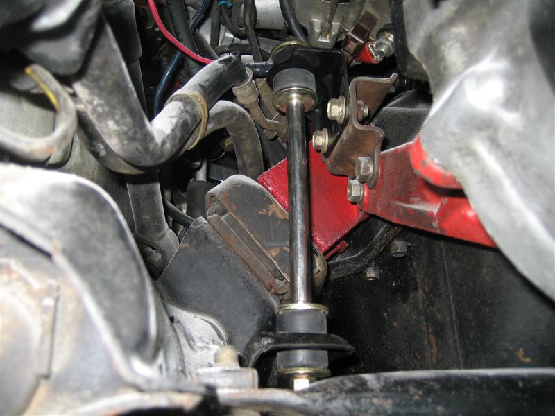

adampecush;1563267 said:
I was under the impression that they would prevent movement more so than the OEM mounts...this is not the case?
I'm now considering an OEM motor, poly transmission mount combo...
I highly recommend using OEM motor mounts, and a BIC poly damper/rod to limit engine movement. I run this combo on my car, and I enjoy the smoothness of stock mounts with very little movement at 450hp (my trans mount is also OEM). The BIC dampers are available for both 87-88 and 89+ now. Below is a pic of the one on my car. Also, here's a dyno vid of my car making 515hp 503tq with very little engine movement: http://www.youtube.com/watch?v=LnR-JyH7f-0
