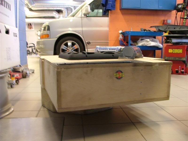

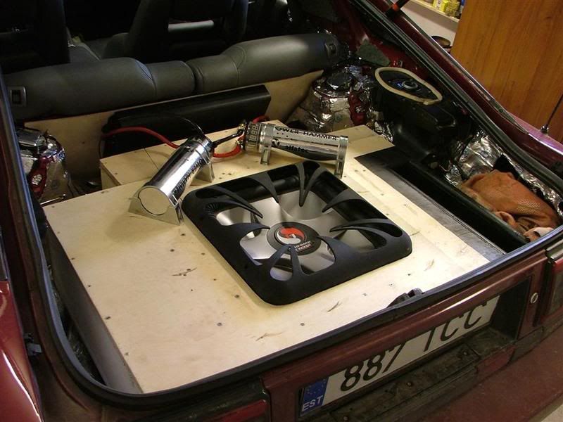

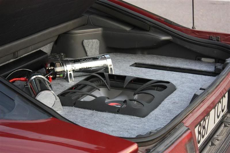

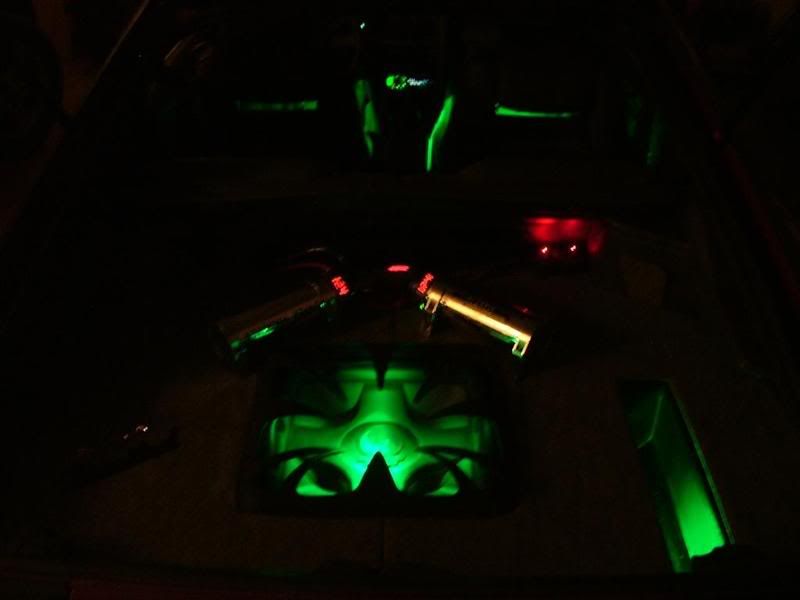

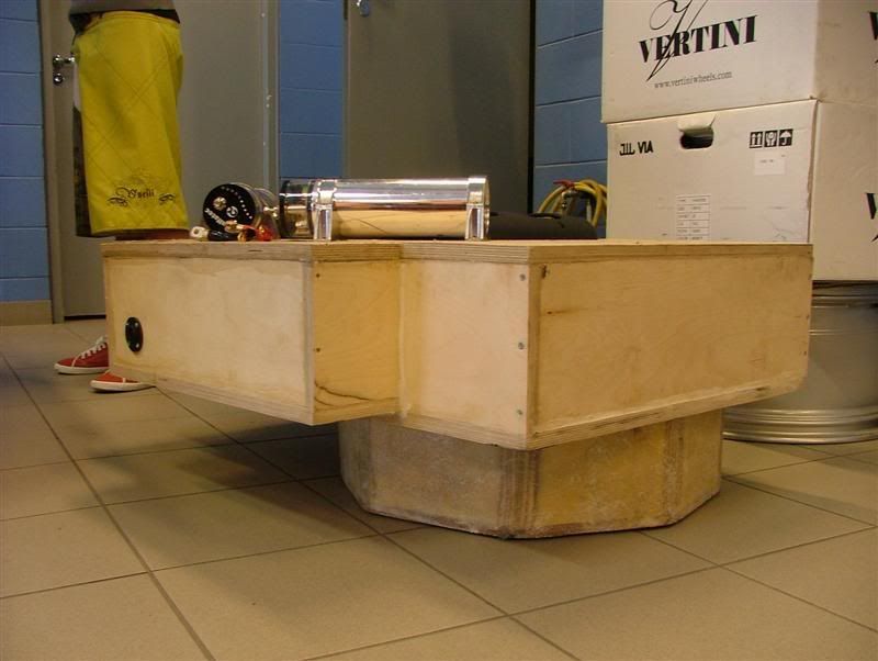

:D I wanted it to be lower, so I could fit the targa. But we didn't keep the capacitors in mind....So I have to think out another way to put it in there...

15l7.
Yes I'm going to fit the targa someway...but not the stock way ofcourse :D (If I don't lose the capacitors...to somewhere other place,
the targa holders would mount up half easily with little modifications to the box).

Kicker KX (?) 1200.1 mono d-class amp.
The sub's 2000w max, dual 4 ohm voice coil wired @ 2 ohms (though as I understand the amp wants to have 1 ohm.... but that's what I got in the set when visiting the US :)(Thanks to user toyo4life), so should be alright?).
The box (120 litres+port IIRC) and the port were done like suggested in the manual, but isn't precise ofcourse (that's the problem...), but according to bass tests, should be configured to around 45hz....that's maybe a bit too high.
