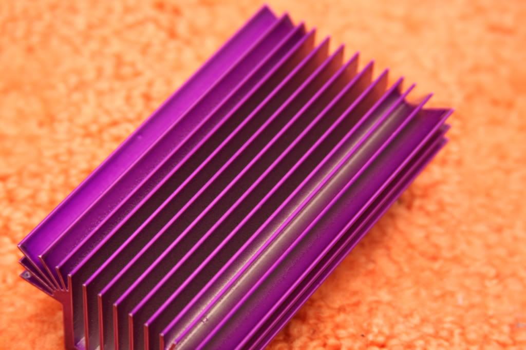

Here's a few of a random heat sink i found that i coated with a hyper purple color im going to be using on some small parts... I coated it just to see the color, so dont mind the uneven and fisheyed finish...lol

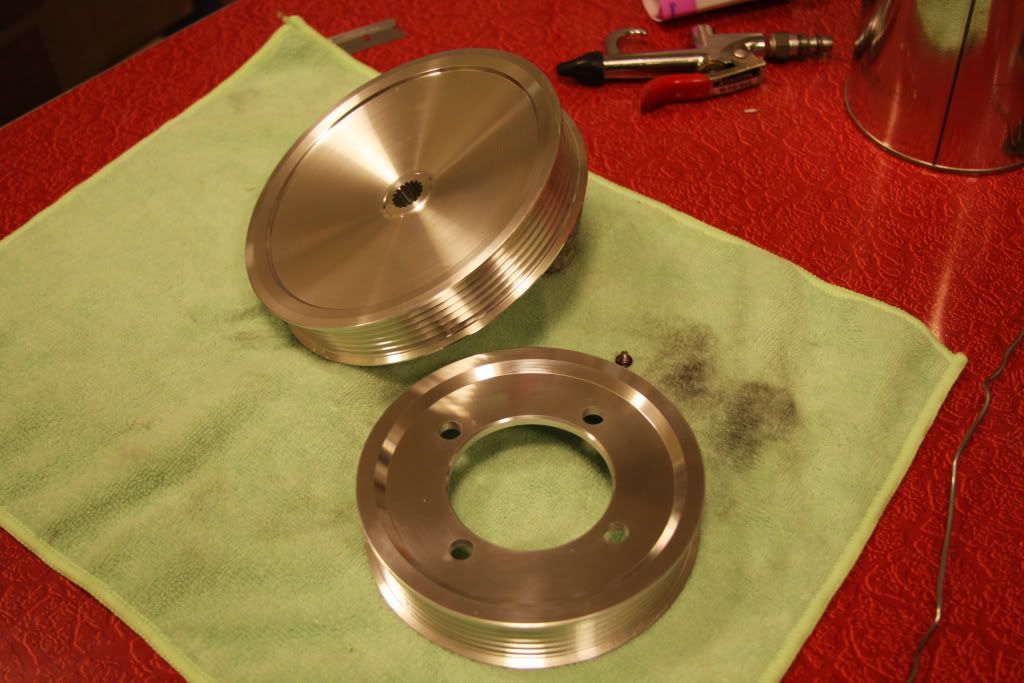

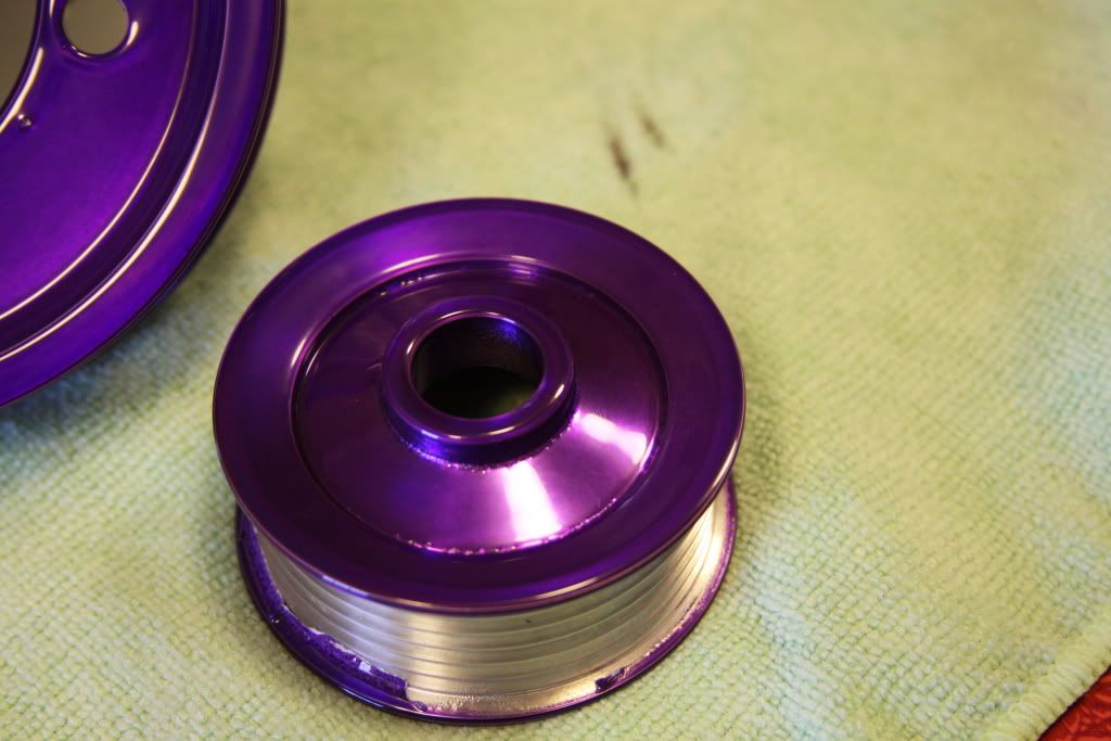

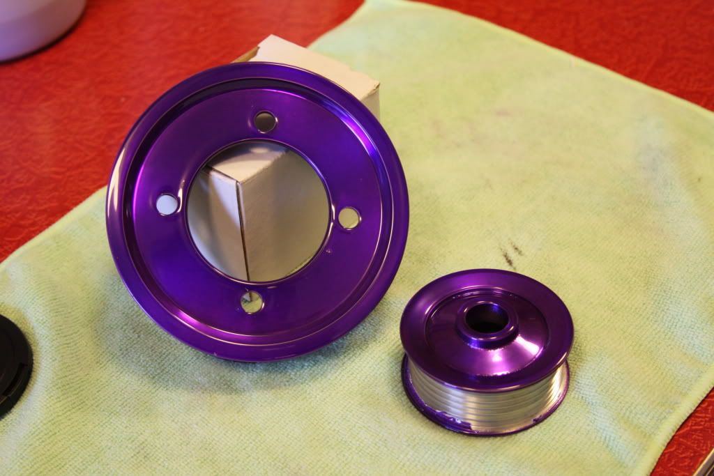

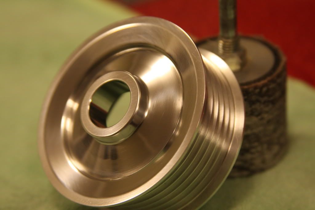

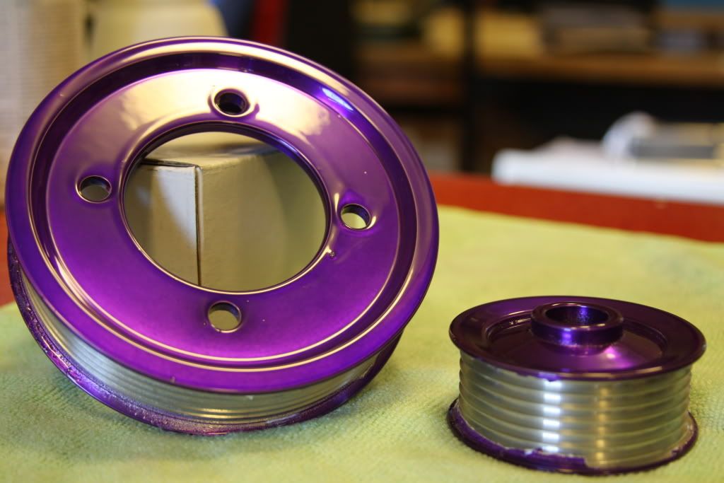

Well, i finally got around to coating the aluminum pullys for the 1j, and here they are. I think the purple i have is a bit darker than the particular shade HKS uses, but hey, i think this purple looks damn fine!
There is a few small bubbles in the paint that i think is caused from dirty air from my air compressor. I still need to buy a water separator and hook up an air filter as well.
Here's a few pics for now.
BEFORE:

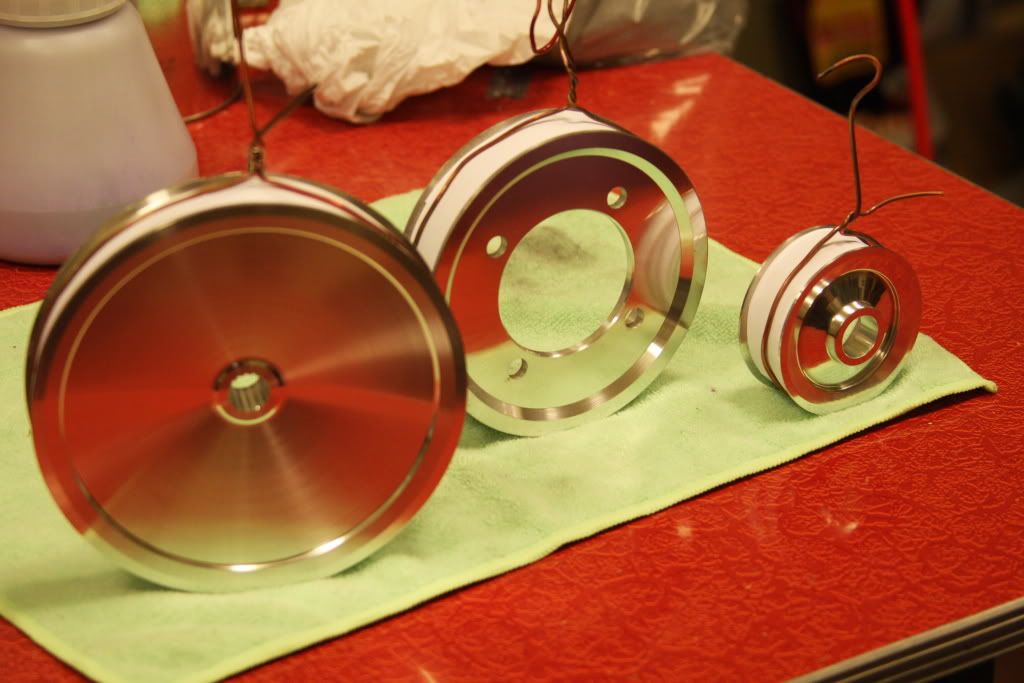

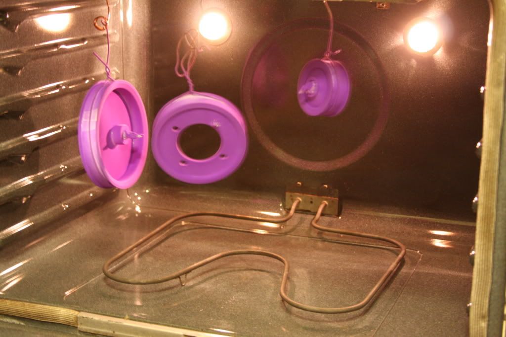

In the oven before baking:
After baking and w/ clear applied:

do you have any idea how that purple match the hks stuff,look's like it is very similar.eastwood has a metalic purple which is a single stage,but look's a little to dark.they also have a translucent violet which lighten's up when done over reflective chrome.i was going to try that one first.

You need an electric oven anyways... Gas ovens can burst in flames from the fumes from the part when baking.
Its very close. Thats what i bought the color for, and i have to do some playing around with it to find the right formula to match the HKS purple as best as possible. I will be posting more pics as i coat more stuff.
