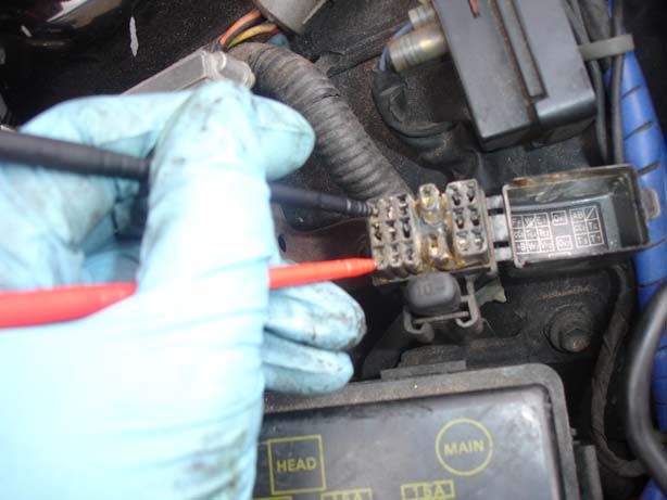

It's right next to the fuse box. I borrowed this picture from JSeaman's guide:
Shorting those two will power up the fuel pump (with the ignition on) without the engine running.
