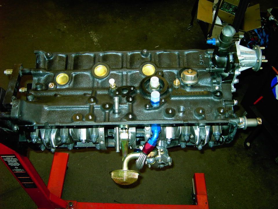

Adjuster
Here is what I did with mine.
Old system uses just a bypass for the cooler.
This one bypasses the entire spin on filter location, exits the block at the NA block off plate location, goes to a Canton full flow filter, RX7 oil cooler, and then back into the engine via the BSP 20/AN10 fitting in the filter location. (See the center of the round raised lip where the turbo filter mount goes, or NA filters spin into place.)
So far, works great.
I have the Canton filter mounted up on the right apron where it's easy to change. (Don't even have to raise up the car, or anything more than pop the hood.)
