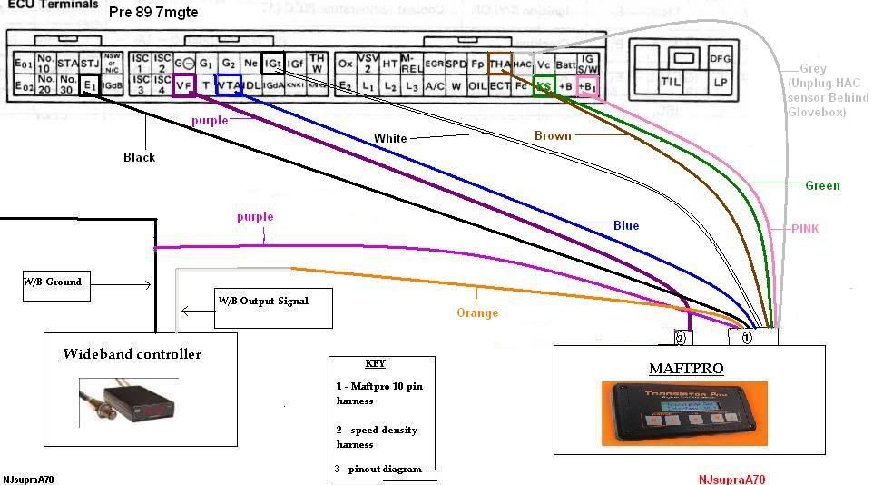

Its been quite a while since I have had this harness in the car and Im hoping that I can get some Direction on that I can do to fix this problem. I start the car up in the morning and using my MAFT Pro I know that Im not suppose to get a VF signal for atleast 30-45 Seconds and during that time period my VF should read 0.00.
Problem that Im having is that im not getting a VF signal until about 15-20 minutes if not longer. I have pulled the Harness out and replaced the Gray wire that the signal runs through but Im still getting the same Issue. Changed out ECUs and no help. I cant drive the car or anything during this time.
After 20 minutes of Idle without a VF signal I can turn the car off, then back on and Instantly the VF signal Picks up and my A/F ratios steady out. What can I do or what should I be looking for to get this resolved. This is the only problem that I have with this harness. I dont want to pull it and hunt down another harness if this can be fixed.

Ok. I went out to the Area that I have the car stored so I can take some Pics to show you a little better about what Im working with. These MAFT Pro Monitor shots will Explain a little better what Im having Issues with. Keep in Mind that with Pictures 1 and 2 my A/F ratio is a _ _ _ on my wideband which is signs for its reading higher than 18.0.
Pic 1, Time taken was at 1:23pm with car running about 2 minutes so far.
Pic 2, Time taken was 2:00pm. Car as been Idling for about 35 minutes now.
Pic 3, Time taken was 2:01pm. I shut the car off, waited for the MAFT Pro to power off and then started the car right back up. A/F at this time went up to 14.5 and help pretty steady.
Hope this gives you a little better understanding of what Im dealing with here. I dont understand it anymore than you and I agree what does the shutdown and startup have to do with this starting to read properly.
