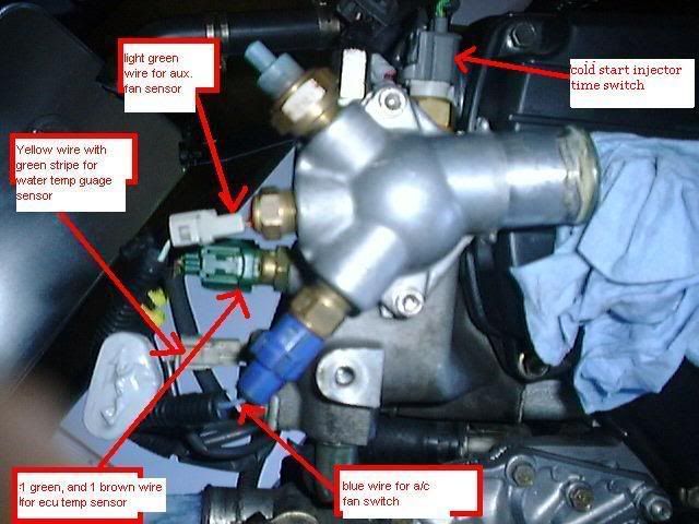

BTW, i have seen some differences when it comes to the Water outlet housing...some have 2 sensors others have 3! On mine right now i have 3 plugs on the housing...but then again i really cant trust the way my engine harness was setup due to the previous owner.

Yours Teal ;)
Edit: Here is the famous Water neck pic. This is how it should be set up to be correct.

So, im kind of confused, which years actually had that infamous outlet setup. Sorry guys i just wanna make sure the new harness i buy wont be spliced a hundred times to make it work.
