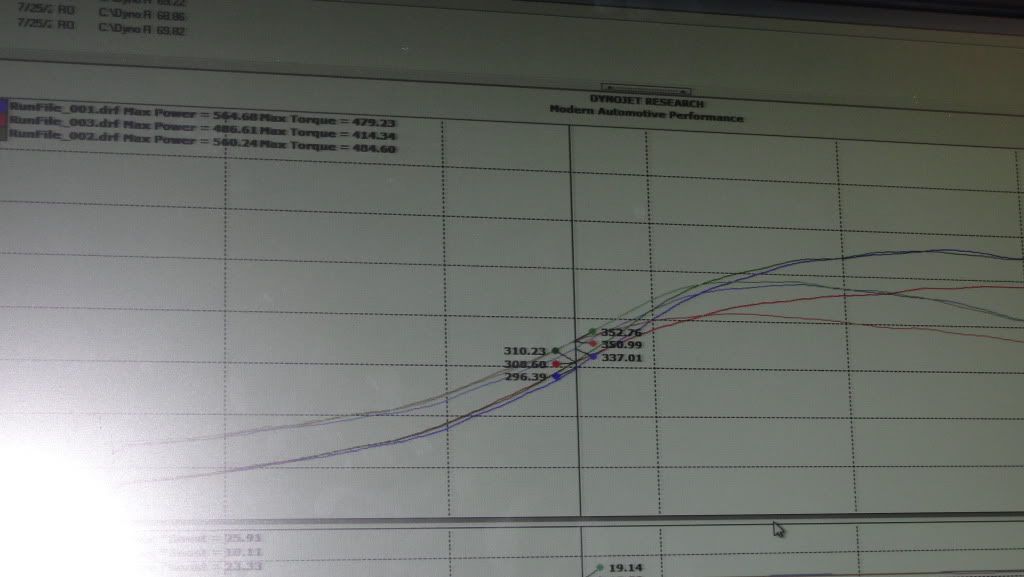

toyotanos
What will we break today?
Super Moderator
Nov 29, 2008
2,841
Coon Rapids, MN
Best pic I have atm, vertical line is at ~4600rpm. I'll see if I can get a good copy of the whole thing.
