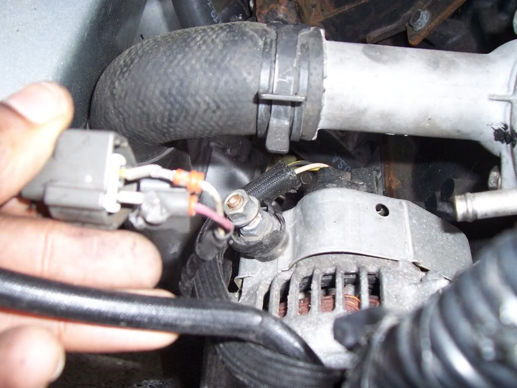

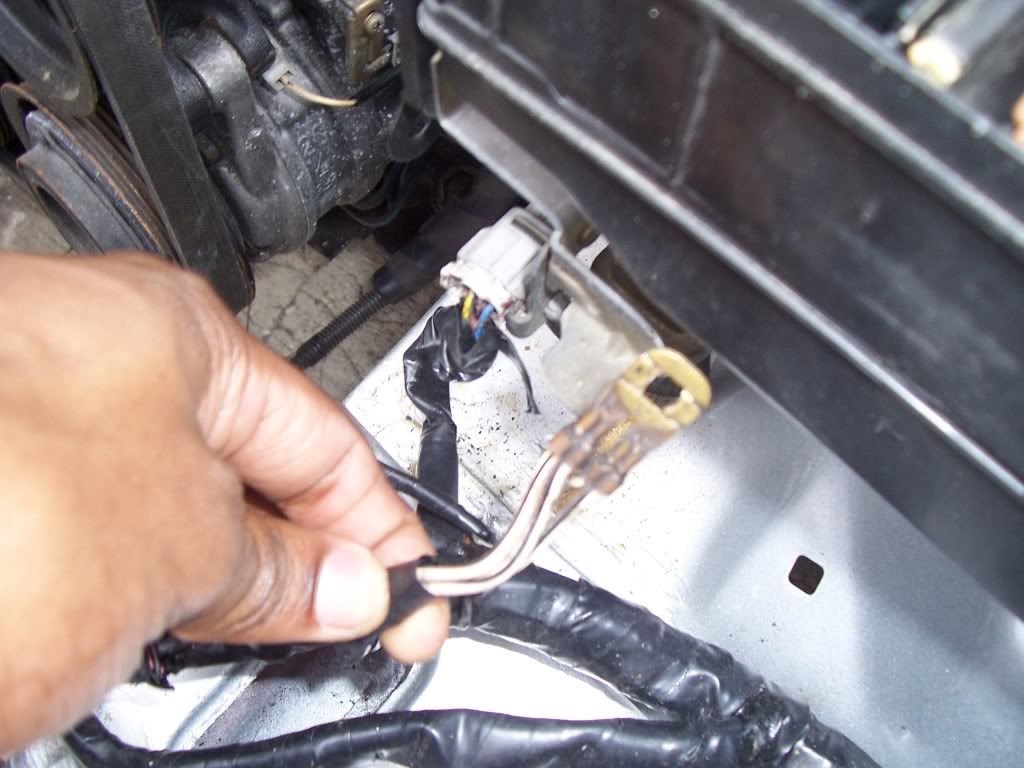

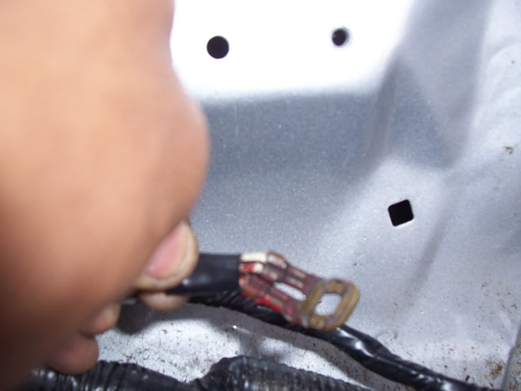

1. Does the 7m charging harness remain functional?
These are 7m charging harnesscolors white, yellow green, black yellow and black.

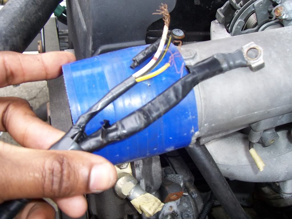

Now over to the 1jz alternator, there are two plugs which would make it appear that the surplus of wires for the original 7m aren't all needed just the big black wire going to the fuse box?
So far in the engine bay I see these white wires bundles to one lug terminal are they grounds?

The 7M harness charging system stays in tact. You will have to buy 5 foot or so off 2 gauge wires and run it from the alternator back to where the stock one you're holding is. Also the plug in the back of the alternator has 3 wires. Those come out at the HUGE square plug next to the fuse box on the jza70 harness find the wires, and then connect them to the 7M's alternator ( 3 wire plug ) your first pic that big wire is what you are going to want to connect a 2 gauge wire from the alternator on the 1jz run it under the core support. Also in the first pic those 3 wires are your alternator wires. If you want I can talk to you on the phone and explain everything.
Just PM me if you want to do that.
