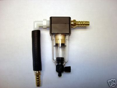

What do you guys think of this one? It is designed for mustangs, cobra's and such, so capacity wise I think it would be suitable for us. The seller claims to have sold them for over 5 years and they are used on supercharged and nitrous cars. It costs only $32.
I like the functionality of it, the way the gasses are routed to me looks like it would get out more oil from the gasses than the empty aluminium round and square greddy-like tanks. I would ditch the white plastic bend on the left and use the same brass connection as on the right though.
It is similar to the oil seperators which are used in compressed air systems, the oil seperators on these systems take out about 97% of the oil, but these are made of glass and thus not very suitable for automotive use.
OK, a polished greddy-like tank looks cooler, but for me functionality comes before looks, and I would also mount it low in front of the radiator, so you'd only see it from the top.
What do you think?

looks like this unit can have some pressure drop.. i thought having any appreciable pressure drop in pcv line is not a good thing..

@Blade2001, it's not an engine intake, as long as you create some vacuum it works fine, the trick is to eliminate as much oil from the gasses as possible. Too much vacuum on the pcv is also not good, I've seen some sucking up raw oil.

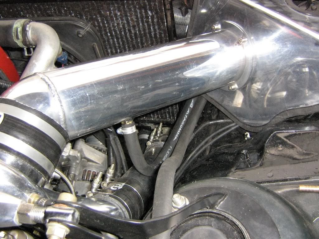

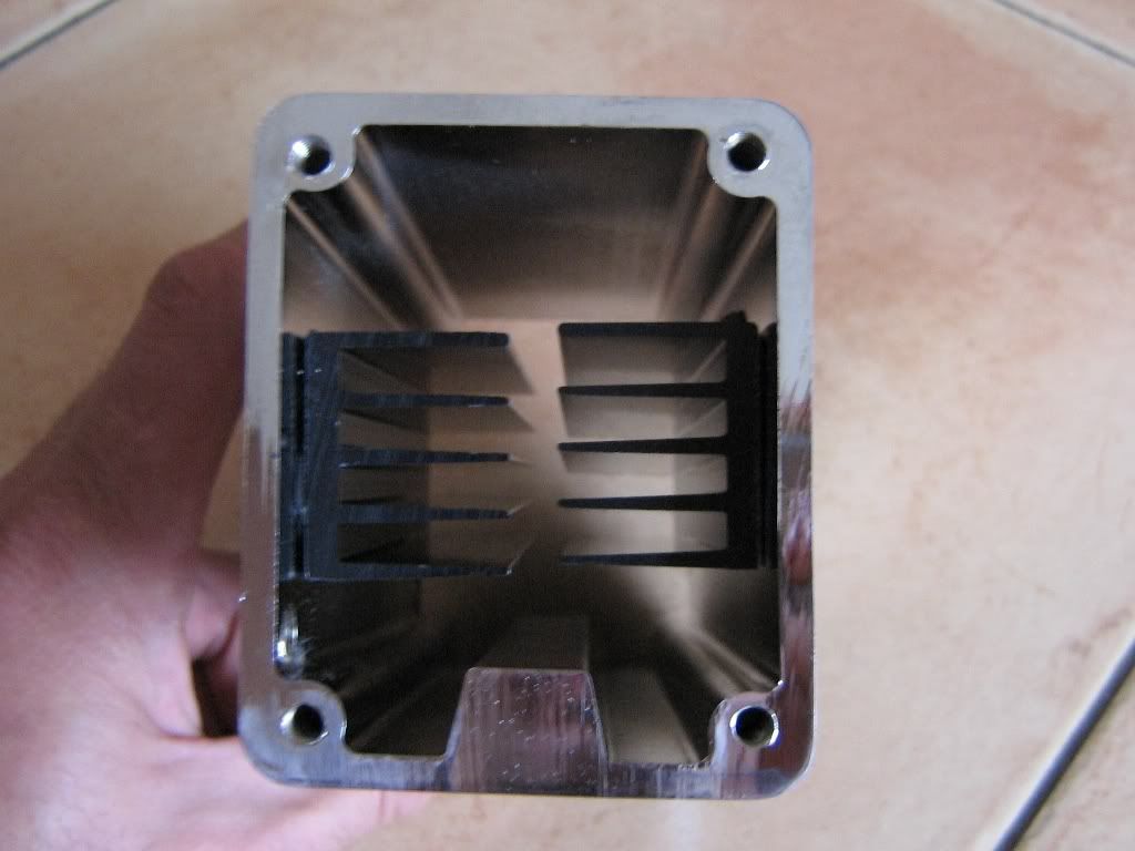

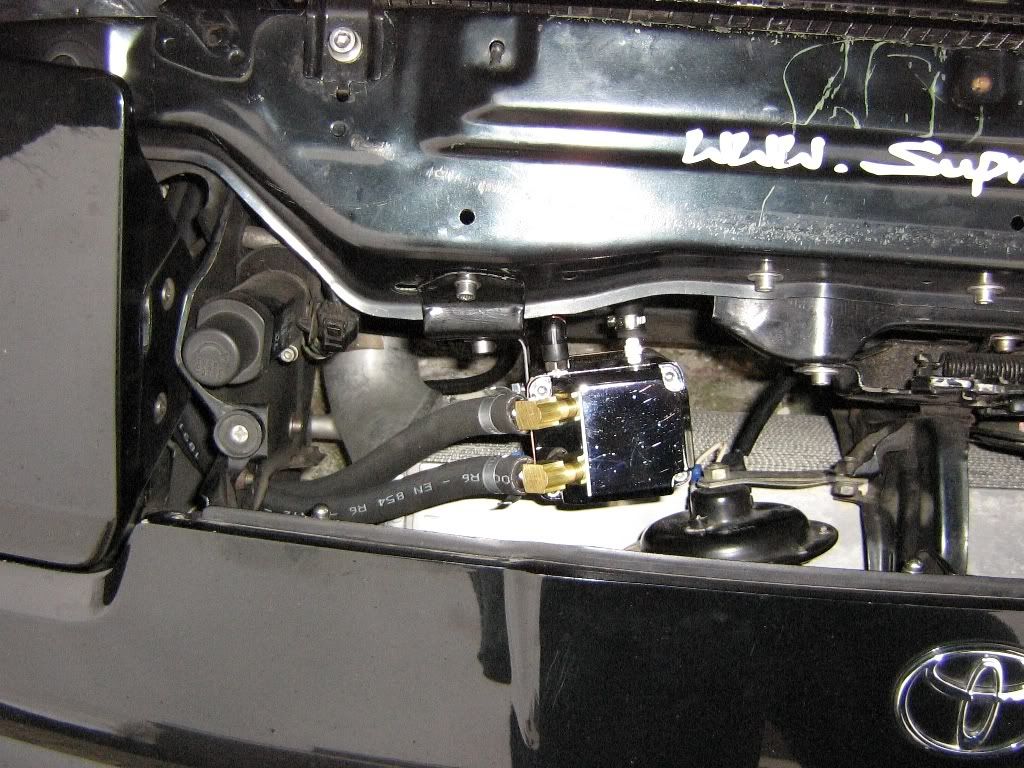

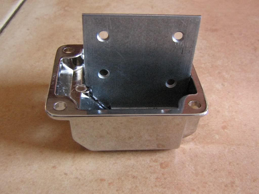

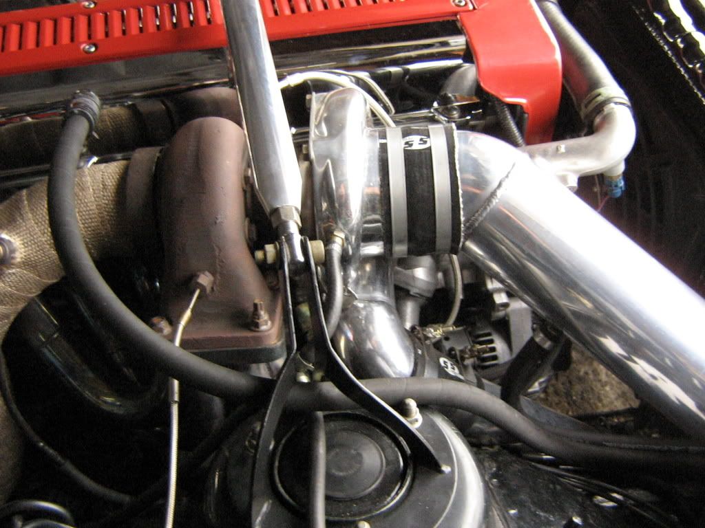

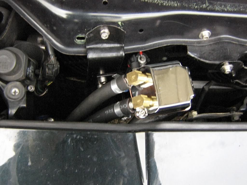

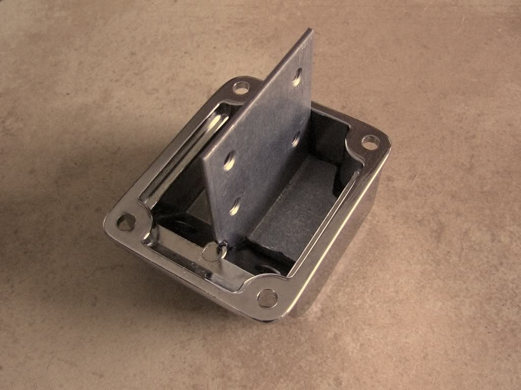

I got the ebay-greddy-copy style and added some heat sink from a PC shop in them. I added a seperation plate in the head as well to force the air to go by the heat sink. Here's some pics.
heat sink glued in with a FIPG like glue
seperation plate glued in the head
set-up mounted in a cool place for better oil condensation
here you can see the routing of the hoses
connected to the intake
and hooked up to the valvecover
