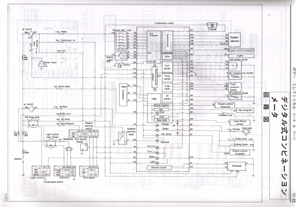

But this is where I'm stuck at now because... it's a digital dash.

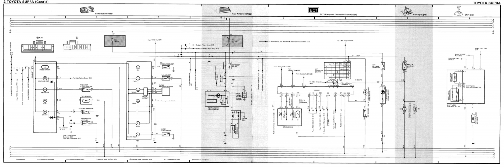

The digital cluster circuit doesn't give me much reference to ground points make it difficult where to look at.
Closet thing to engine ground on analogue diagram is the water temp sensor. I'll have alook around there... eventually I'll find it when I get the chance as it's mid-night and raining right now.
