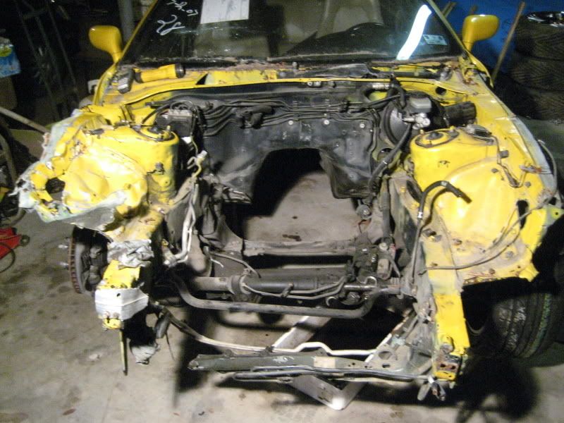

This is what the beauty looked like when we got it home

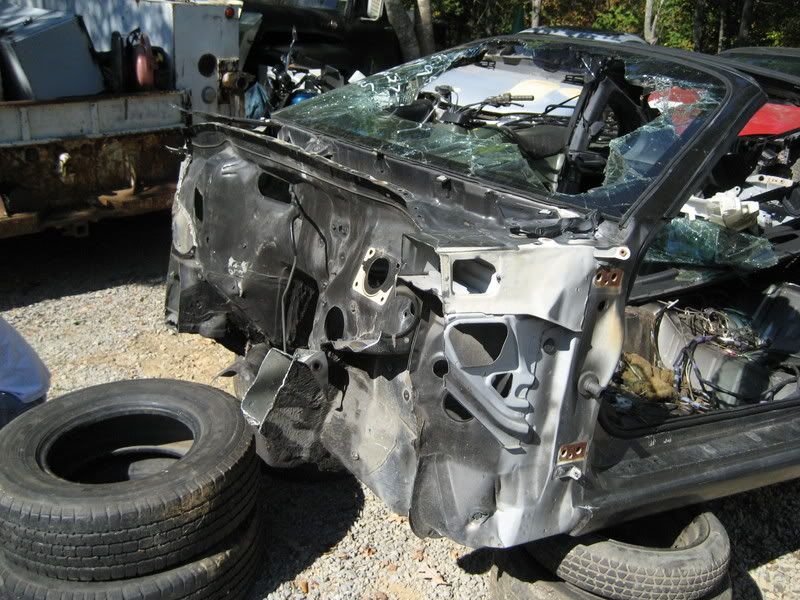

Everything on the front end is jacked, and some of the motor parts, but other than where the car spun around and hit something in the back, the car is nearly perfect. Me and my Dad checked all of the door lines, and stuff before we ever bought the car to make sure that none of them were pinched. And they weren't so this let us know that all of the damage was only done to the front as far as the frame goes.

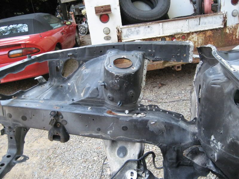

Well I spent a few months looking all around online trying to find a complete front clip that way I could just buy it with everything I needed instead of trying to find the pieces one by one. Well that didn't work out and the 2 or so that I found were nowhere close to me. So I had to find something else. And something else I found after searching and talking to some people they recommended that I call a man by the name of Jim. Some of ya'll may know him. Owns Turbo Toys in Tampa. Much closer to home for me, and this is what he had for me.

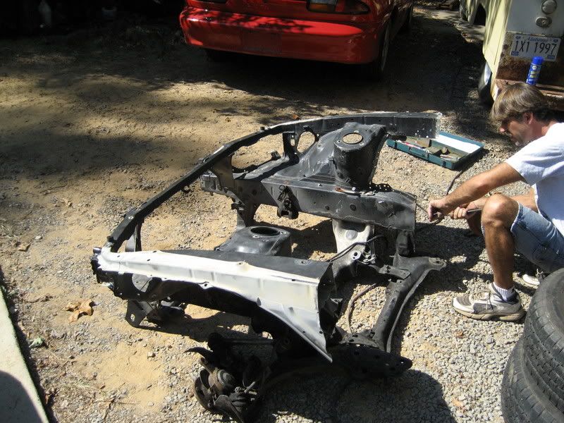

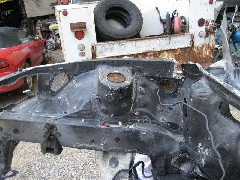

Completely bare, gutted, stripped everything shell but the front half was good and it was all that I needed:
Thanks Jim!
Me and my Dad got it home, and didn't waste a second hoping on it since I was only home for the weekend.

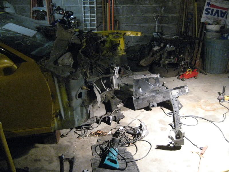

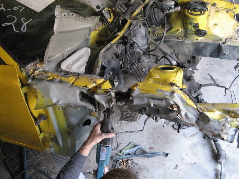

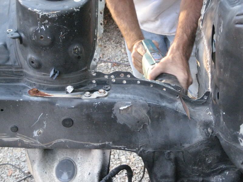

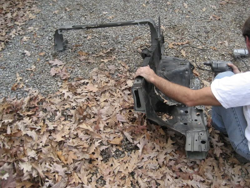

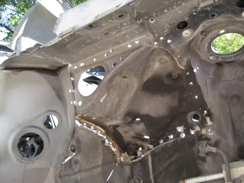

Starting the endless process of drilling spot-welds and removing piece by piece.
Now you see it!
Now you don't!
Sawzall powa!!!!

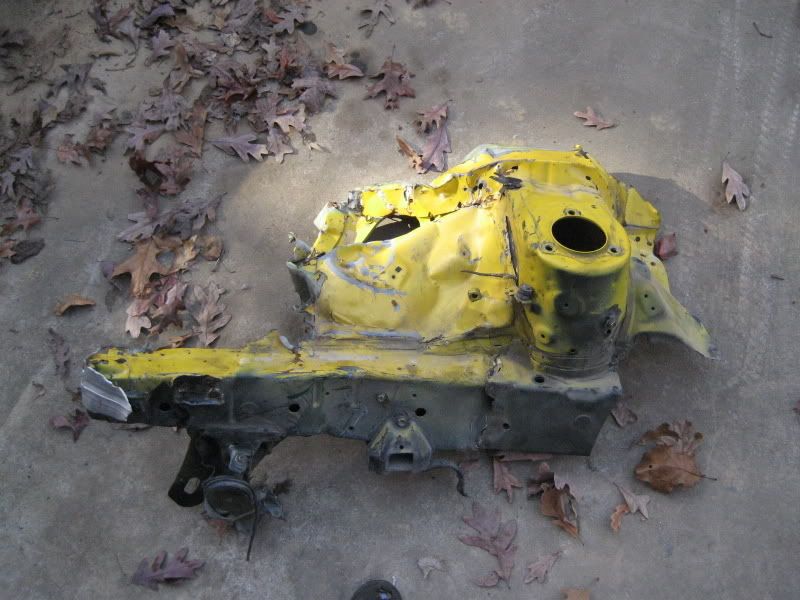

On this side we didn't need as much of the front so we just picked a spot and sawed on through.
And there she is!
Ouch!!!

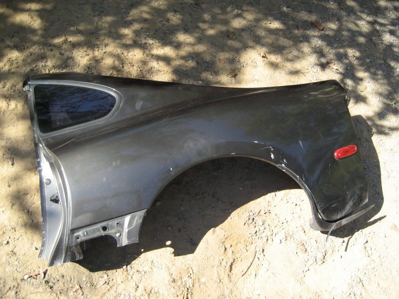

Also snagged the only other good part from the shell which I just so happen to need.

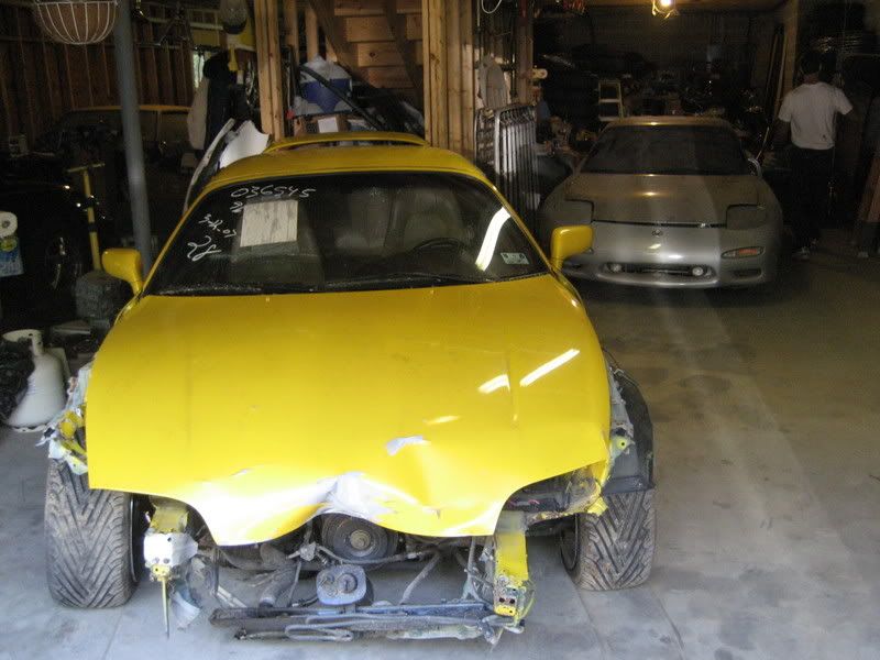

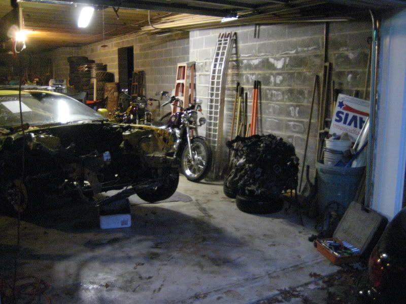

Pulled her into the basement for the winter so we could work more comfortably when it gets cold. My Dad's 94 tt FD behind mine. Pretty dirty

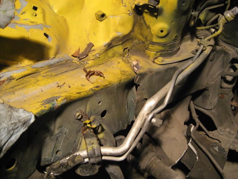

With the hood off, you get to see just how ugly that thing is. So I guess we call this a before shot.
Onto some carnage pics!! Bwahahaha

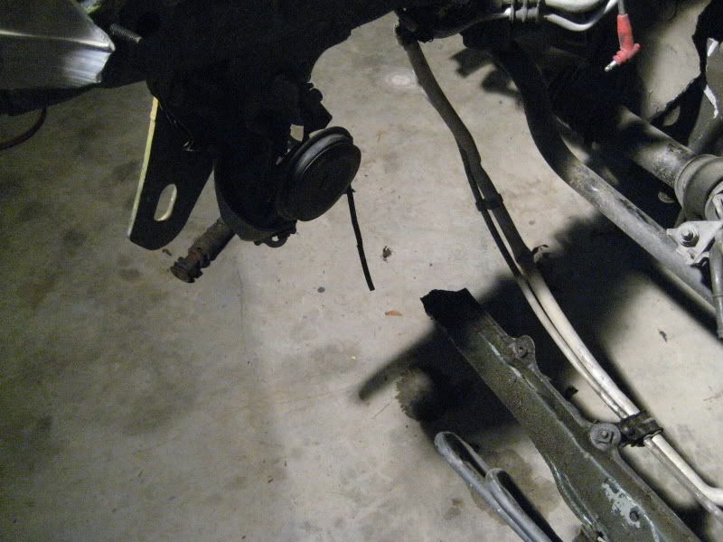

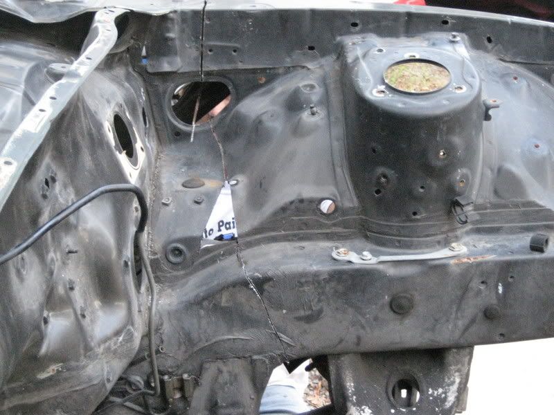

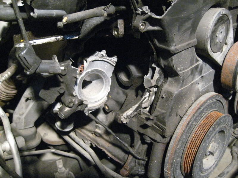

Waterpump and bracket snapped completely off! Block not hurt
Engine crossmember, snapped completely in half!!!

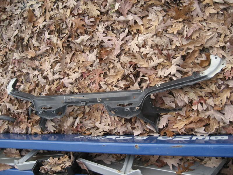

What's a radiator support?

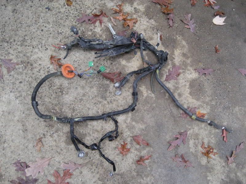

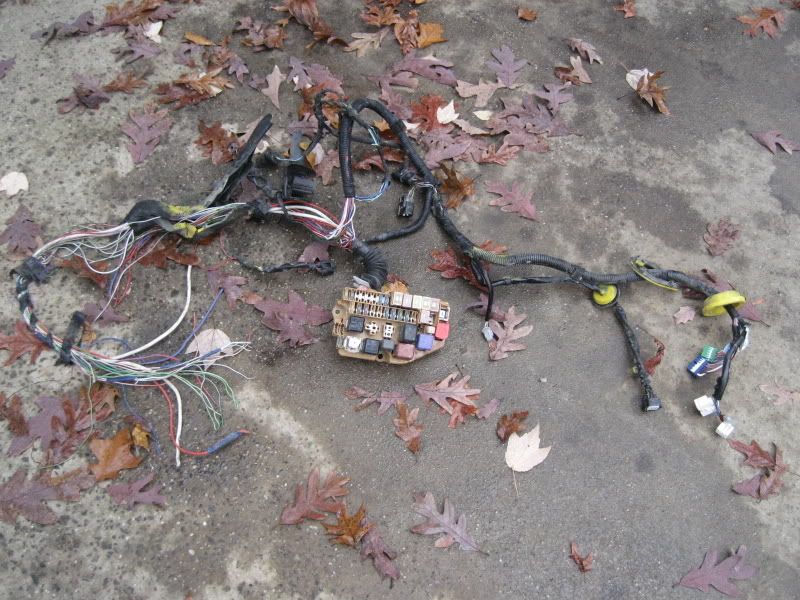

First shredded wiring harness.
Second shredded wiring harness.

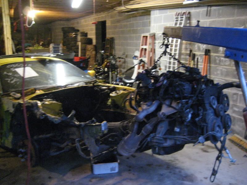

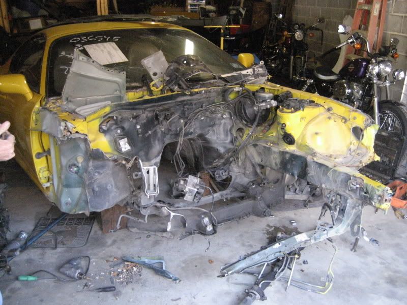

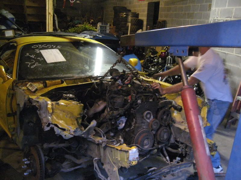

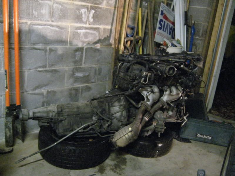

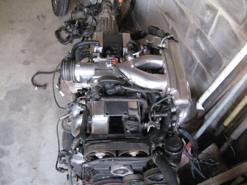

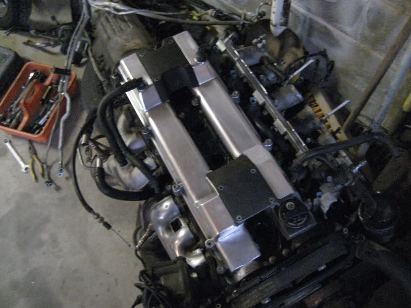

And here she come's! Seriously the easiest motor I have ever removed. Less than an hour and a half. Course it was easier to get out without the front core support. lol
And there we go.
A little better without everything in there

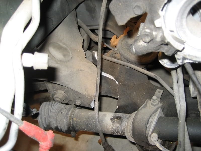

Frame where it got stretched so far outward that it broke in 2.

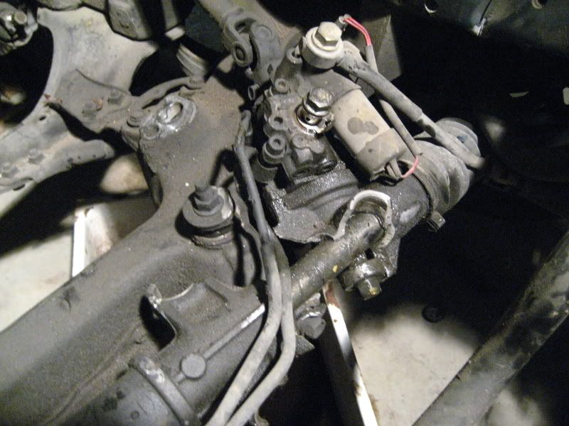

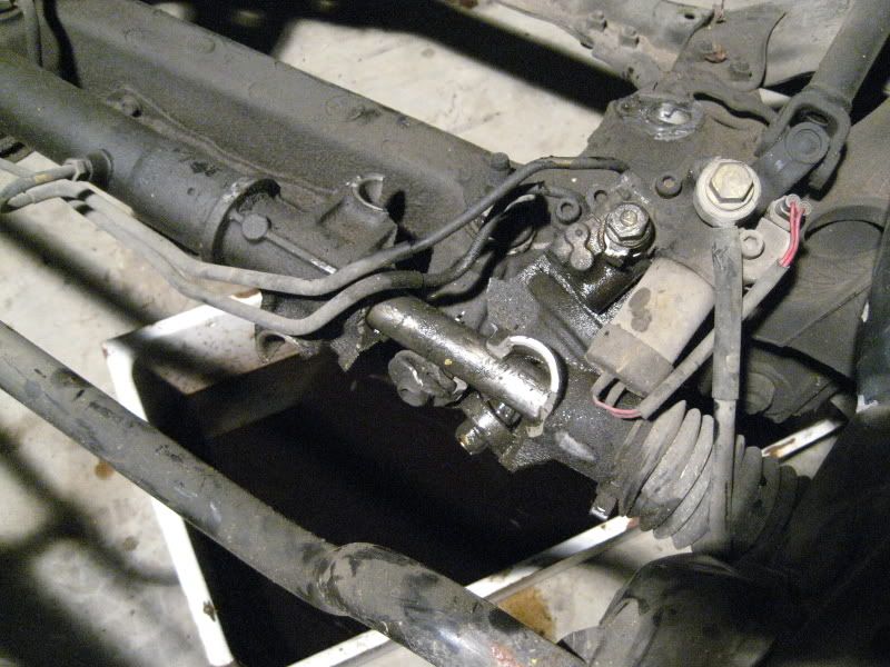

At least my steering rack is still good! hahahaha
And while my dad starts the spot weld drilling on the car, I will be cleaning/polishing/painting this bad boy up.

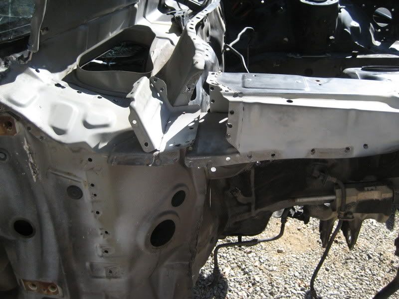

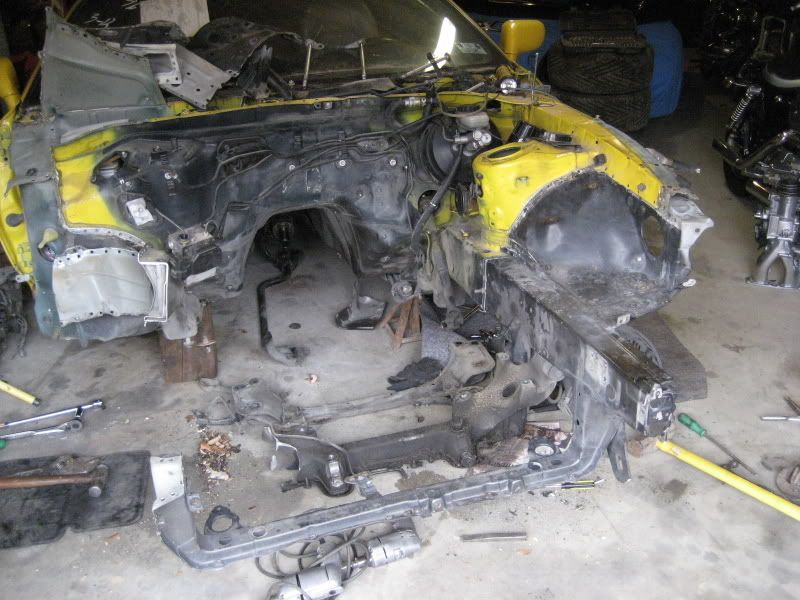

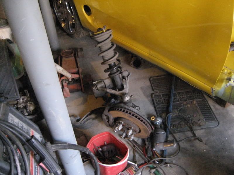

took the suspension completely off of the passenger side so we could better see what we were doing.

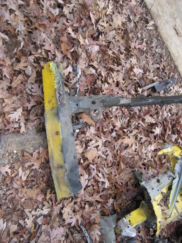

Then the cutting begins again. This isn't the final cut, it just got all the mess outta the way.
And here's the junk piece that we removed.
And here's what it looked like afterwards
Here we peeled the frame back so we could double re-inforce it from the inside when we put it back together that way we don't have to worry about anything.

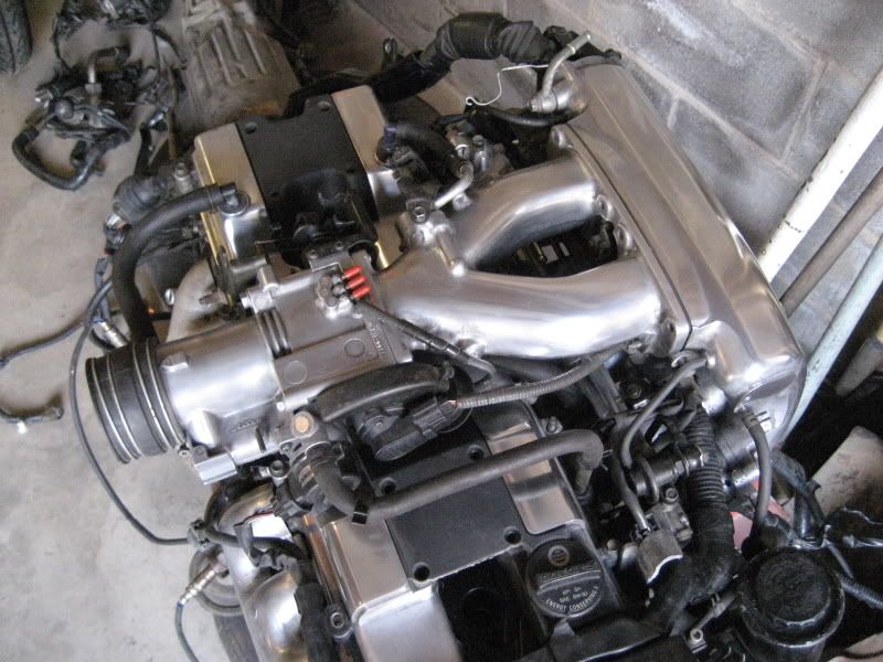

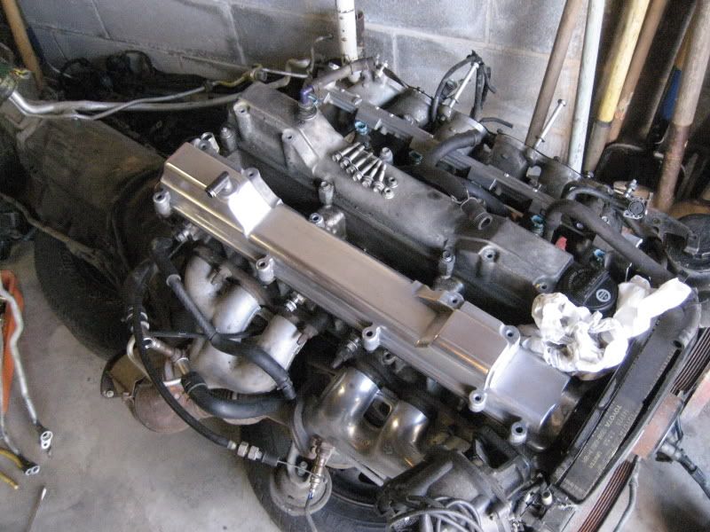

And I have been cleaning up the filthy engine. Here's what I got so far...

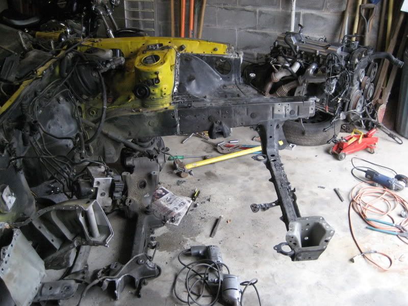

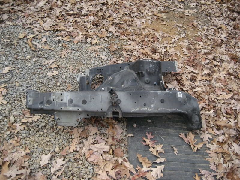

Starting taking the good front clip apart
Bad driver's side frame rail.
Almost there
And there we go. (this is where we needed our welder, so we just got it vice clamped to hold it up)

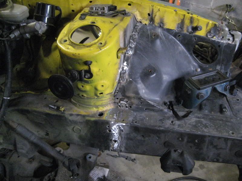

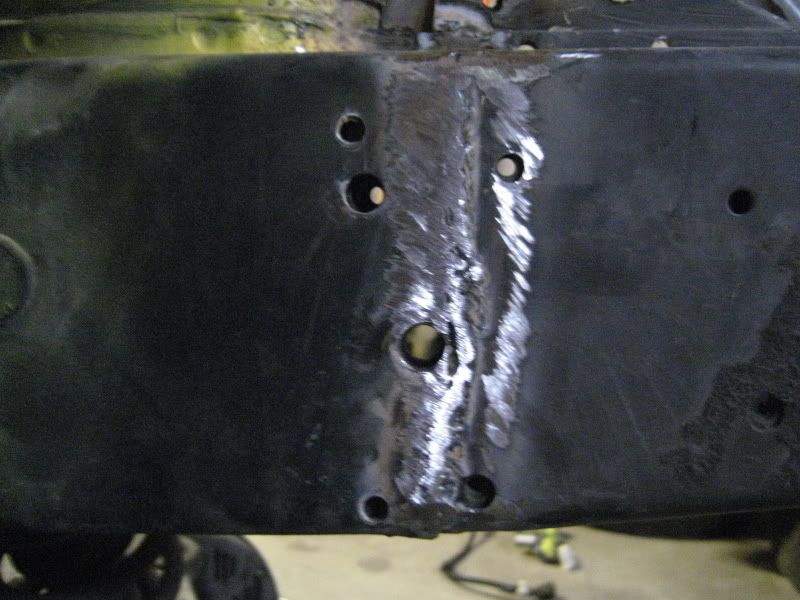

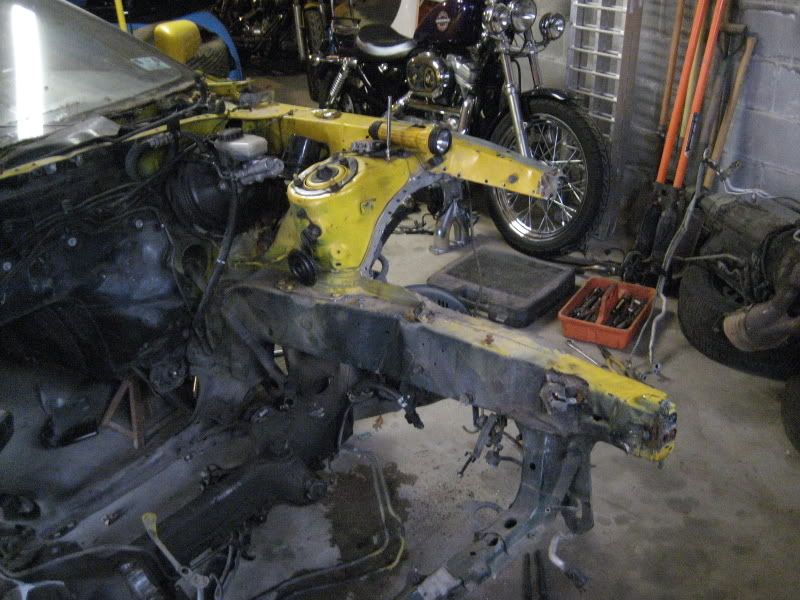

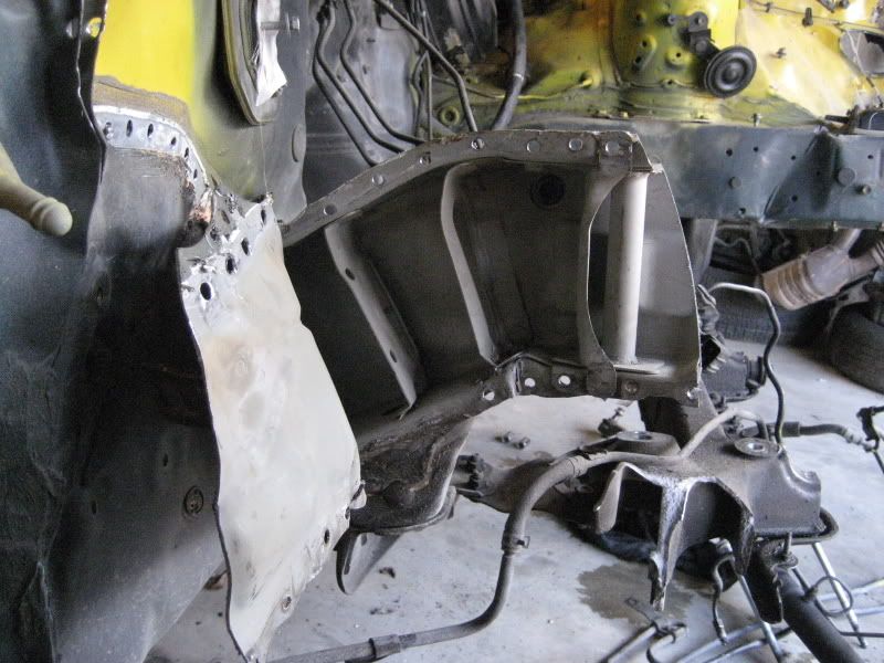

Welded up the driver's side.
Close up. We slid the new frame inside the old one. I would say the holes line up nicely!

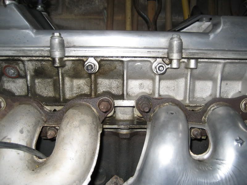

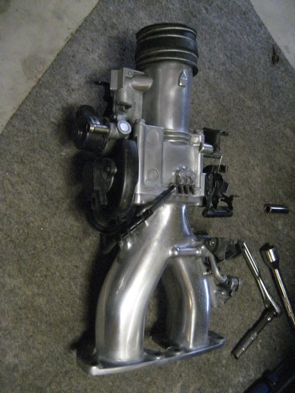

Amazing what a 99 cent can of degreaser and a tooth brush will do for a head. lol
Finally done with the S.O.B. Turned out ok.
