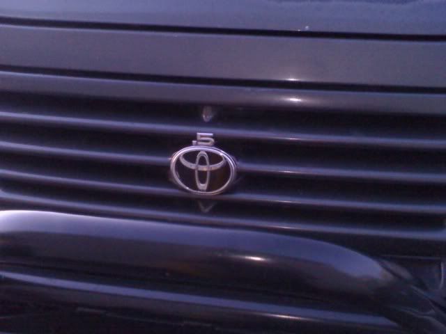

RazoE;1328321 said:
very nice, I like how your taillights mysteriously swap back and forth between styles..;)
also your little "T" fell off in the pics..:D
Good eye!!!
It says ".5 Toyota" because of the Toyota axles, plus Toyota is just cooler then Suzuki, we all know that. :biglaugh:
The Suzuki logo was missing when I got it, and I had that Toyota logo sitting around from a 1jz clip LOL
And the tail lights got changed when I found a sweet 95 Tracker at the pick-a-part! I got seats and a door panel, window regulators, and a bunch of other brand new looking items.
