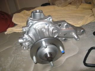

new 2j water pump

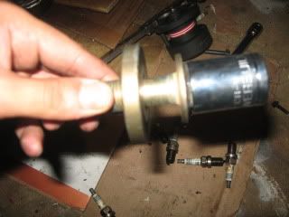

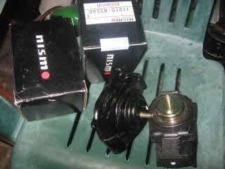

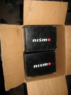

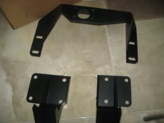

the mounts im using

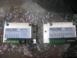

my dakota interfaces

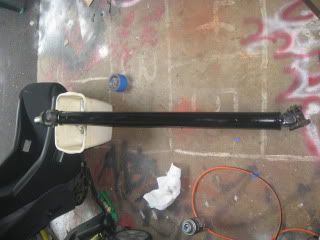

Driveshaft
I was gonna do Cusco solid mounts but decided to go with these

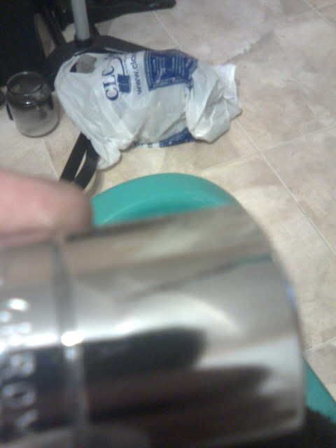

ok so i may just go for an impact gun to remove the crank pulley bolt lol here is the aftermath of what happend to my socket. i used a long ass breaker bar and a 1/2 drive ratchet. always thought the ratchet would break before a socket

JASONA70;1398688 said:
^^^^^^^^^^^^^^^^^^^ what kind of socket??? generic or the good ol American stuff?
its a good ol american brand :biglaugh:
its not craftsman but i think its pretty much equivalent to craftsman..i think lol my powerbuilt brand sockets has never failed me. this is the first. i cant believe my socket broke just from trying to get the crankbolt off

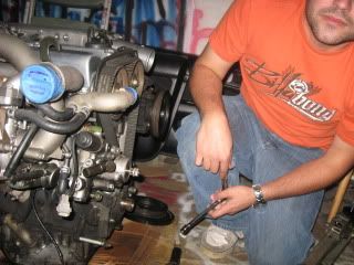

FINALLY GOT THIS DAM CRANK BOLT OFFF !!!!!!!!!!!! Thanks to help from JohnnyRedline and my neighbor whos a mechanic for mercedes lol

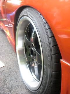

Heres just some updates on pics. These past 2 weeks ive dropped my car 2 inches and now im just waiting on my harness

hella flush...not really

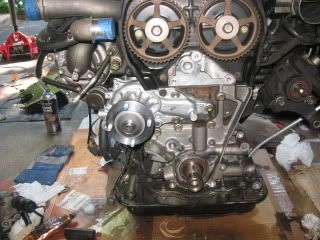

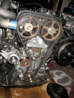

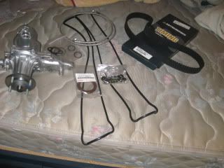

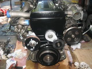

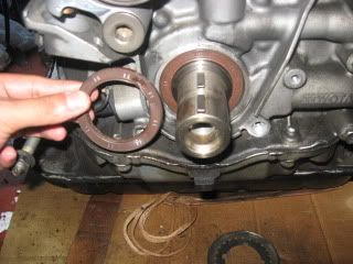

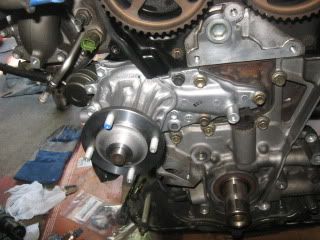

heres what i did yesterday morning. i replaced the front main seal and water pump. Yes i am taking my time since im still waiting on a couple things to come in the mail lol
Got the new front main seal in but i didnt really need to replace it since it wasnt leaking. The only thing that was leaking from my knowledge was the valve covers. Which was replaced after i polished them.
still need to do timing belt but just wanted to take a pic of a clean motor =D
