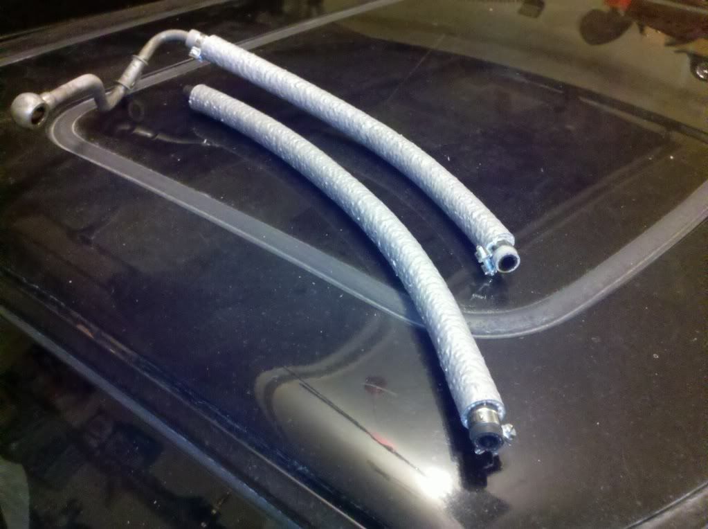

Latest pic: All of the accessories on. I had to replace a coolant hardpipe, because after welding up the rust holes, it still leaked from microscopic pinholes.
I bought a used hardpipe off a guy on the MR2 forums for cheap, and now I'm just waiting to powdercoat the valves covers a wrinkle blue finish at my friend's house. Then I mate the engine and tranny together for the install.

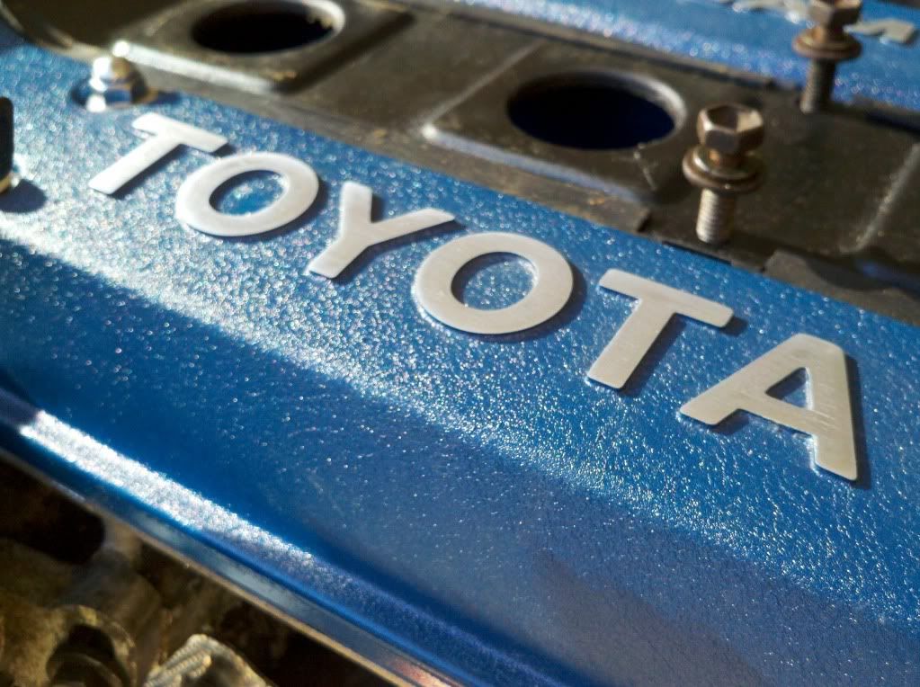

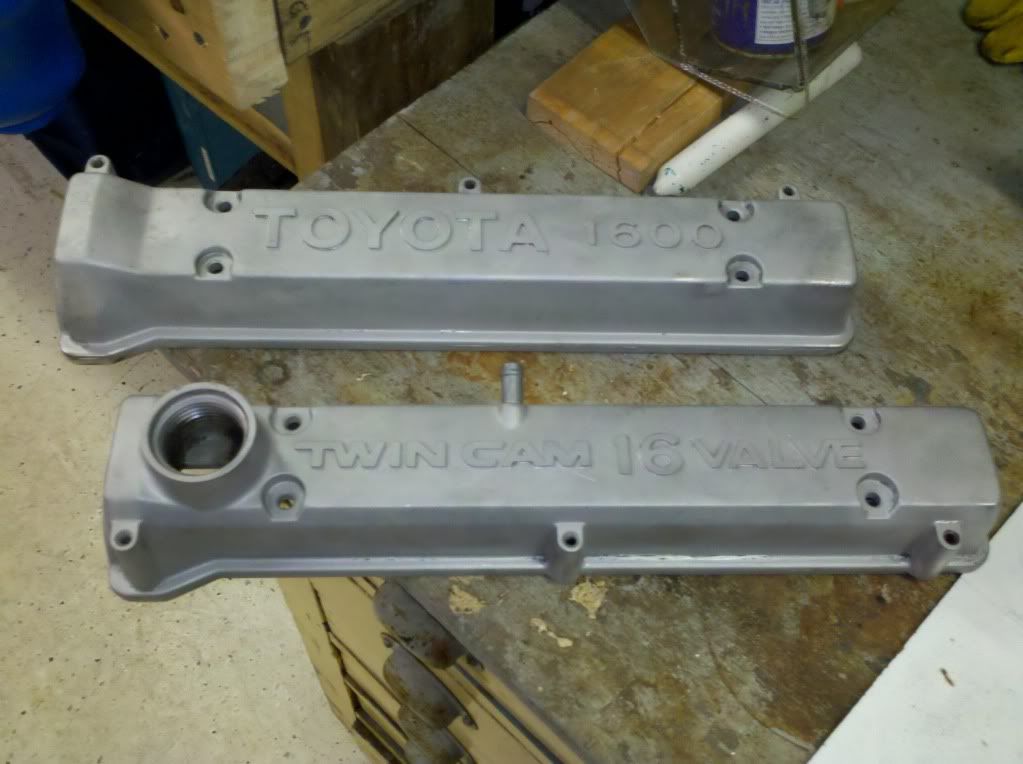

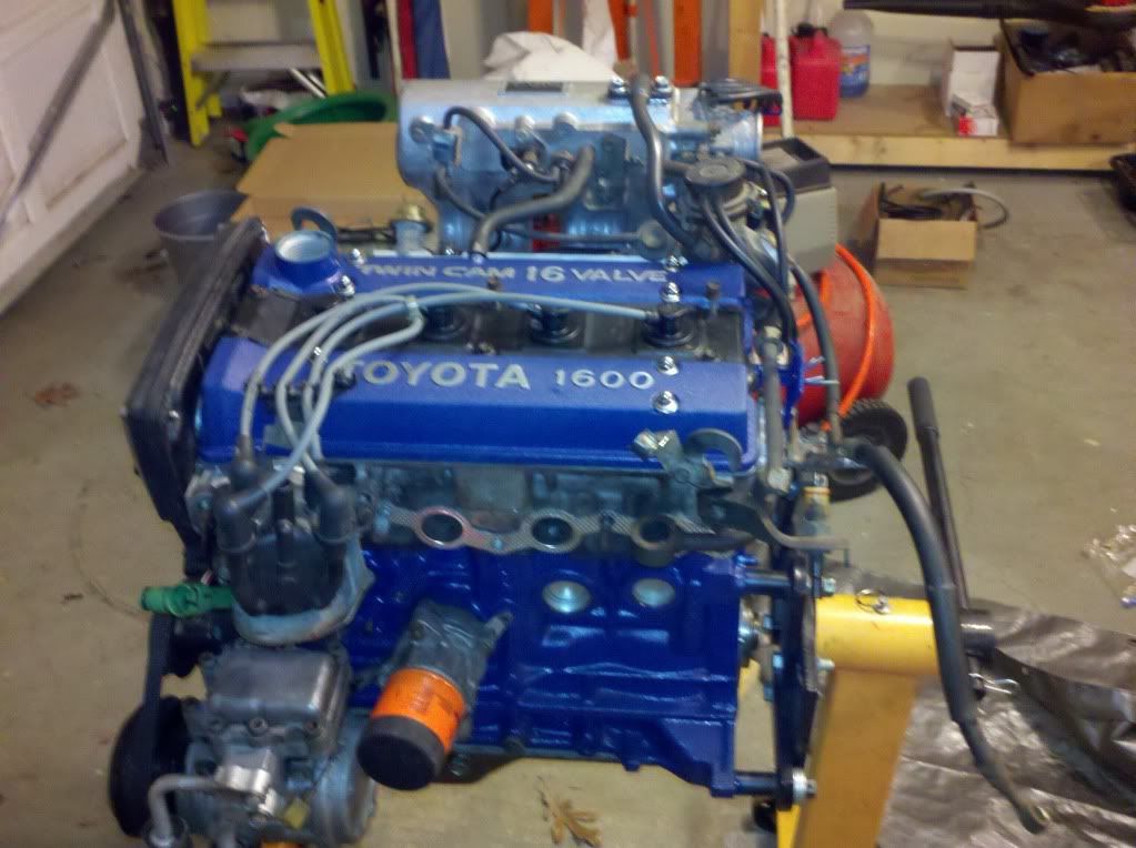

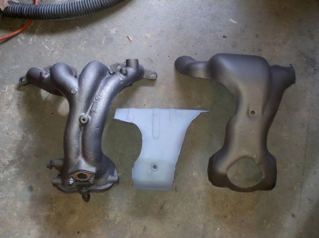

Slight bit of progress. I'm waiting to see if my exhaust manifold crack can be welded, but finally got the valve covers done in a blue wrinkle finish powdercoat:
After sandblasting:
Closeup:
Motor thus far:

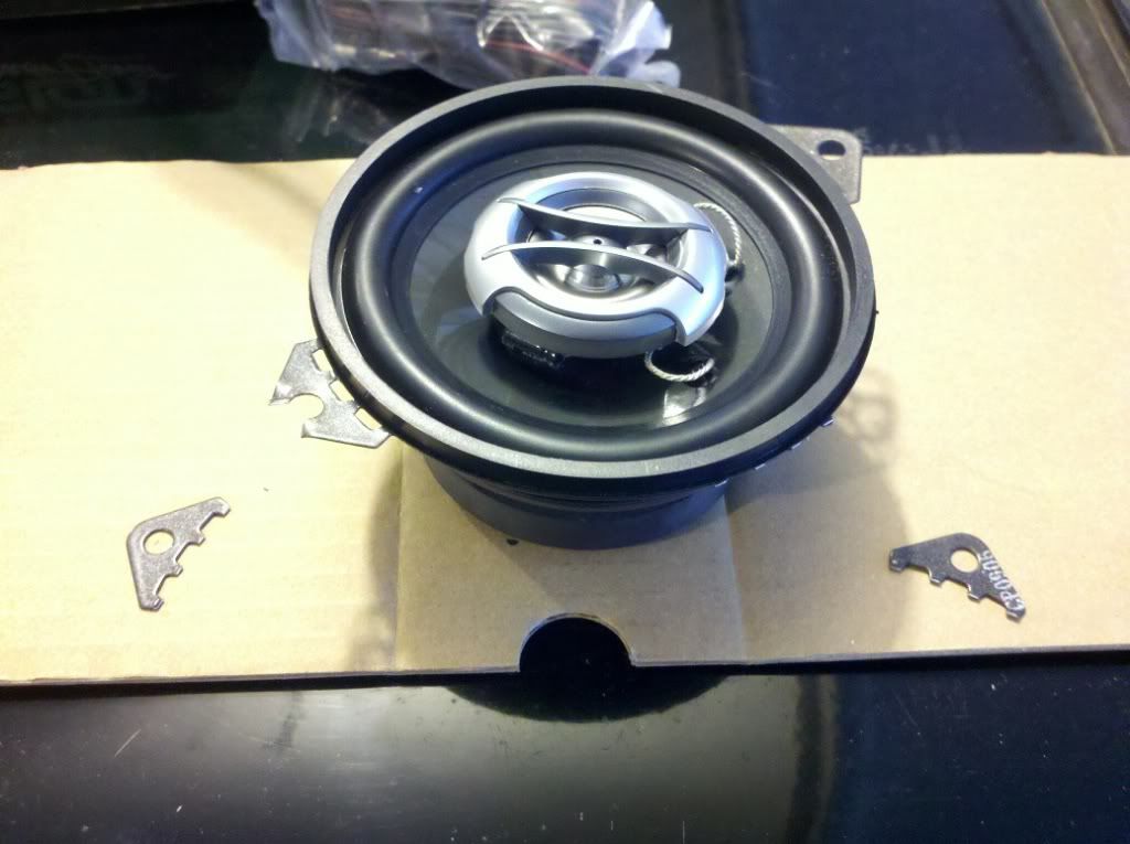

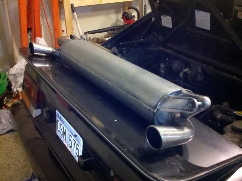

But since last time I posted here, I've had the ex. manifold welded, bought a 2nd generation turbo muffler for the car,

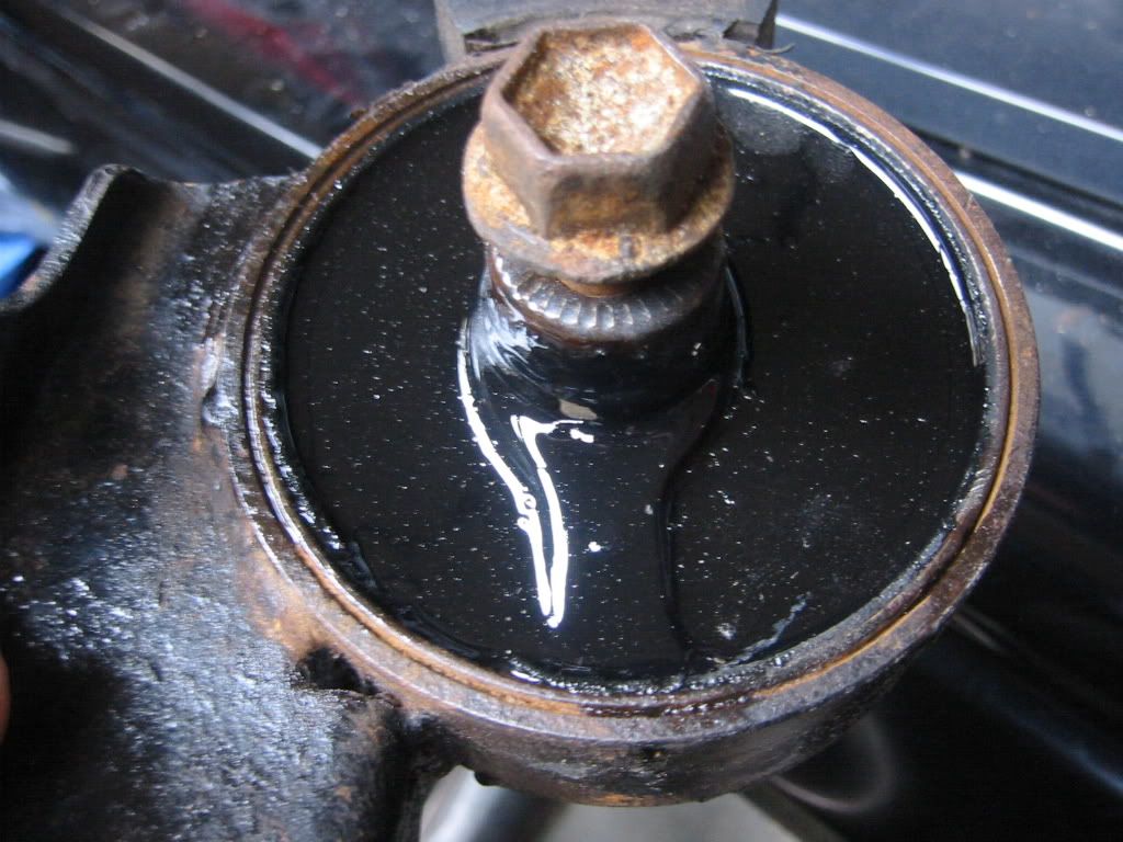

filled the motor mounts with urethane, rebuilt the throttle bracket assmebly, bought new struts(and in the process of installing them),
and installed new front speakers.
Pics:

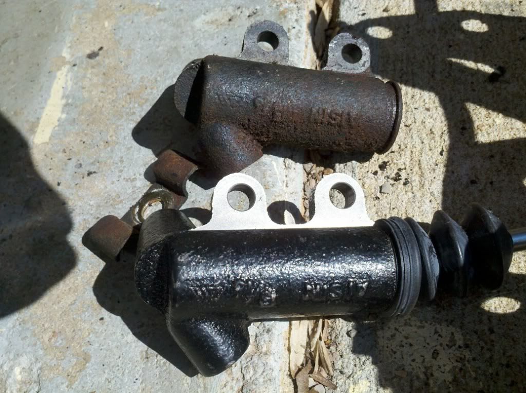

Replaced the slave cylinder today.
Normally, Autozone or Oreilly's has the best prices on parts,
But Pepboys surprised me with a $22 slave cylinder, when everyone else was asking $35. It was a LUK part(lsc225), but it's apparently OEM:

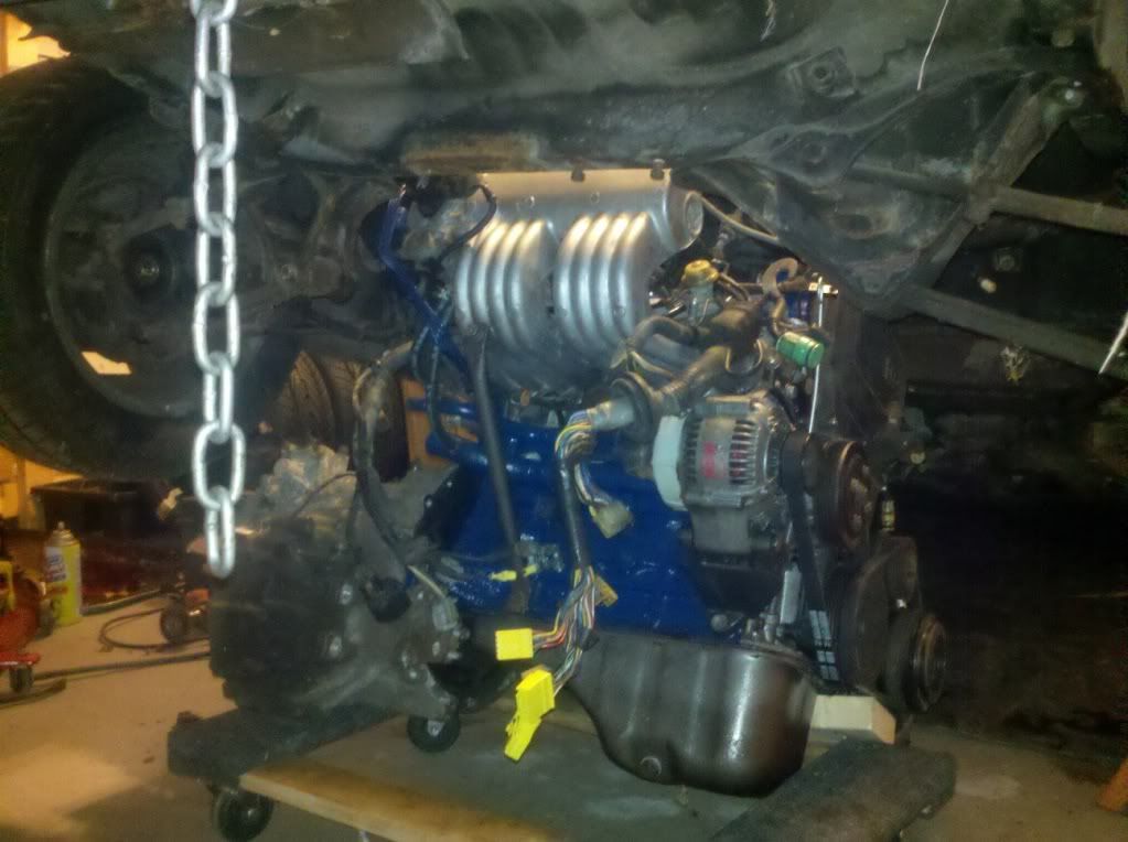

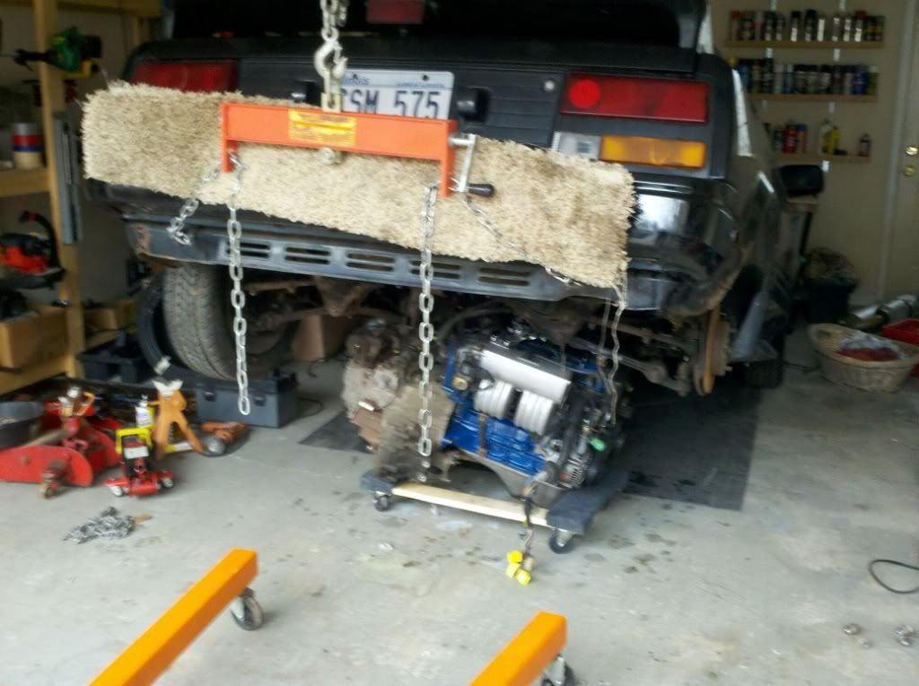

But there's bigger news- I mated up the clutch and tranny to the engine, and shoved that Biotch in there!
Yay me! First time the car's had a motor in it in about two years.
Although most of the harness/ electrical/ecu connections are done,I still have to do AC, coolant, axles, clutch and fuel stuff. Also, I'm apparently still missing a number of clips, bolts, etc., so I have to make a list of what I'll need to finish it all. But at least now the hard part is done, and it's just "connect the dots" at this point.

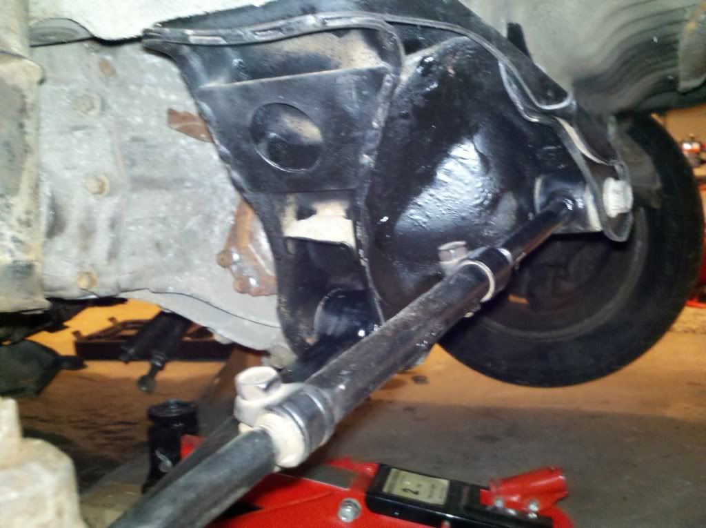

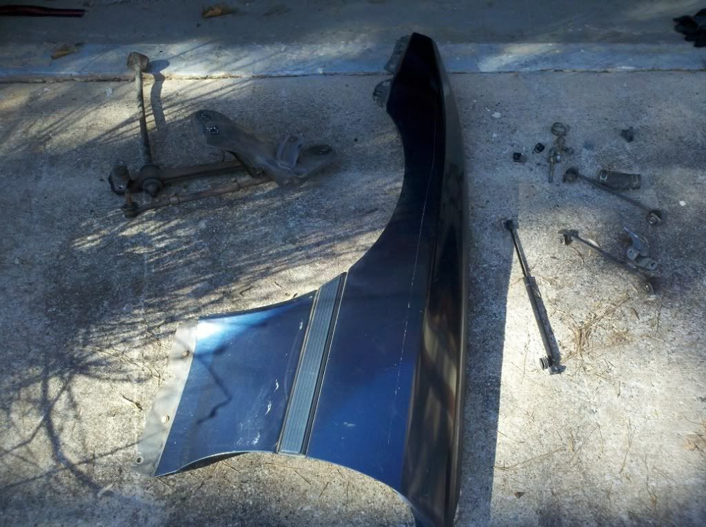

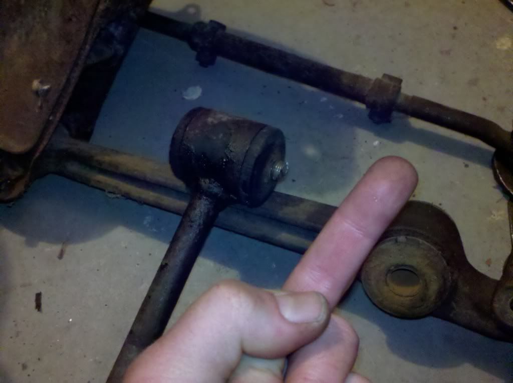

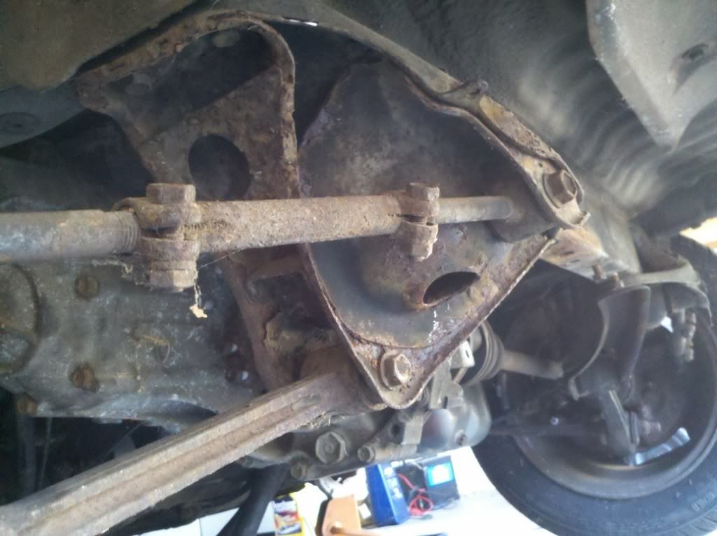

So today, I had to go down to the pull-a-part to get a rear motor/torque mount, as mine is all rusted out and generally screwed. Last month, they put an '86 on the lot, and I seemed to have gotten there first, as everything was still on/in the car. Today, however, was a different story. The entire interior was gone, as was the tranny, Right read suspension, hood, rear bumper, and of course, my motor mount. I did, however, notice that the driver's side rear suspension was looking pretty sweet compared to mine, so I decided to take it. Surprisingly, All of the mounting bolts came off nice and easy. Also, I grabbed two front sway bar end links, and was again surprised how easy the bolts were to loosen. I also grabbed a front fender to an '88 Supra to help with my other restoration, as well as a small rear glass lift strut from an Expedition, to make an engine cover strut.
Getting my rusted-ass original suspension assembly off, however, was a royal PITA:
Finally got everything unbolted EXCEPT the compression/ caster rod mount.
Using PB blaster and a impact gun got me nowhere. I finally broke the bolt head off, then used an angle grinder to get the nut off the other side, and THAT wasn't even enough. The bolt shaft was completely rusted into the caster rod.
Finally got it off, and got the new suspension on in no time:
Anyway- Most of the reconnection of stuff is done in the engine bay- gonna go back in there and hook up the ac lines, drive shafts, and oil cooler lines, and I'll be pretty much done. Tomorrow, I may try to start it.
