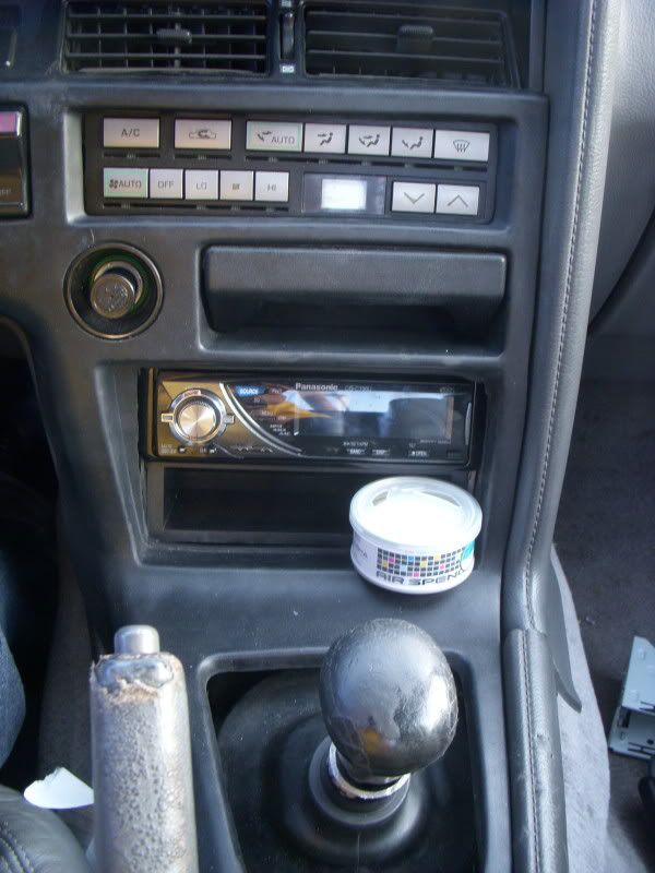

My shift boot was really ripped up so I just trashed it
Funky shift knob?!
Sure seemed as if...the P.O. cut the shift lever. Is this the SOGI mod?!

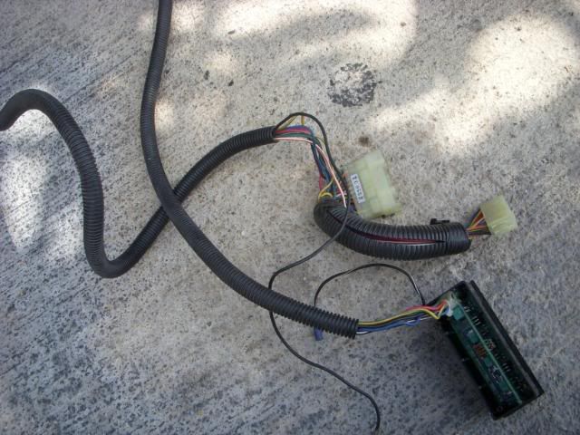

So after the stereo was off...I picked up my deck and tried to attach the harnesses together. Well guess what? There was no harness :nono: The P.O. directly connected the wiring to the stereo.
So I took a break and ran over to pick your part and snipped some off another toyota. Came back and added on my new harness and such.

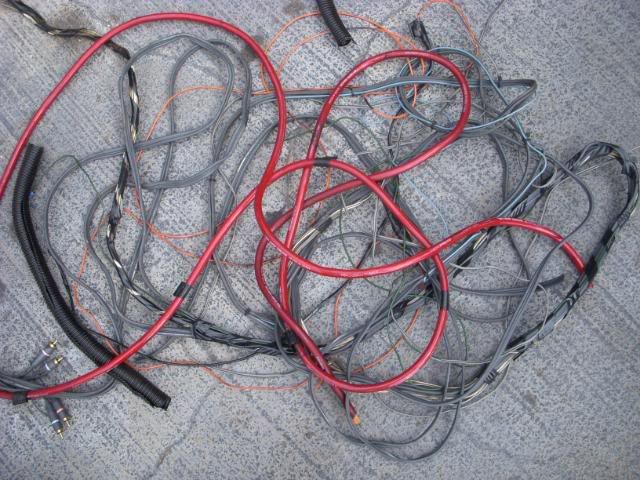

Before putting in the dash, I came across the old sound system wiring. I thought to myself "Why not use it if it's already set up?" So I followed the wires to their end points and guess what...the connectors were snipped.
So I said screw it and started to pull out all the wiring. Here we go...

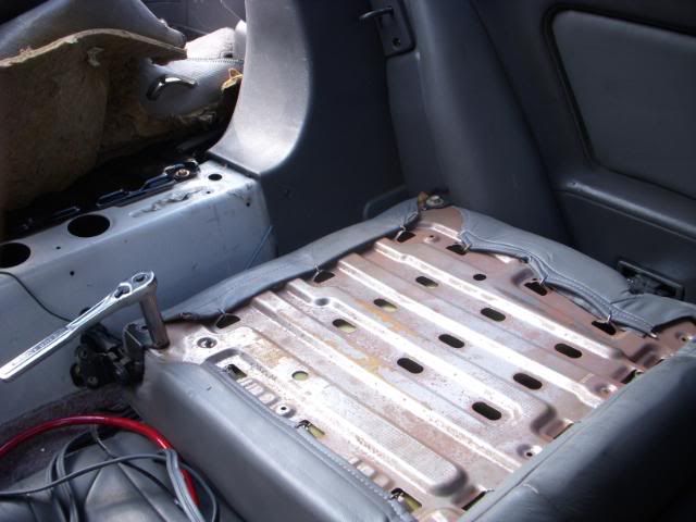

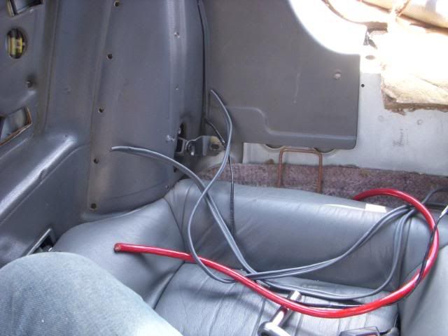

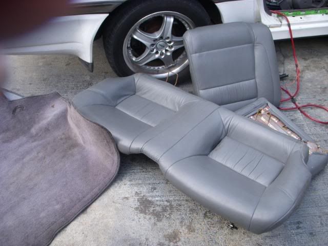

Started to expose the rear seats
After about 10 minutes or so, the seats were out.
And so were the wires.

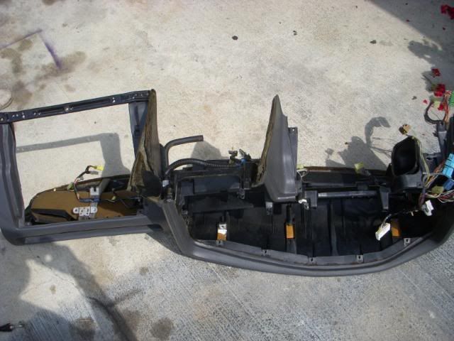

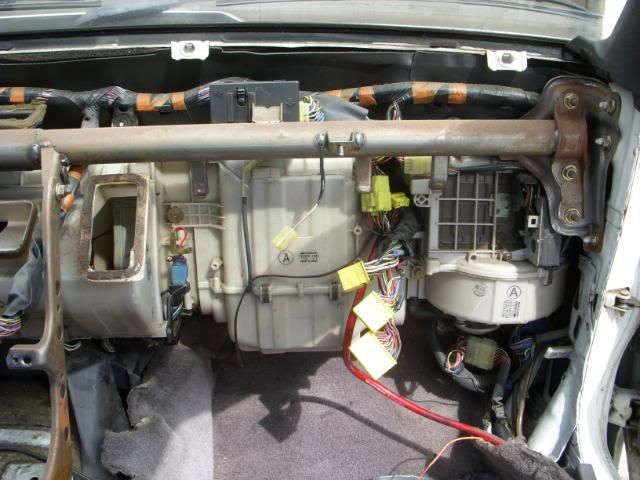

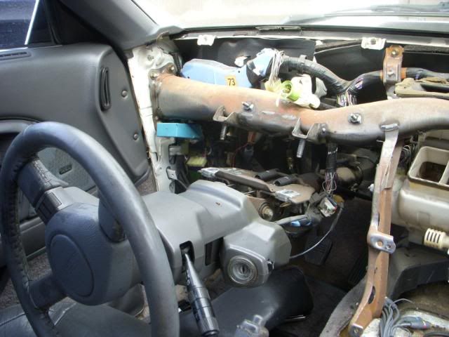

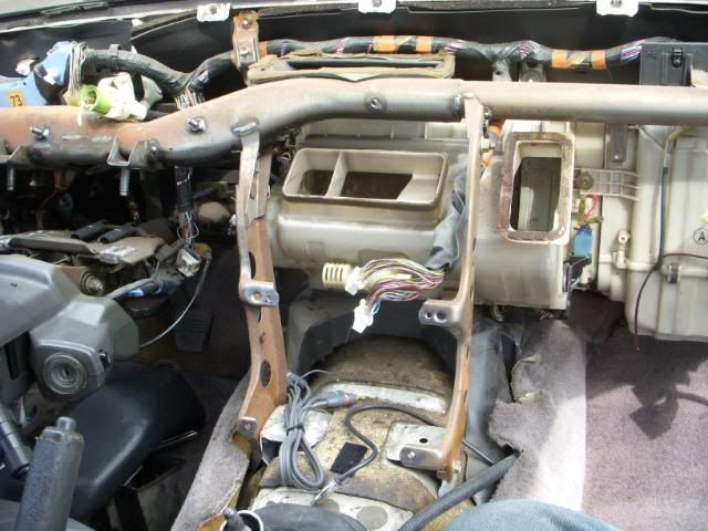

There were some other wires that ran through the dash...and it was incredibly hard to splice my new harness into the dash wiring in the position it was in...so off the dash came!!

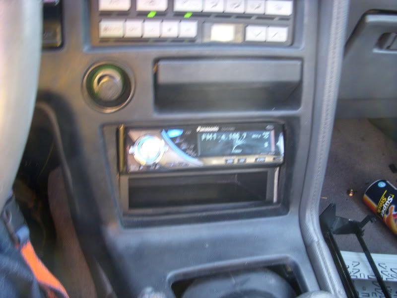

After a long day, I put everything back and installed my new deck.
Some extra shots after the day!

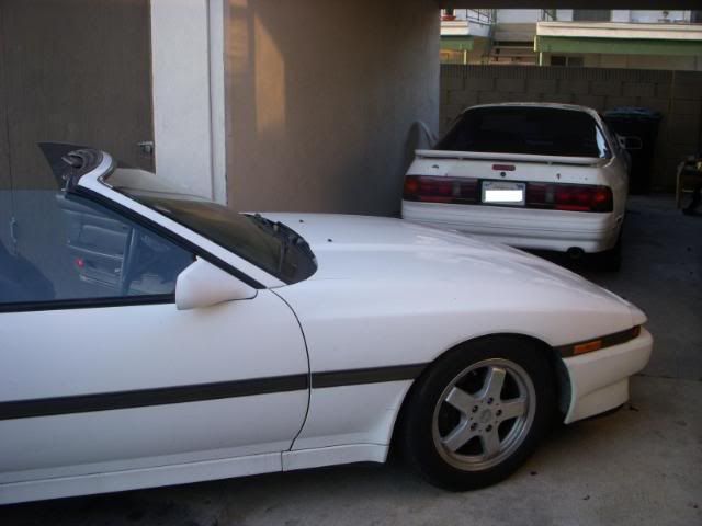

Looks like a cool project. It also looks like you're taking no time in getting down to business.
That shifter does look to be SOGI modded.
Now all you need is a white 300ZX to round out your collection :)
thinhman
Feb 7, 2009
75
34
Garden Grove
HAHA got you on check :icon_bigg
Too bad it's not white. =[
I actually just finished getting that z31 up and running in that pic.

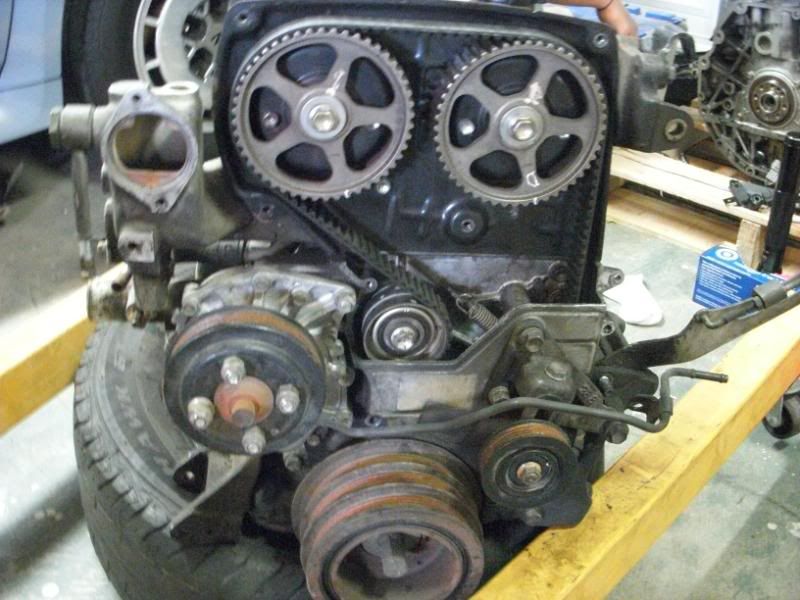

For this engine, I mainly just want it to be reliable and not having to tear it apart again for a while. I'm just basically doing a full engine overhaul and replacing as much as I can. So far my list sits at:
- HKS MHG 1.2mm
- ARP head studs and bolts
- New exhaust studs and bolts with helicoils
- New Timing, AC, PS, and alternator belts.
- New timing belt tensioner and spring
- New dizzy and rotor
- New spark plugs and wires
- New engine gaskets
- New main and rod bearings
- New pistons and rings
- New water pump
- New silicon vacuum hoses

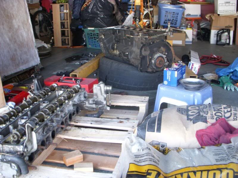

Alright, here are some pictures of the engine sitting in my garage.

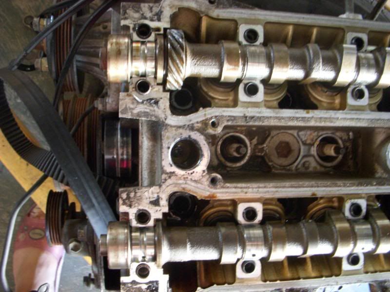

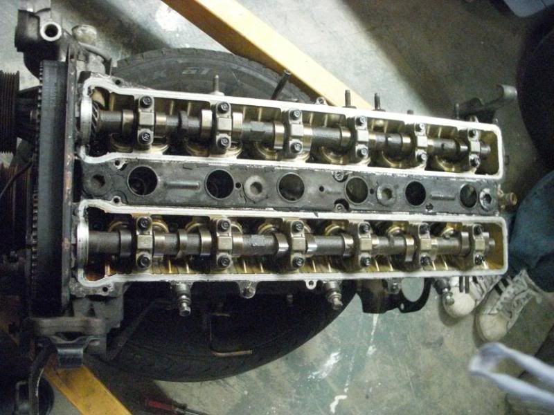

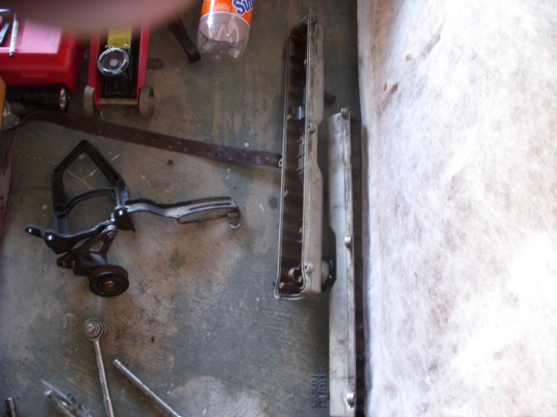

Here are the valve covers off

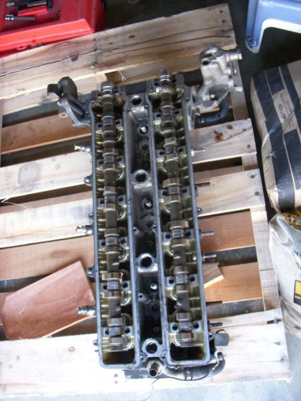

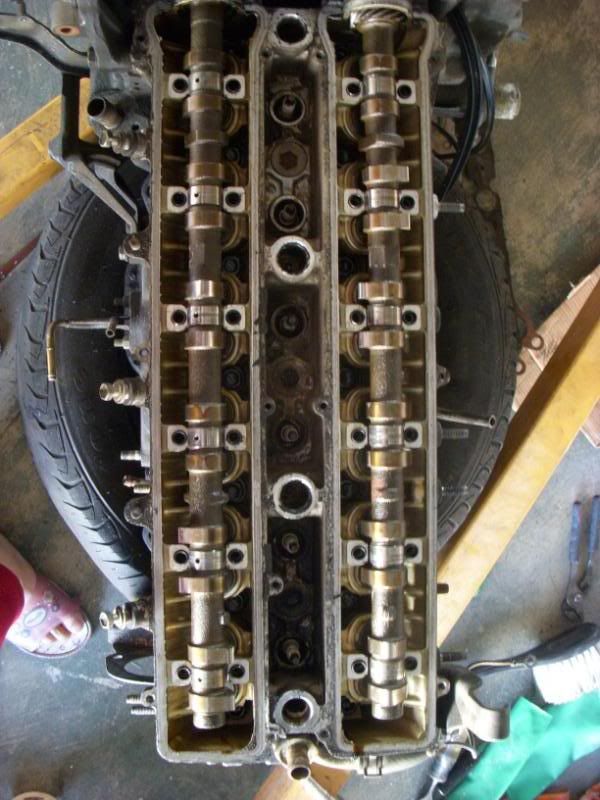

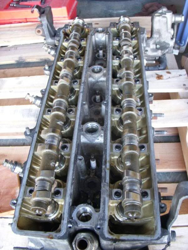

Here is the head
The head again with the cam brackets off
Middle valve cover is off now

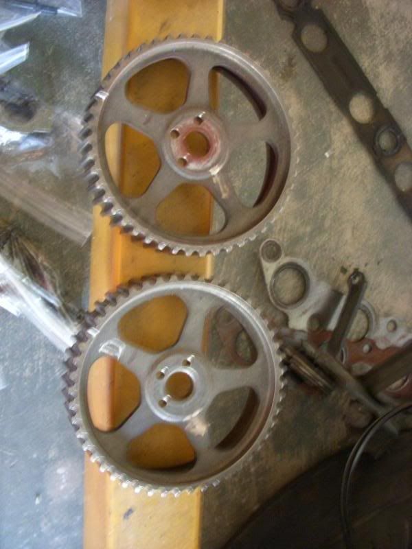

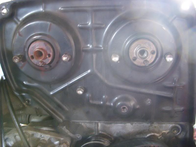

Cam gears off next
Along with the cover behind it

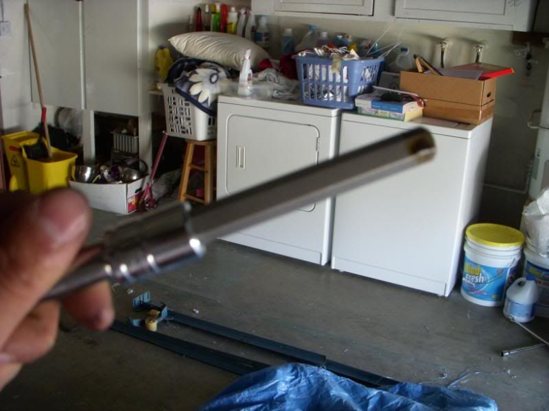

Ran to the auto store and grabbed this sucker
and off came the head bolts!!

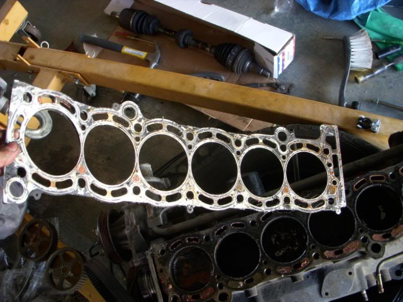

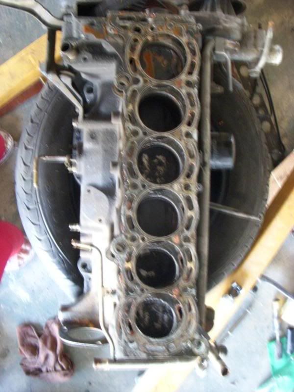

Here is my head off the block
Back to the block

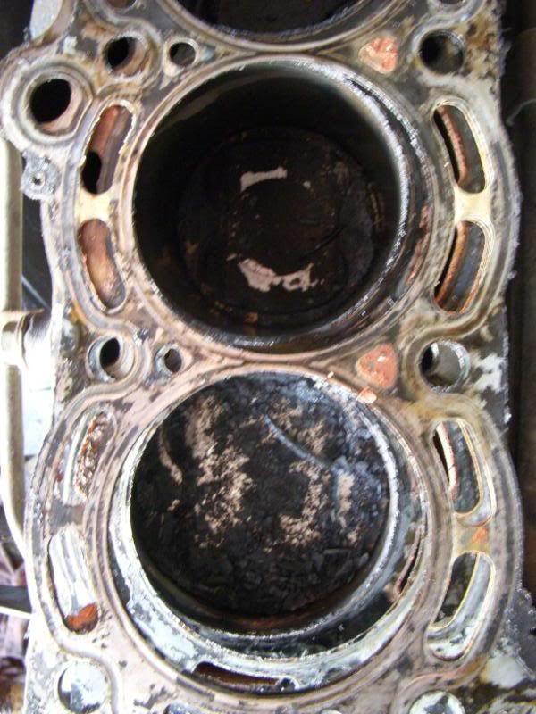

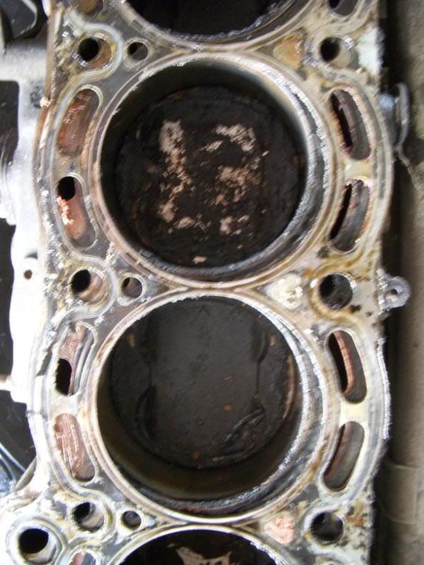

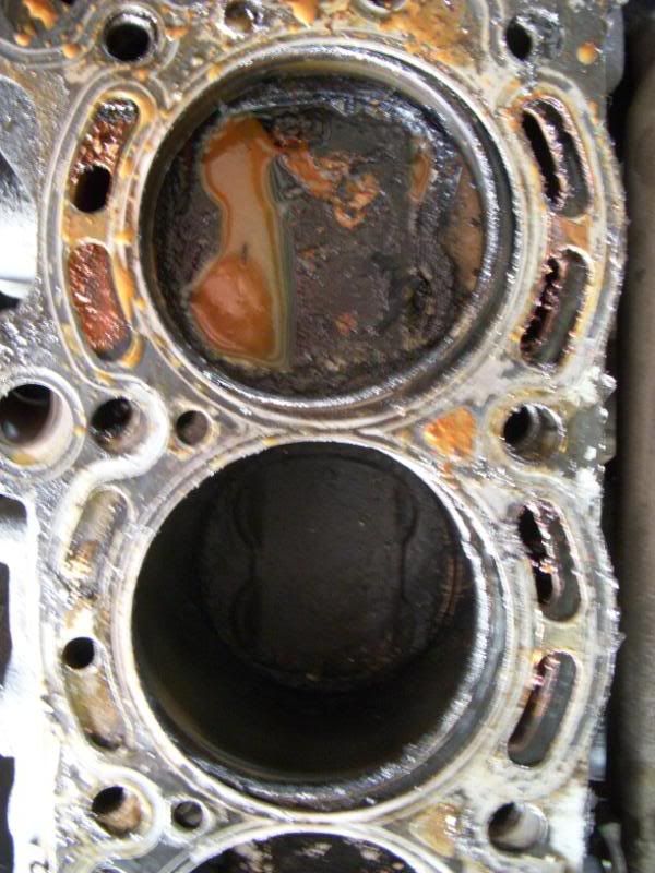

Here are cylinders 1 and 2...look at all that gunk
3 and 4
5 and 6
Warzone as it sits now in my garage

BTW are you doing an NA or turbo build? Looks like someone put a MHG on an NA... why would anyone do that unless it was turbo'd..
just took the nearest ones to me (out of like 7 pairs?), and those happen to be it!
I'll take a pic of the all sandals for you guys lmao.
I honestly don't really know what work was done to the motor; I bought it from a shop with 55k miles on it. I'm staying na, and I thought its good to put MHG on both na AND turbos regardless?

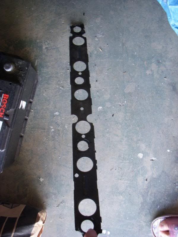

Just curious but was that a AJ USA Headgasket you pulled off your motor? Other than that looking good N/A builds are nice to see
CyFi6
Aliens.
Oct 11, 2007
2,972
Phoenix
www.google.com
MHG isn't going to hurt on both NA and Turbo applications, but for stock power its not necessary. And for NA, its really overkill. I say if you want, go for it since you are pulling it all apart and doing all the machining, but if its really much extra work, i would just stick with a stock gasket, there's a greater chance for success with it.
thinhman
Feb 7, 2009
75
34
Garden Grove
So are you saying it doesn't increase my head gasket security?!
And no I do not know what kind of head gasket I pulled off the engine; I thought it was interesting as well.
I just don't wanna deal with a BHG in the future; I wanted to eliminate that problem. So with that said, I thought ARP and MHG would solve that issue?
I also have a MHG question...I pre-bought the gasket (HKS 1.2mm). Now do I tell the machine shop to cut off that much? Or should I get the block decked and then buy the gasket respectively to the amount they cut off?

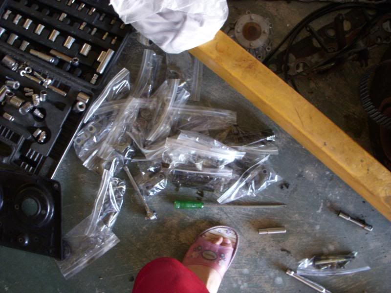

little update: tried to degrease my pistons and the gunk wasn't coming off...so I decided to leave them in for a bit.
well school and work slammed me and i forgot I left them in...so when I went back to them there was mold growing on the damn things >_<
so I took out the pistons and put them all in a bucket and started spraying them down with some water. haven't checked back on them yet...but I'll let y'all know.

You have to get the machine work done, see how much they take off the head and block combined, then add those to 1.2mm and then find your proper gasket size.
Make sure when you go to have the block machined you have the rear timing cover bolted to the block! It is the aluminum one that the water pump is bolted to. Also make sure you have the timing belt tension er bolted on there and torqued to 36ft lbs when you have it all machined if you are getting the cylinders done.
Also, you need to make sure the machine shop can get a good enough (smooth) finish on your parts, otherwise your head gasket wont seal. You cannot just go to any shop and ask them to deck the block/head, you have to make sure that their machines can meet the requirements of the head gasket you are buying.
