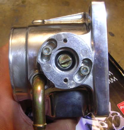

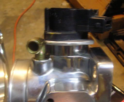

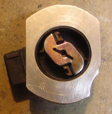

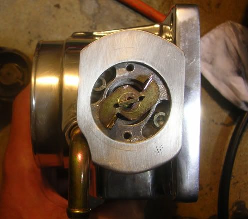

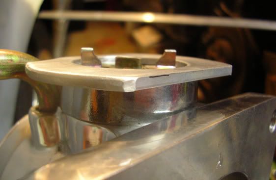

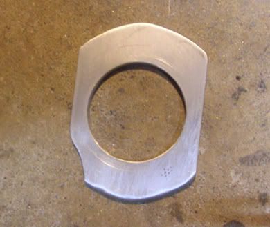

jimi87-t said:

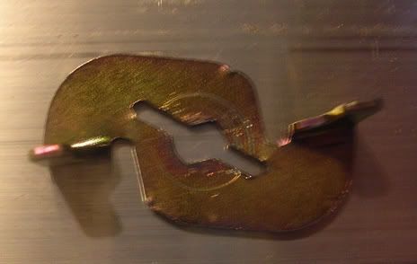

Great info, Not to hijack, but to add to the info here, this is what I did to make the toyo TPS work with the same type TB. Pics say a 1000 words:

Whasian said:
I like the idea of converting the throttle body to fit my supra tps..I am trying to contact the person who actually make these parts becuase I wanna see if he will make some for me. I am will to pay good money for them...Anyone know who this person might be?
Whasian
glad that write up helped someone :)
that is jimi that did the mod to use the factory tps. you can try to email him, he hasnt been on the forums in over 2 months.
profile and email:
http://www.supramania.com/forums/member.php?u=2194
the reason i chose the ford tps was because the throttle body came with it brand new, they are smaller than factory, and can get a replacement new all day long for cheap.

Yea, I got the part about cutting the center of the tps...Is there anyway you can load a picture with the piece you fabricated on here with it being proper size? I wanna try and make a template off the computer and trace a peice out on a sheet I have.
Whasian
* Does the TPS have both fins that you used or did you need two TPS's?
