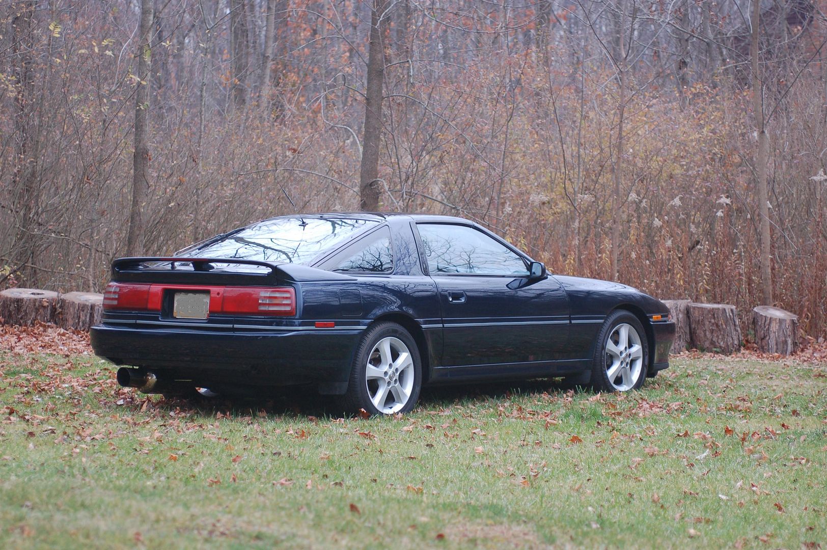

UPDATE!
Well, now that the car is back from body and paint (had a bunged up tail end... and buckled rear-left quarter... but it's GOOD NOW!:biglaugh:)
...I need to address the BRAKE ISSUE that I left unattended when I SHOULD have been ordering parts! Started to DRAG pretty bad RIGHT after picking the car up from the shop... so I did a couple hot laps and a short photo-shoot (while it's still NICE and FRESH paint... since ANYTHING could happen if I wait! DOH!) and decided to PARK it for the week... until I fix the "hot-box" left-rear... and brakes in general.
Finally just took the plunge and ordered:
- REMAN set of "loaded" rear calipers
- POWERSLOT rotors
- Braided lines
I figure that will at LEAST slow me down without SCREECHING and SMOKING out the left rear now!:)
Another update once installed for effect and balance with the Wilwood's on the front... but I'm not concerned about the balance, since the fronts do SO MUCH of the braking, and even WITH the lame-o condition on the current rear, STILL manage to haul the car down GREAT!
-crisp
