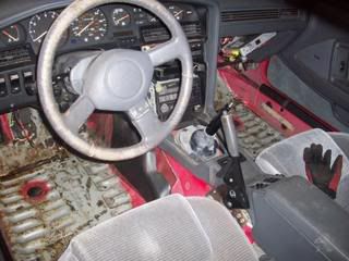

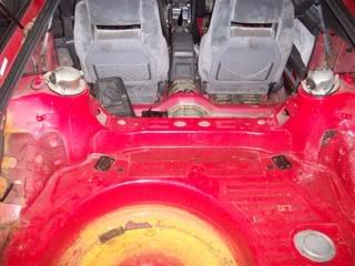

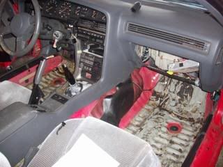

update new pics on progress.
just stripped it and removed the glue
im ready for a cage. i dont know how im goin to go about this yet(buying or building one)

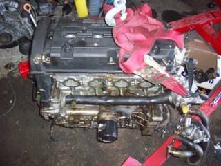

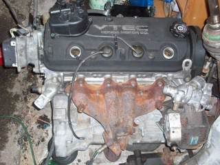

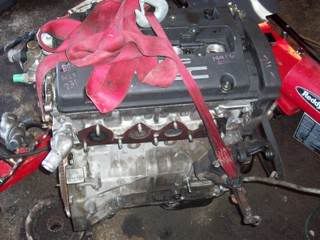

anyone want a honda engine? i have one h22 and a f20b

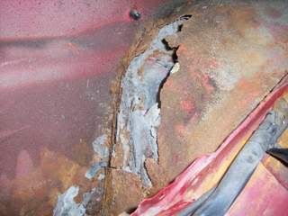

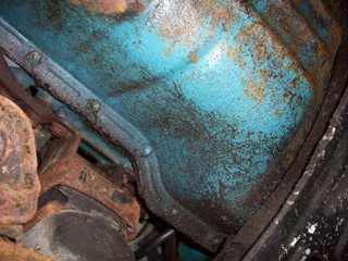

made a jumper to pin 2 and still no power on 12 and 13. when i was under the car today just looking around i noticed that the block and oil pan are blue. does it coem this way stock?
also i found a bad area from rust
looks like ill be cutting and welding a new section

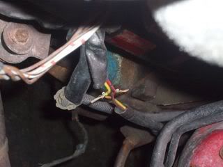

when i was taking out all the plugs today i noticed this under the intake manifold.

after i pulled the harnes threw the firewall i noticed that the harness has been cut and very poorly taped back i found wires going to nothing so im going to go with that being a big problem.
