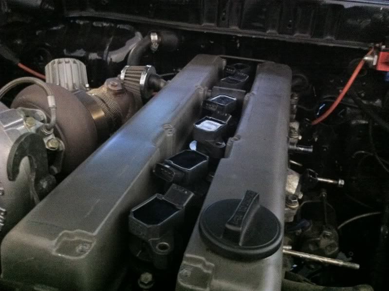

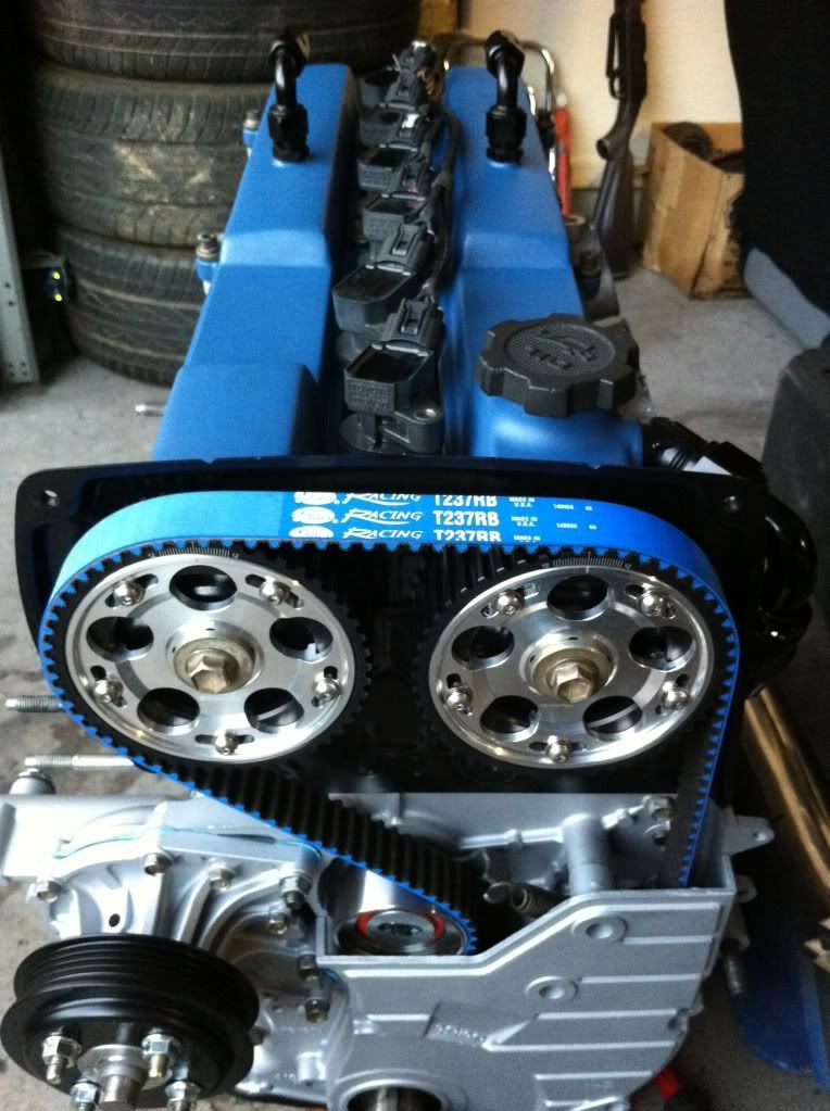

If you have a standalone. go with 1ZZ coils. they are like $30 each. and can run a 30+ spark plug gap and 30+psi with no need for a DLI. and built in ignitors.

Albert: Are those a direct fit? Are they supported by the center cover? How are you mounting them?
Enraged: Have you thought about how to mount them? Or are you going to use them with IS300 coil boots and use them as COP?
No. I am making a custom center cover for them to sit on.
