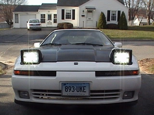

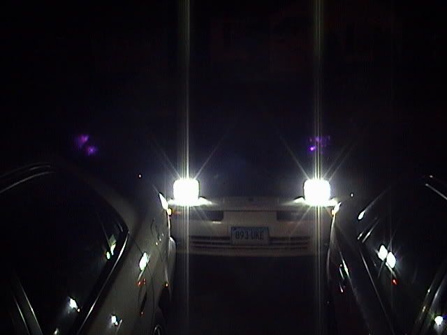

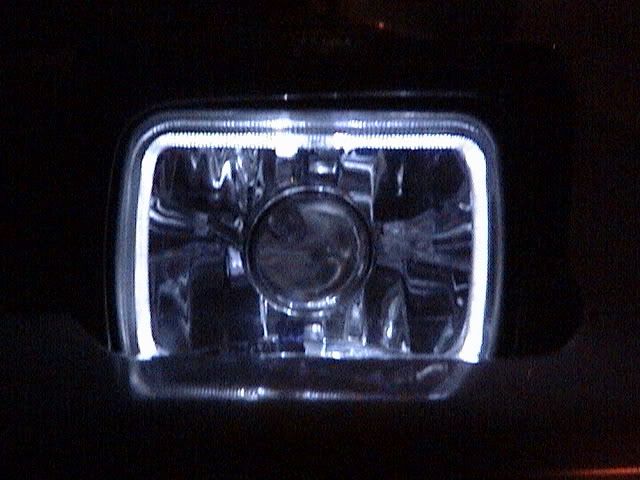

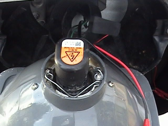

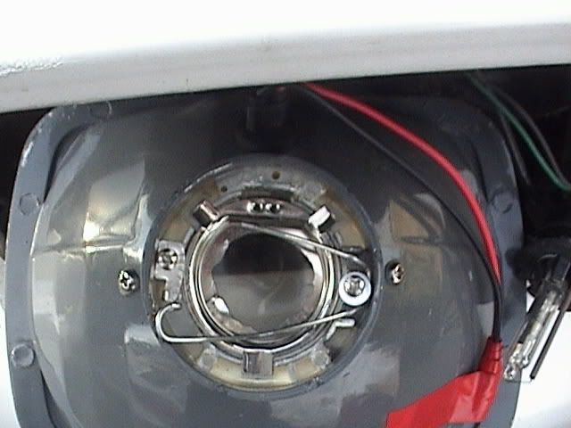

Just as an informative note, I was able to retrofit the Maxima HID's I had been using on my sentra into the projector housings on the supra. Took me about 2 hrs total and they look great. I'll post pics when I get a chance.

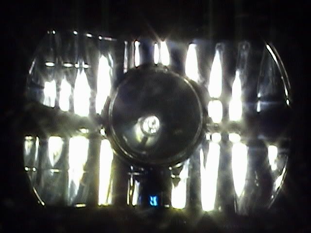

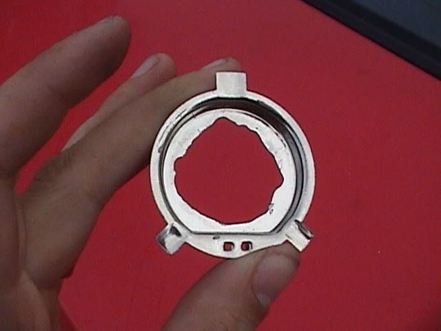

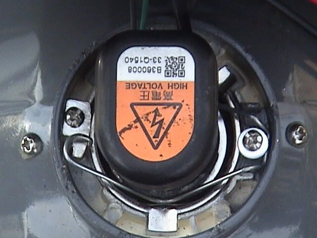

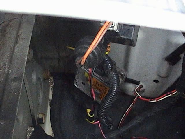

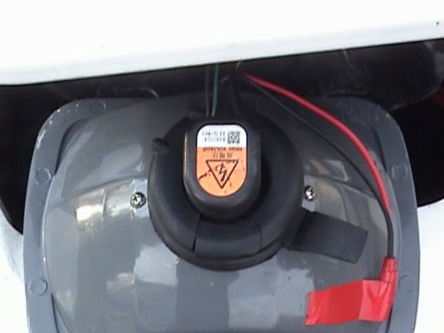

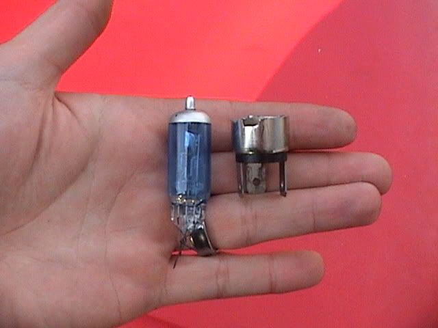

The previous owner had installed angel eye projector housings, which look OK. I just removed the bulbs, disassembled the bulb so that I just had the 3 pronged metal ring with a hole in it. Enlarged the hole so the HID bulb would fit into it, then used the metal clip to hold the bulb in place in the projector housing. Wired the ballasts into the low beam supply and strapped everything down under the popup housing.
The HID's can be found pretty cheap at a junkyard. They came from an 03 maxima I think.
