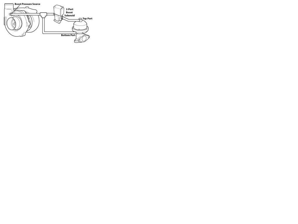

does anyone knw if the masterpower T-70 turbo has a nipple on the housing for a boost controller to tap into it? i cant find it :/. do u need this nipple if u want to raise the boost? cause im pretty sure my turbo doesnt have it..anyone else have this problem on there masterpower?

Mine does not. You can install one or just run the vacuum lines from a good vacuum source, like your intake manifold. Thats how I do it and it works great.
The pic above is how you want it, but you can also run the reference from your intake manifold. Just posted the pic to clarify.
