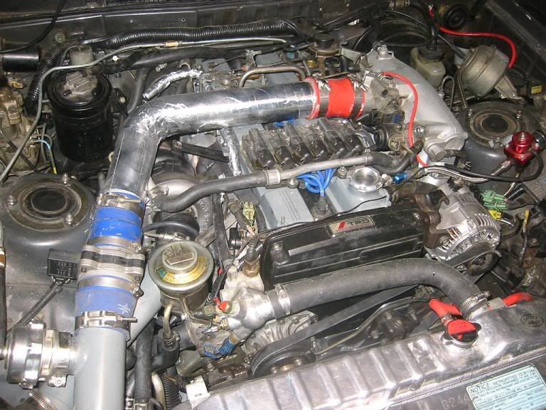

I've run the MAF-T in suck-thru and blow-thru mode, but again, that's using a GM sensor. It won't really work with our OEM units. I have the MAF about 1.5 - 2ft from the TB in the IC piping.
