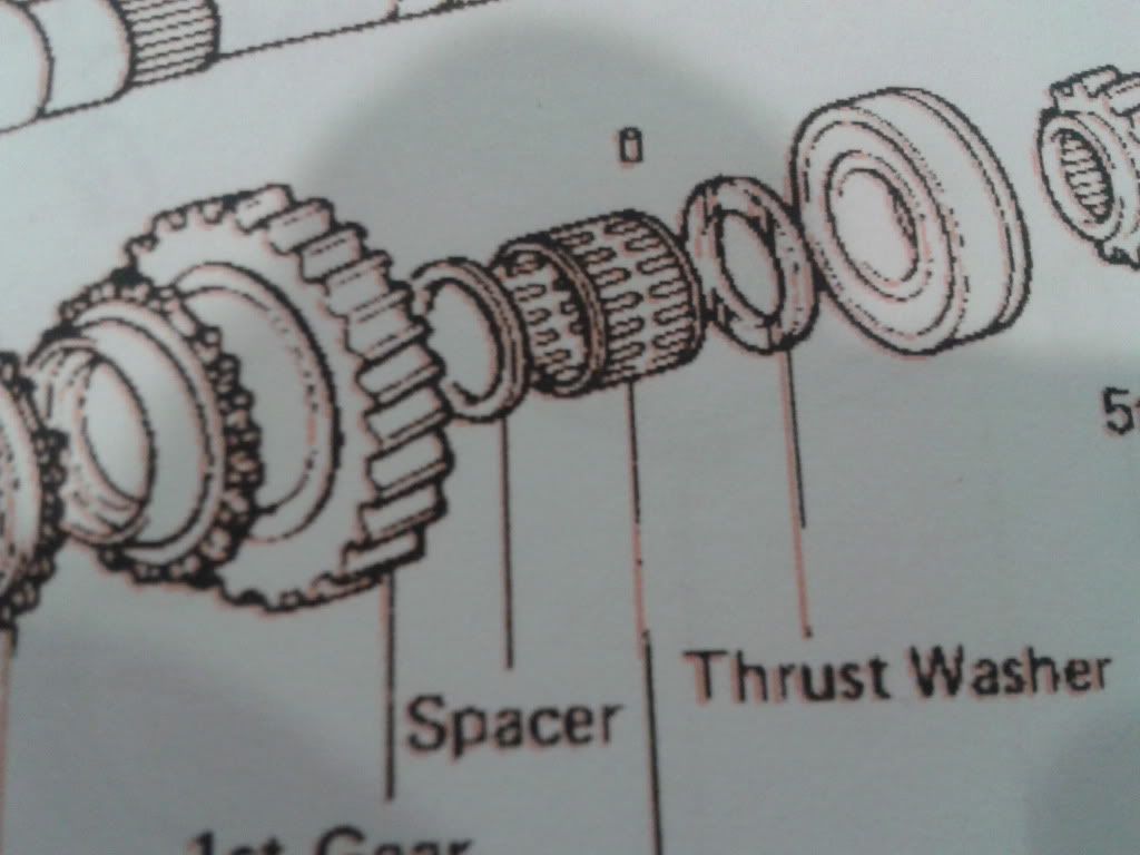

Oh location of the 1st gear thrust washer

Some photos to understand better what I try to say to you.
B.Plastic slice.
A.Slice with blocking by a ball.
Measure physics on output shaft
Measure physics made on trees and slice in more unknown.

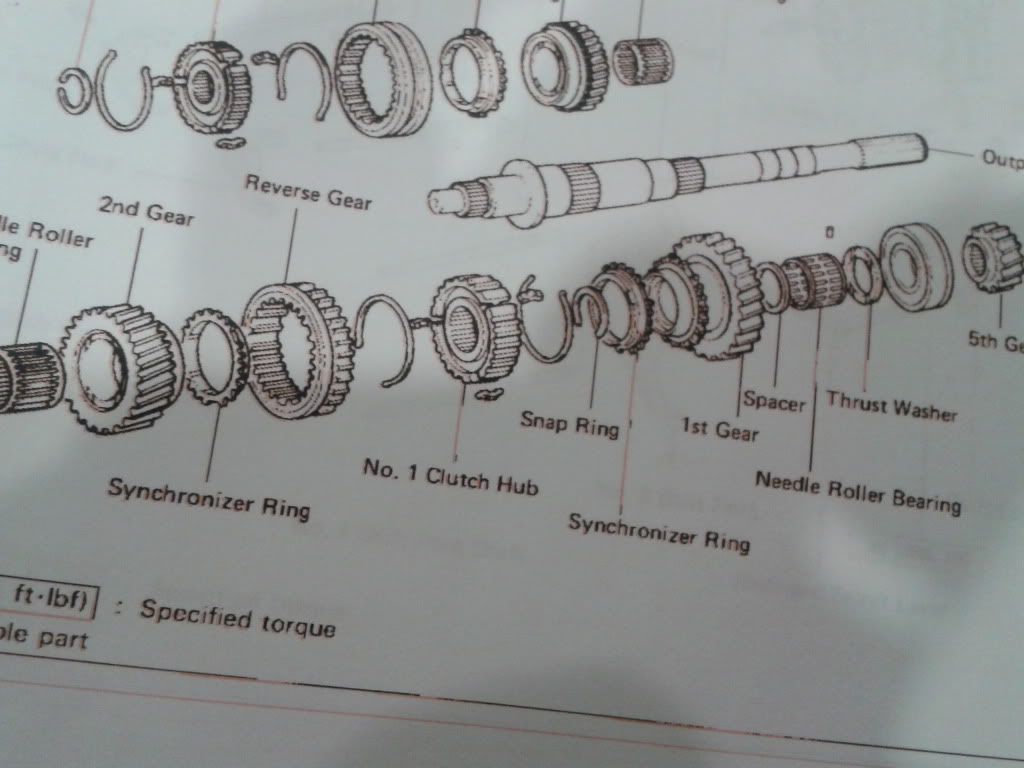

I hope that it facilitates you the understanding of the problem

Ok in the 1st pic I think your asking where the plastic slice\peice goes. And it is the spacer in this pic
am I getting closer to helping you?. Pm me your email and I will send you all the info in the book I have tomorrow

I found, that's it, I found.:biglaugh::: angry :::evil2:
In fact, it is curious, it is a R154 with a slice at the end of counter gear just before the bearing and the snap boxing ring. like a W58. Curious
Grace in your invaluable help, in looks for make on the Internet and a documentation lent by an enthusiast of toyota, it is in the box.:drink1::bigthumb:
It does not more remain than to go back up the whole and to drive.

The place were it go.
next post last week :biglaugh::evil2::: angry :::aigo::nono:
Matthieu
Jun 24, 2013
13
Normandie
After removal of the bearing, it is about the old slice of the old bearing. That of lost time it is better to be far-sighted rather than to notice a problem once the rested gear box.
