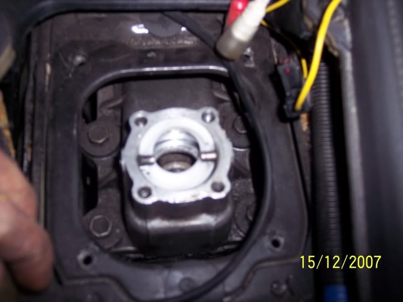

To install first remove the interior pieces necessary to get to your shifter.

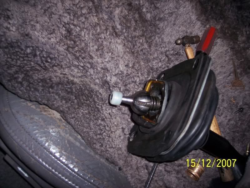

Then remove shifter, remove the plastic cup on the bottom of the shifter.
Press on the new plastic cup to the bottom of the shifter, now that is ready for the next step.

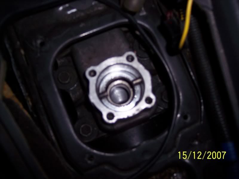

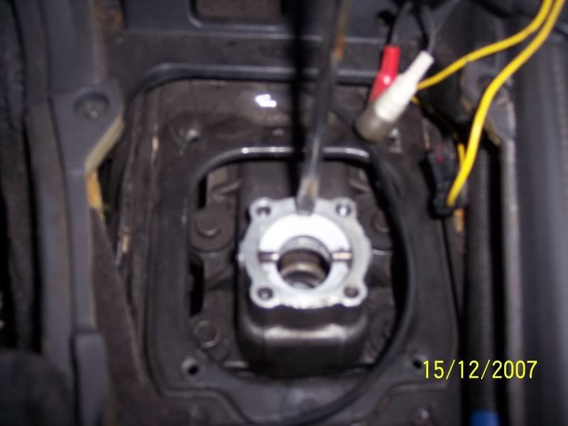

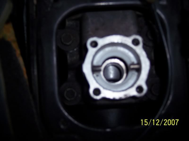

Use a flat headed screw driver to pry the old cup out of the tranmission.

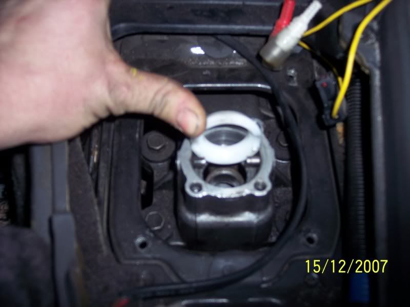

Here it is removed.

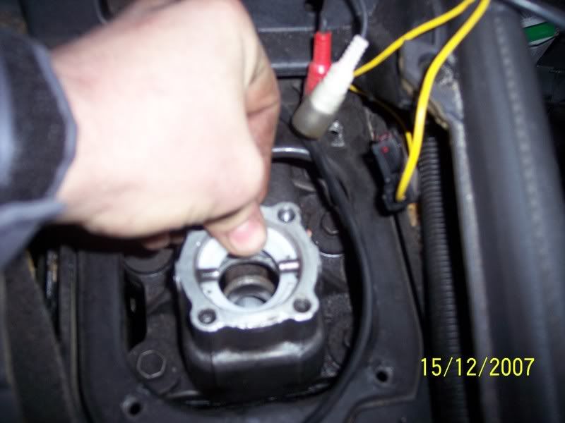

To install follow these photos.
Here it is removed.
