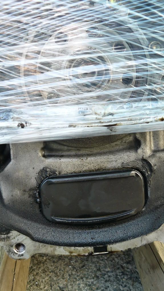

hmm update.. took a more careful look and saw it is NOT the rear main, its this thing below it.. not sure what it is. want to help me out?
black thing below rms
collin_1jz
Mar 12, 2009
22
vancouver
oooooh ok i looked even more carefully and yes it is a window.. haha.. the angle the engine was dripping oil onto the rubber cover for the window so it looked like it was coming from there..stupid..so are the rear main seals with the 7m gte interchangable with the 1jz?
