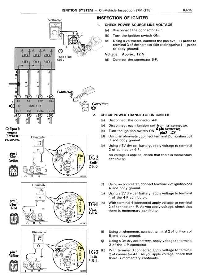

Ok, well I have been having code 14 so I went out and tested my igniter today. I did the 3v test to test on the coil pack side if sending 3 volts would actually cause any continuity, it worked on coil pack C (2 and 5) reading roughly 8.xx ohms for a few seconds then Out of Limit... I tested it on both coil pack A and B and they read nothing, I am correct in assuming that this test shows the igniter is not properly functioning.
The reason I ask is because we got the car running on ether, and it was firing on more then 2 pistons, so how are we going to assume that the igniter is bad when the car actually ran on at least 4 cylinders for a good 30 seconds with ether
