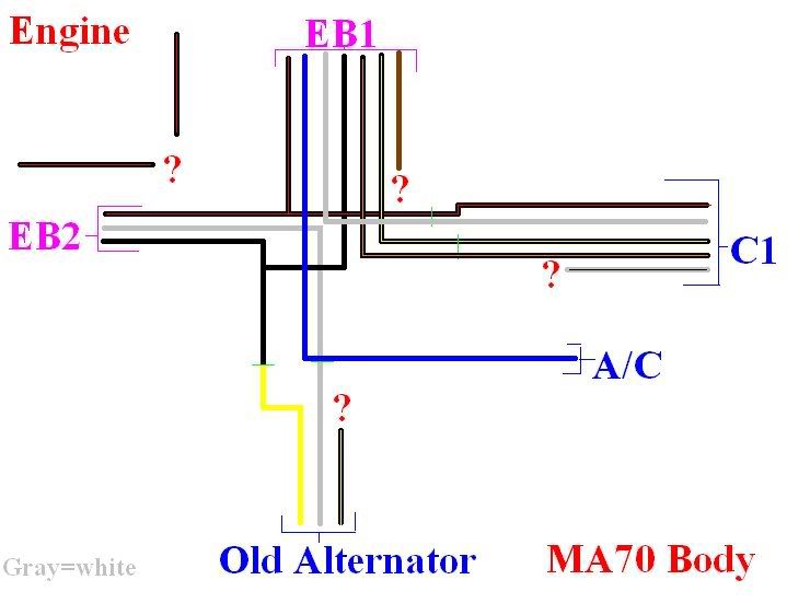

It took me long as hell just to figure out these plugs according to af1jz's helpful thread about wiring the soarer 1jz into the ma70. And I know that other people are having the same troubles. So I took it upon myself to take pictures of the plugs for future reference to help people.
IK1
IK2
IJ1
IJ2
A majority of the wires off of these plugs do not get used. Or at least I did not use them.
The EB1 and EB2 plugs are usually cut off and are in the general area highlighted below.
Vote for this to be stickied!!!
