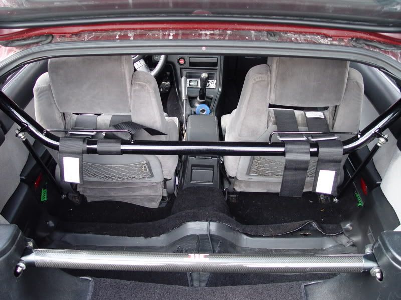

Thats the only picture i've found and i know the main part goes to where the seatbelts go but im not sure where the two verticle stabilizers go.

Do not run that bar with out the vertical bars, those harness bars look like a death trap as it is. I would say that the vertical bard bolt into the stock lower belt spots with the bolts that held the lower belts in place that why there was no hardware.

This was actually a little tough to photograph; but, let me know if you need a different angle or what not...
Sorry if this is too late by the way.

it bolts to where the stock seatbelt bolts too at the bottom. was your stock seatbelt on when you put dynomat on? If so you should still see it, if not start poking around and hopefully go through the dynomat then take off what you need to bolt it in.
