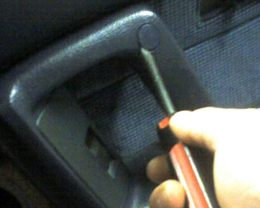

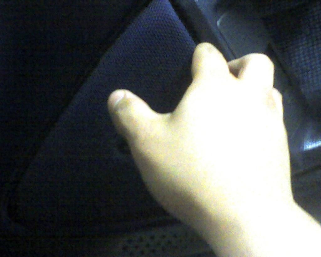

Spoon feeding... (oh & sorry guys for the crap quality. my ancient potato (phone) is old & crappy)

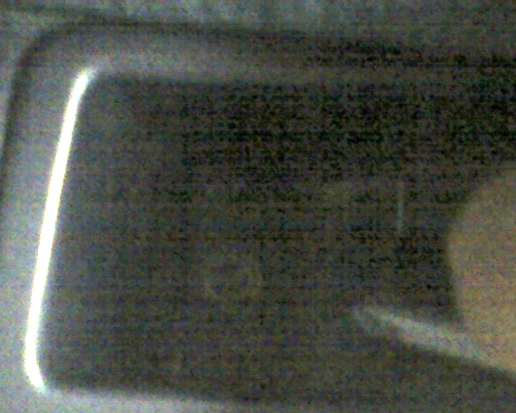

Take this off
To get to the phillips screw behind it. theres two you have to remove

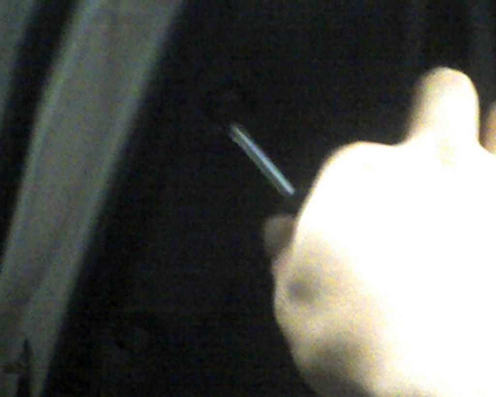

This pops off

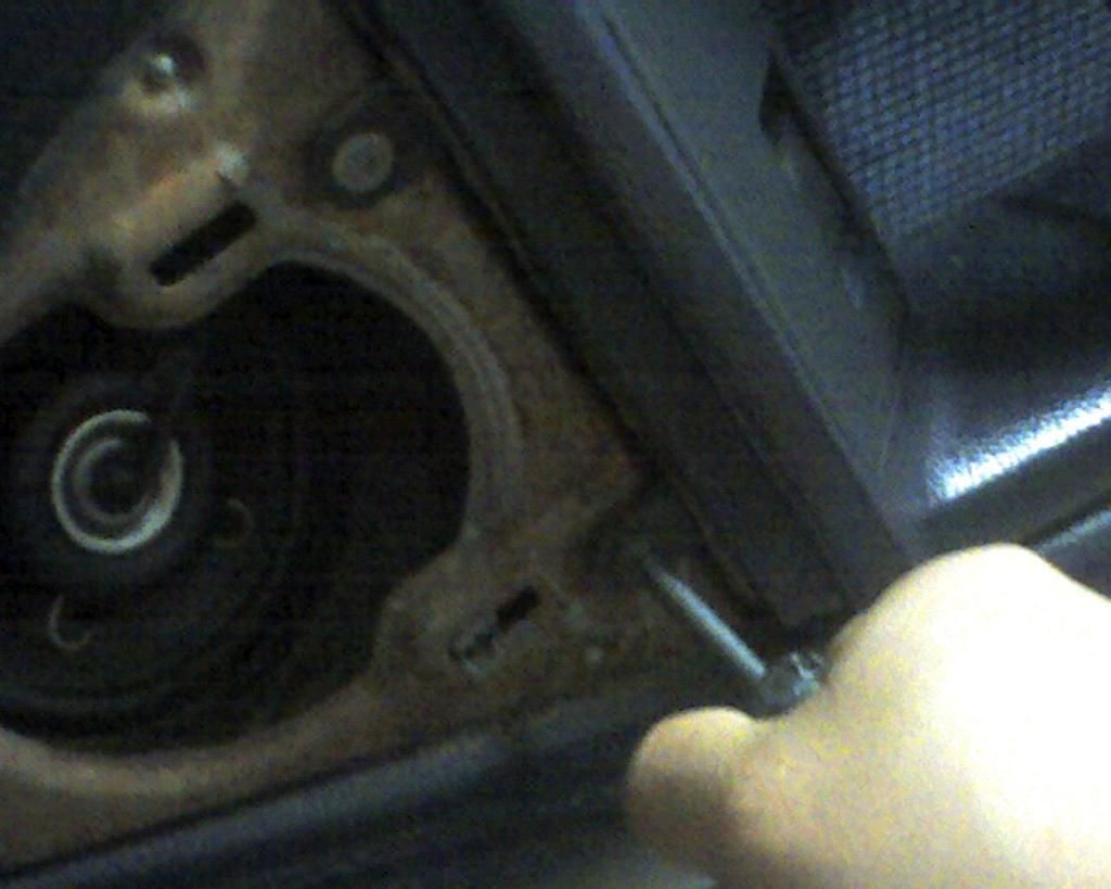

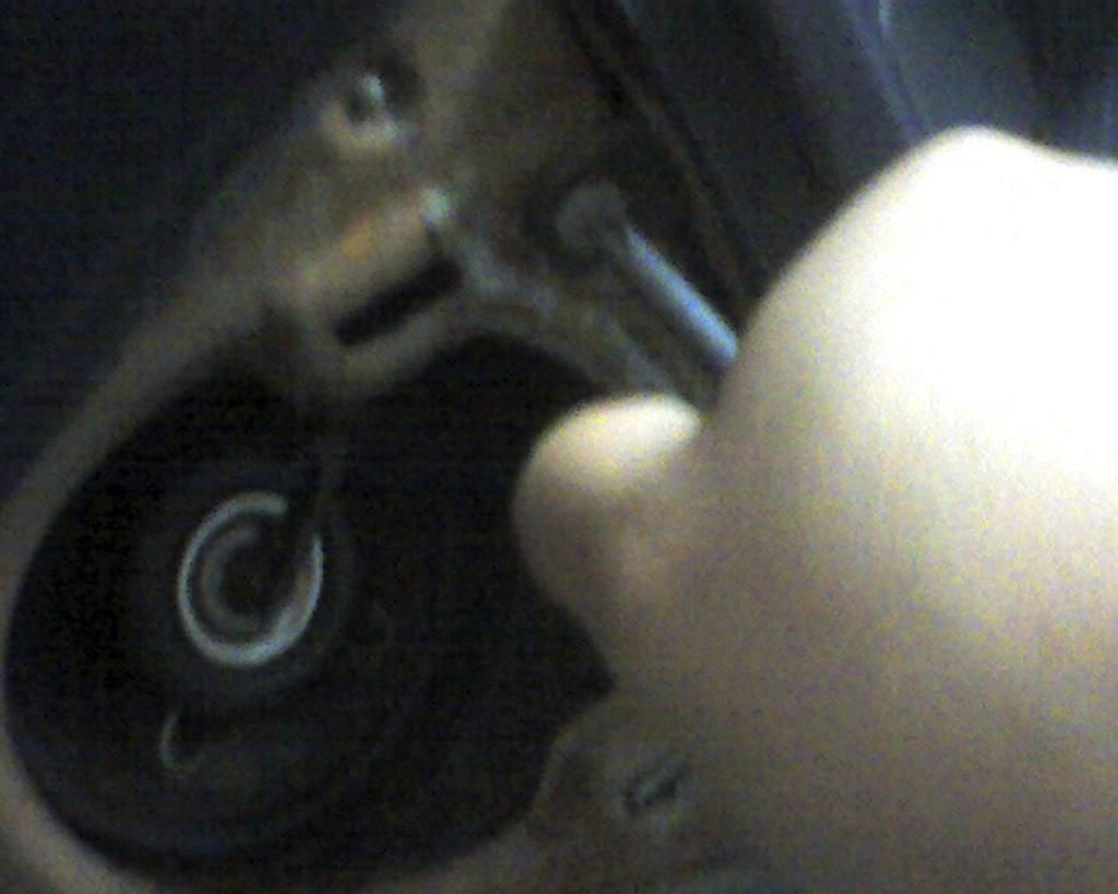

Theres two.. duuhh

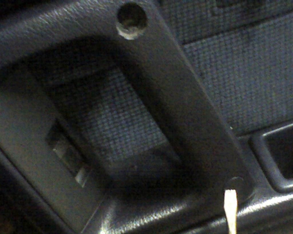

here are these two that have some sort of cap on them. with a flat head take of the caps to uncover the phillips screw & use a phillips screwdriver to get those two out.

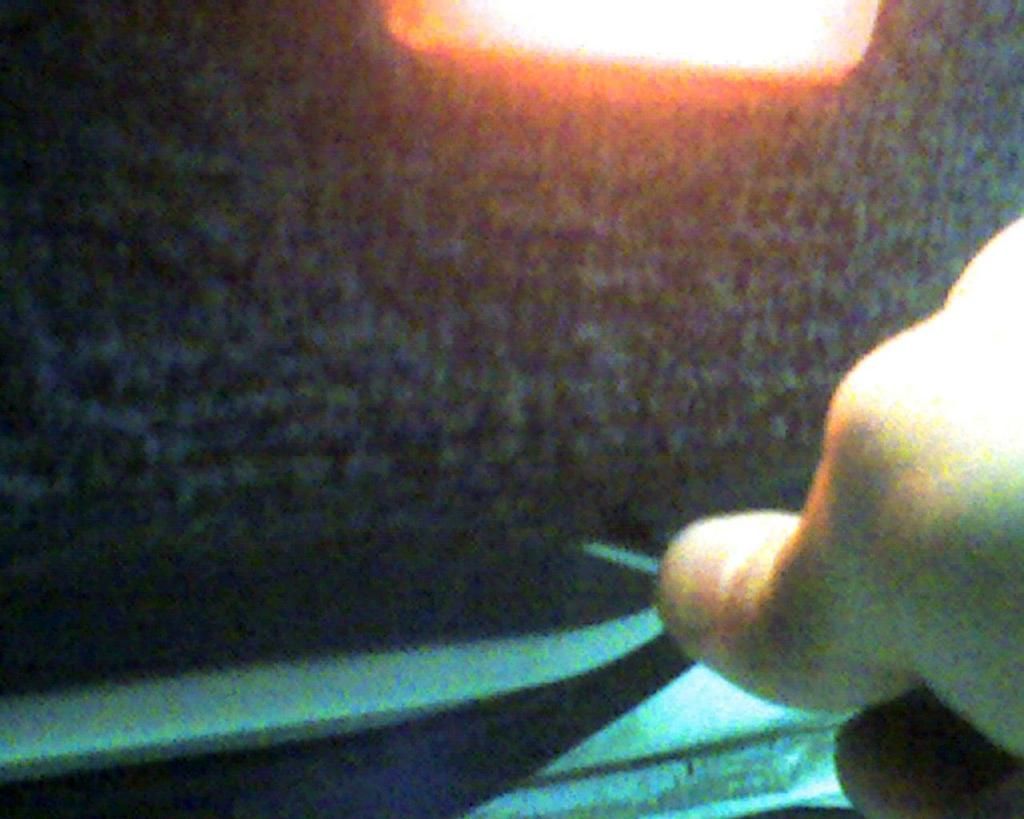

& the one by the door handle..

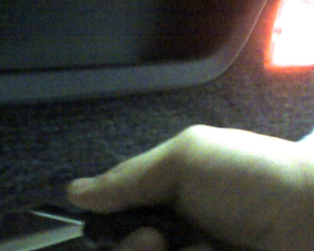

& theres about 5 screws down underneath.

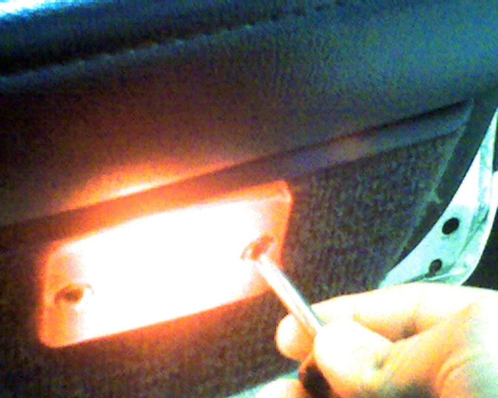

& of course the courtesy light!
did i miss anything guys? i think after getting all those out you should be able to pop it forward then upwards

GrimJack;1809425 said:
Someone forgot to mention the two screws holding the light in the bottom corner. It's much easier if you pull those, unclip the wires to the light, and then pull the door panel.
oh yea. i usually just unhook the connector once the panel is loose.
