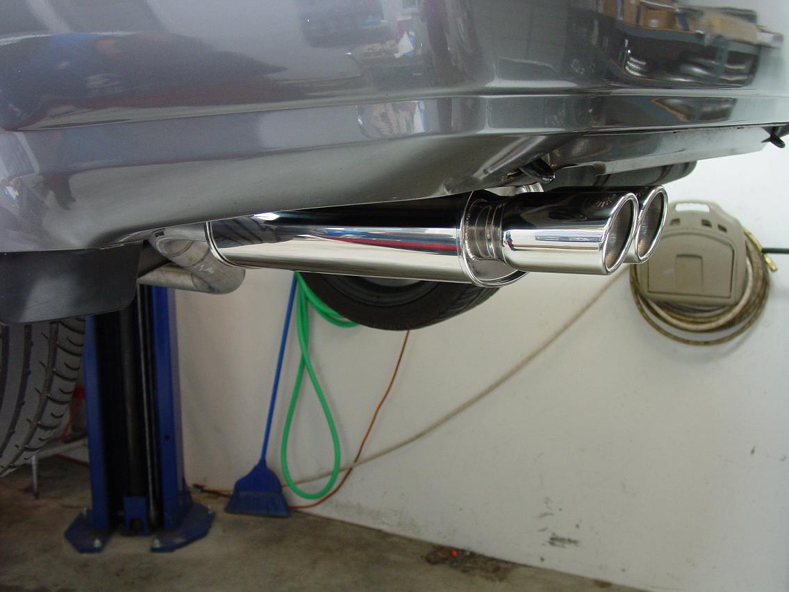

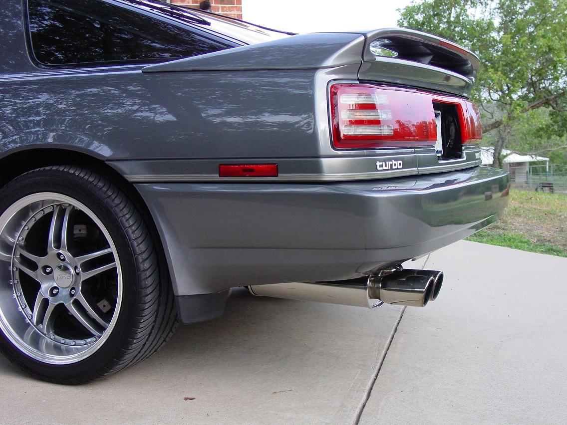

I wasn't able to find a 3" HKS exhaust with dual tips, so I had a system made to match up with my 3" DP. Cost about $650 complete and installed.

I snapped a few quick pics in the garage.
Ben
