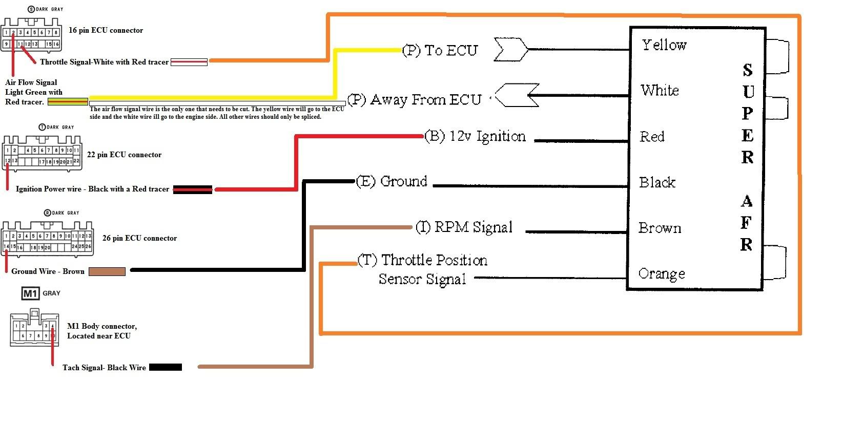

HKS SUPER AFR WIRING? stumped!
MINA
Jan 19, 2010
162
sacramento
hello so i have searched and searched that's all i do here i got the wiring diagram from HKS but am confused on how to wire it to the ecu. i have 1990 supra turbo and i looked at the www.cygnusx1.net/
pin out and i cant find a decent pin out few things are missing can any one shine some light on this topic i found one thread but they only asked if some was using it and how the liked it. i always search and receive here that's why i don't post much! but this time i hit a wall any in put is appreciated.
-mina

OK just to verify you do have a 1990 Supra correct? Your profile says you have an 1987. The pin out I'm going to give you is for a 1990.
