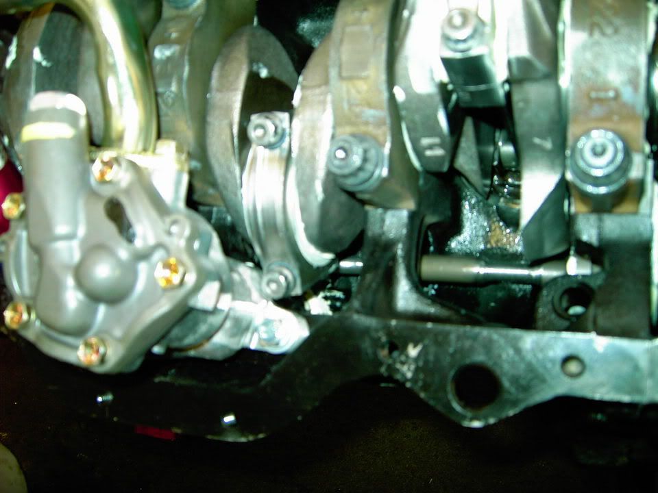

What I did to the shaft was to cut the old 4M mechanical fuel pump cam off it,
so that it was not acting like a bob-weight.

My oil pump shaft is machined to clear the Pauter rods.. (Remember, I'm running a 97mm stroke engine.. What's stock.. 90.5mm...?) It is not any thinner than stock.. the thinned down areas are just slightly wider.. On a the previous stroker, when the crank twisted out of true by 7thousands, it had the shoulder of the rod hitting the oil pump drive.. actually pushed the rod forward, and ruined it by ramming it into the retainer plate. I was suprised it did not break it. The Pauter rod was fine. I sent it back to Pauter, they checked it out, and said no problems.
