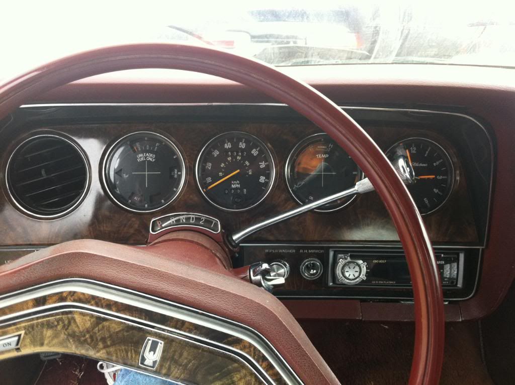

Pics you say?? Well I'm going to warn you now it's a tank, a beater, a big ass car. I think I shall name her Monster Bitch. These pics were taken before I cleaned it up, not that a wash made it look much better but vacuuming it did.
1979 Thunderbird Town Landau
351W 2bb with C6 Auto
This car is equipped with just about every option you could get on a T-bird including a sunroof, leather and...get this...a rear defrost!!!

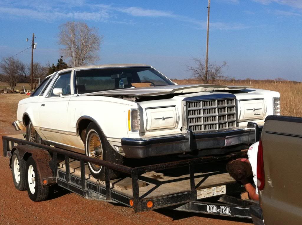

Here it is on the trailer:

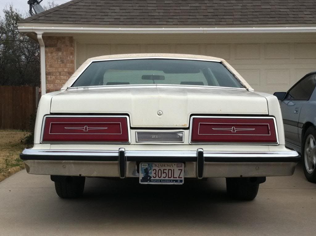

Sitting in my driveway next to the engine-less supra. My neighbors are gonna hate me.

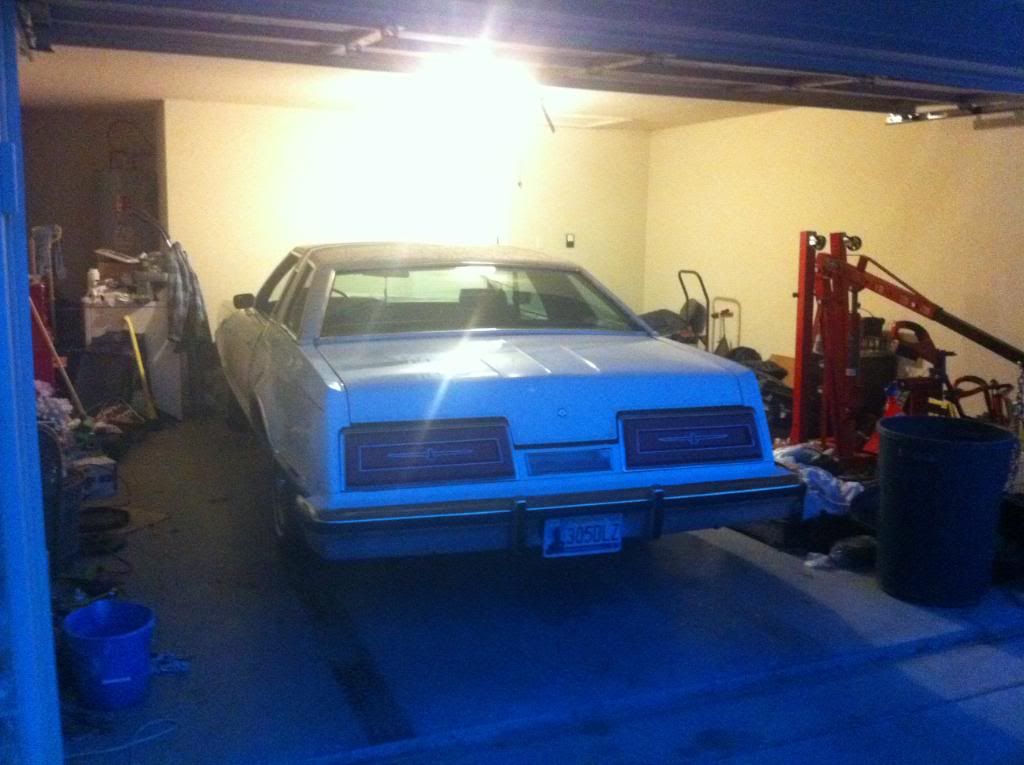

And believe it or not that big beotch fit in the garage. The Lexus is on driveway duty until I thin out the car population.

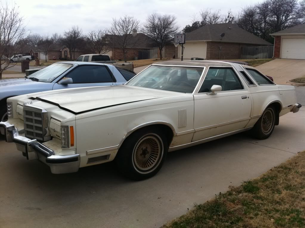

Another profile shot in the driveway
---------- Post added at 12:08 PM ---------- Previous post was at 11:59 AM ----------
Oh I had to adjust the hood latch but the hood now stays shut.
