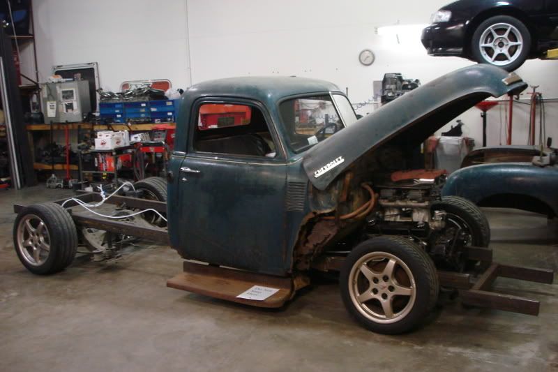

heres why i havent been updating my ma70tt thread
ma70tt
Jan 31, 2007
63
deerfield

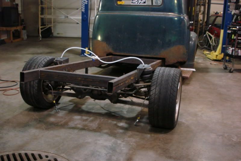

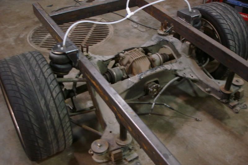

its a 1948 chevy 4100, i have already fab'd the basic frame to accept the suspension from my back halved mkIII. now i need some help from my supramania friends. first up is i need a rear suspension crossmember from a mkIII supra so i can make a jig to fab a tubular version. so whoever has one let me know. the closer it is to madison, wi the better. i dont care if its rusty or dirty/greasy, just has to be straight and available. once the jig is made i will be able to supply everyone in the supra community with a high quality/stronger solution to the so so stock rear crossmember.

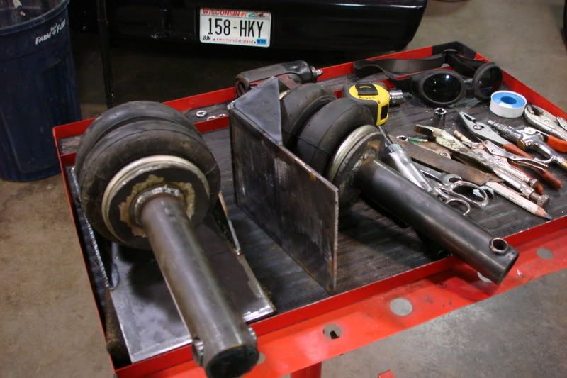

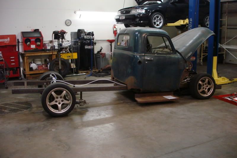

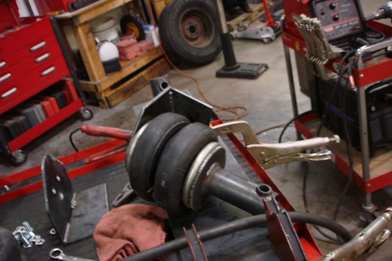

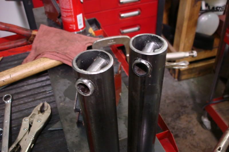

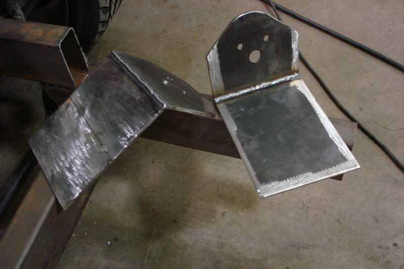

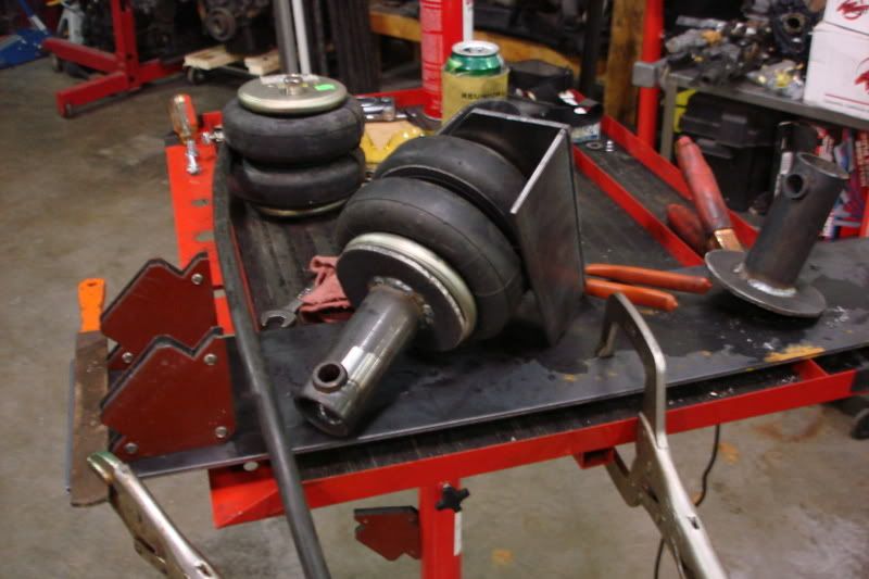

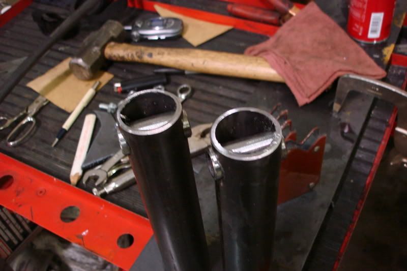

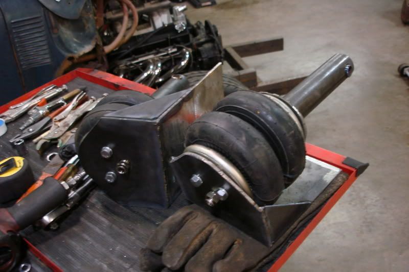

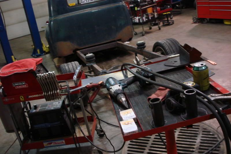

done fab'ing the struts. the rear is done except for shocks. i still have to plasma cut out the side braces for the front top strut mount. ill post some pics as sonn as photobucket gets done bein' slow...
here ya go...

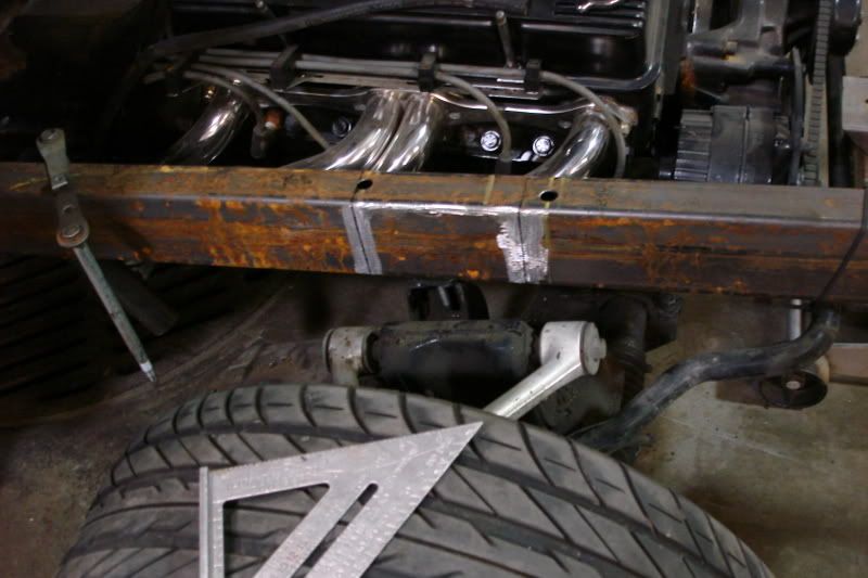

no frame layin'. this is not a lowrider/mini truck.

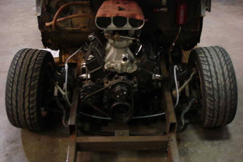

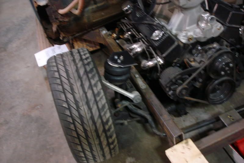

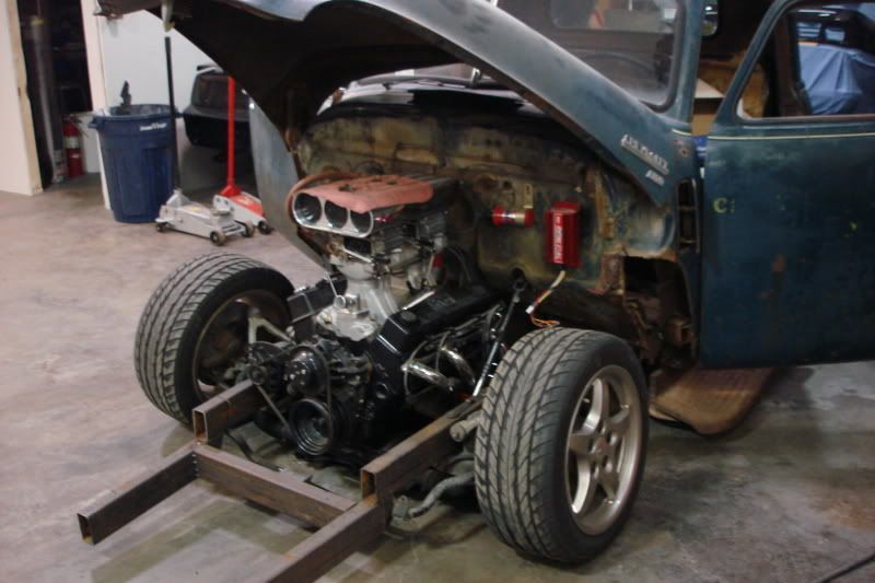

well heres her first time down on her own, sorry about the quality, its just me an my cybershot tonight...
