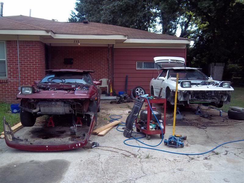

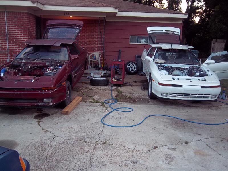

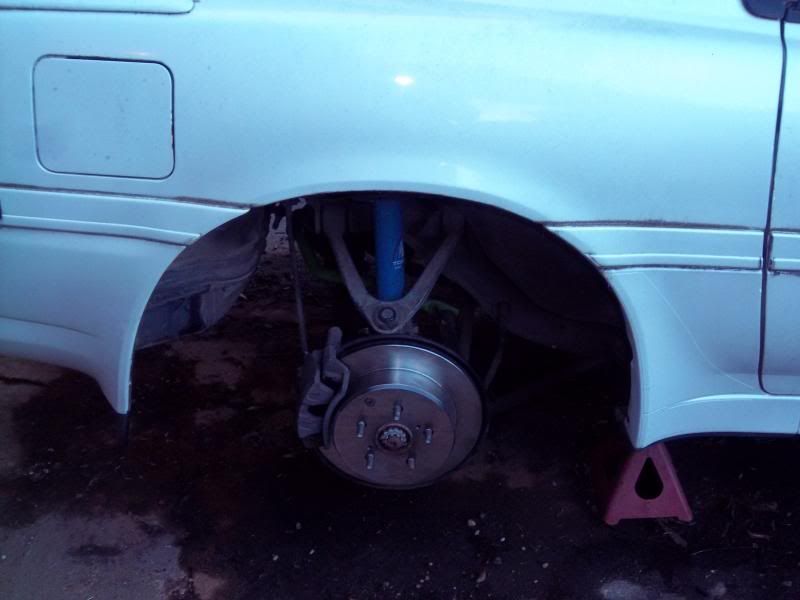

So, right now the major part of this build-up is swapping all of the performance parts from the 87 chassis over to the 90 chassis. Then swapping all of the stock stuff from the 90 chassis to the 87 chassis. Tokiko blues, Eibach springs, ST sway bars, oil cooler and inter cooler and MAFT pro are all coming over to the new chassis. The 87 will be returned to a stock turbo car. So at the moment everything I am doing is happening twice. Last weekend I got the front suspension swapped around. This weekend is all focused on the rear end. Am also replacing all the brakes and steering rack on the 90 chassis while I am at all of this.

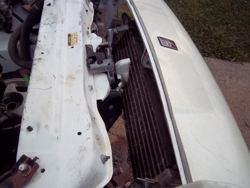

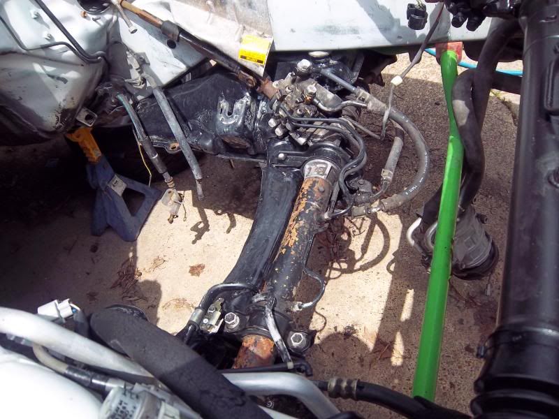

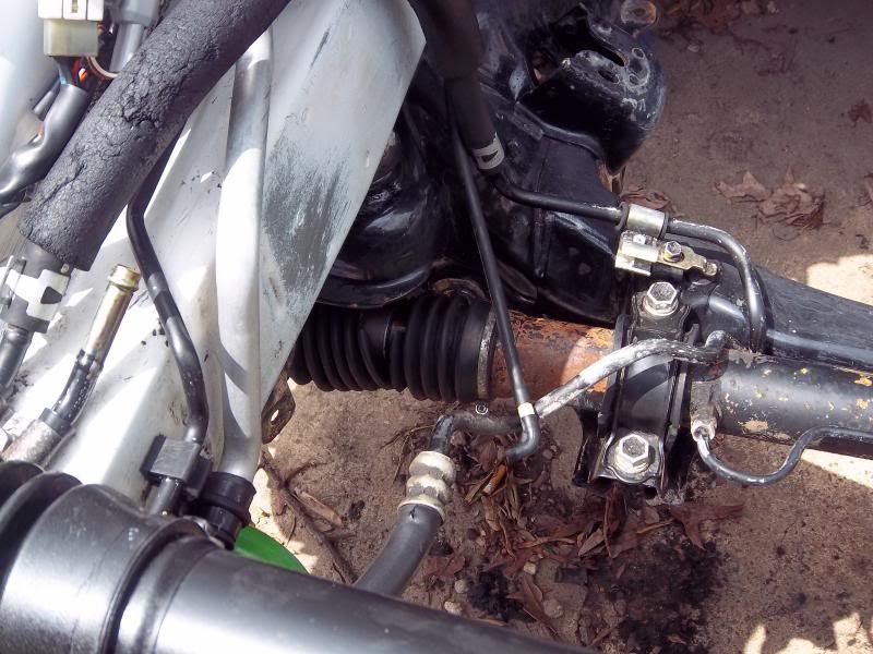

More progress today. Removed the old leaking PS rack. The PPS valve almost made me go purchase a metric adjustable wrench. Thankfully my standard adjustable wrench came through. Couldn't find any good P/S rack bushings so I didn't mount the new rack down yet. It is in place just waiting on new bushings. Did clean all of the gunk and grime off of the front cross-member and control arms while everything was disassembled. Removed all of the factory inter-cooler and piping as well as stock oil cooler and piping to make room for my upgraded pieces from the 87 chassis. Got the factory stuff mounted on the old chassis and bumper placed back on it. Lastly, I pulled all of the electronics out of the 87 chassis that I will be using in the new car.

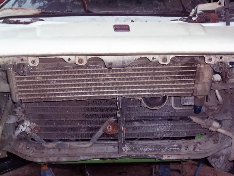

OIl cooler is fabbed in . Have to replace the condensor fan before I can final bolt it all in place but can get everything around it fabbed up. Inter-cooler will be next.
