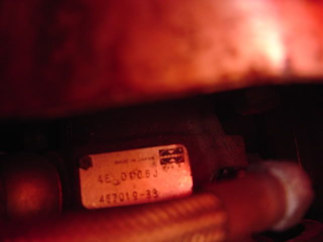

pm soapra aka Jose Valle about it. He was the one running the 1J HKS Twins...
soapra;495943 said:
They are gt25XX . The original HKS power potential was of 500ps to 550ps.
