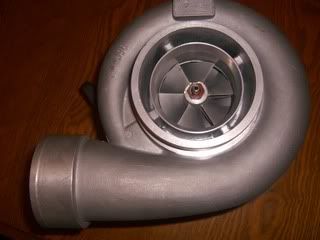

Inlet = 4 3/16"
Intake (ID / OD) = 2.25" / 3.25"
Inducer = 76.2 MM
Exducer = 92.1 MM
Trim = 69
A/R = 0.66
Turbine
Outlet = 4"
Turbo flange = T4 [twin entry divide tang flange]
Downpipe flange = 4.25" V-band
Inducer = 81.0 MM
Exducer = 77.8 MM
Trim = 92
A/R = 1.05
Center Section
Oil feed = T3
Oil return = T3
____________________________
Any ideas?
