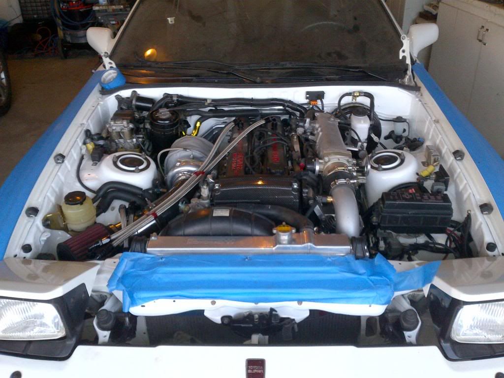

1. A catch can will only collect oil if there is air going in, and air going out. See photo below. Note, hoses go from valve covers to can, can to pre-turbo. The can has baffles to help condense the oil. I also have a PCV valve from a DSM in the valve cover to maintain crankcase vacuum, tied into the intake manifold, but it is not shown in this photo)
2. Out the front of the engine, you can leak from the cam seals, the crank seal, the oil pump shaft seal, the head gasket, and the oil pan. If your PCV system is buggered and/or you are building excessive crankcase pressure, you will blow oil out of your rotating seals, that is almost guaranteed.
In short, you need to pull a slight vacuum on the crankcase under vacuum. PCV is all about flow.
Also, based on personal experience, broken ringlands on a piston will cause major blowby. You can find this with a compression test. If one or more cylinders are around 100 psi, well, it is rebuild time.
