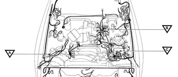

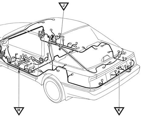

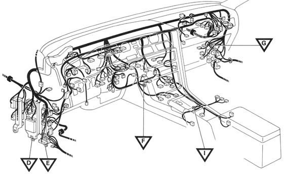

TSRM Ground Reference
A - Right Fender - It is right under your upper IC piping where it travels through the fender
B - Intake Manifold - Under intake manifold, I believe stock it is attacked to same bolt as the metal vacuum line there.
C - Left Fender - Directly under the fuse box. You can follow the bracket on the ignitor down to this point.
D - J/B No 1 Set Bolt // E - Left Kick Pnael // F - Radio Left // G - R/B No 4 Set Bolt // I - Floor Center
H - Floor Left // J - Floor Right // K - Back Panel Center
