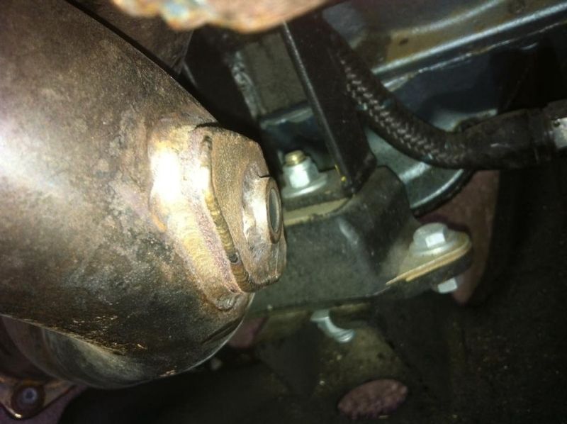

code 52 was also found after doing a oil change earlier this week. Was a ripped wire from rear knock sensor which was repaired today. I also made a extension from the existing o2 sensor harness to my rear chinaman Y-pipe runner and converted a threaded mustang o2 we had around the house with no positive results. The damn Y-pipe has a temp bung in the front runner and threaded o2 in the rear (perfect for wideband) so I wa never able to simply bolt up my o2 but I am suspecting the bolt on flange is under the surface.

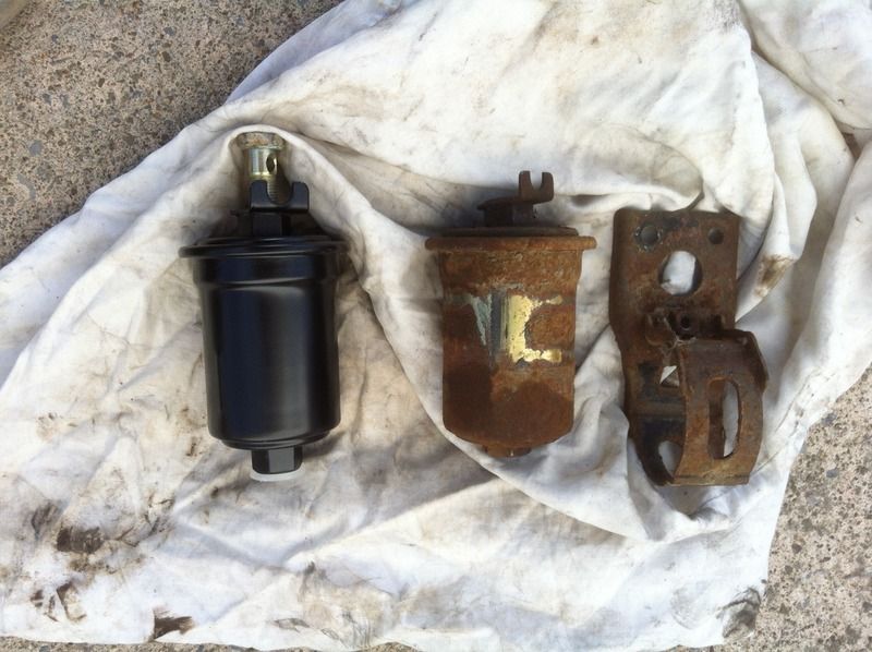

Meanwhile there is a 1JZ VVT-i swapped MK2 in town and he was asking me for coils, because he had the same problem. Turns out he just solved his issue after discovering the flexible fuel line on top of the fuel pump was loose enough to drop fuel back in to the tank instead of sending it to the fuel rail. Since I don't have my wideband set up just yet and I don't have a FPR, I am ordering a new OEM replacement fuel filter and dropping the tank to double check the TT pump and mounts. 12v mod using factory relay has been done since the swap.

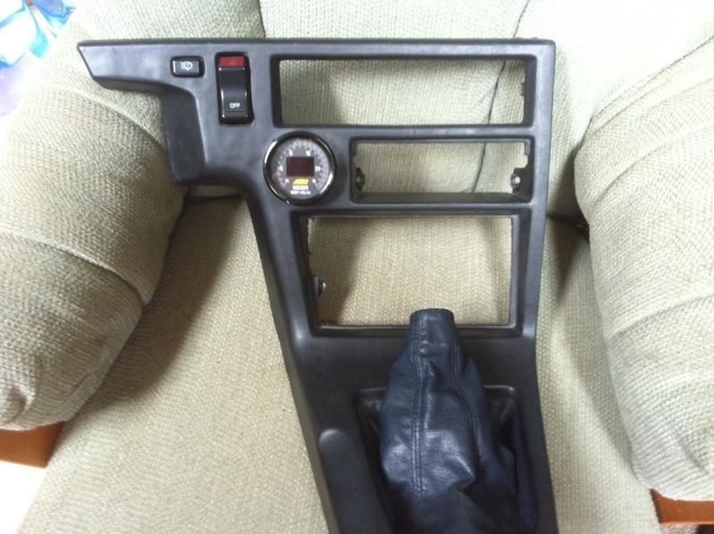

AEM 2 in 1 wideband & boost gauge to be the only aftermarket gauge in car.

Connecting a Mustang threaded o2 sensor where I was wishing to install my wideband made a huge difference, then changed what looks like the original fuel filter made a bit of a difference, and finally changing the plugs and gapping them to .034 (stock boost) took the cake.
