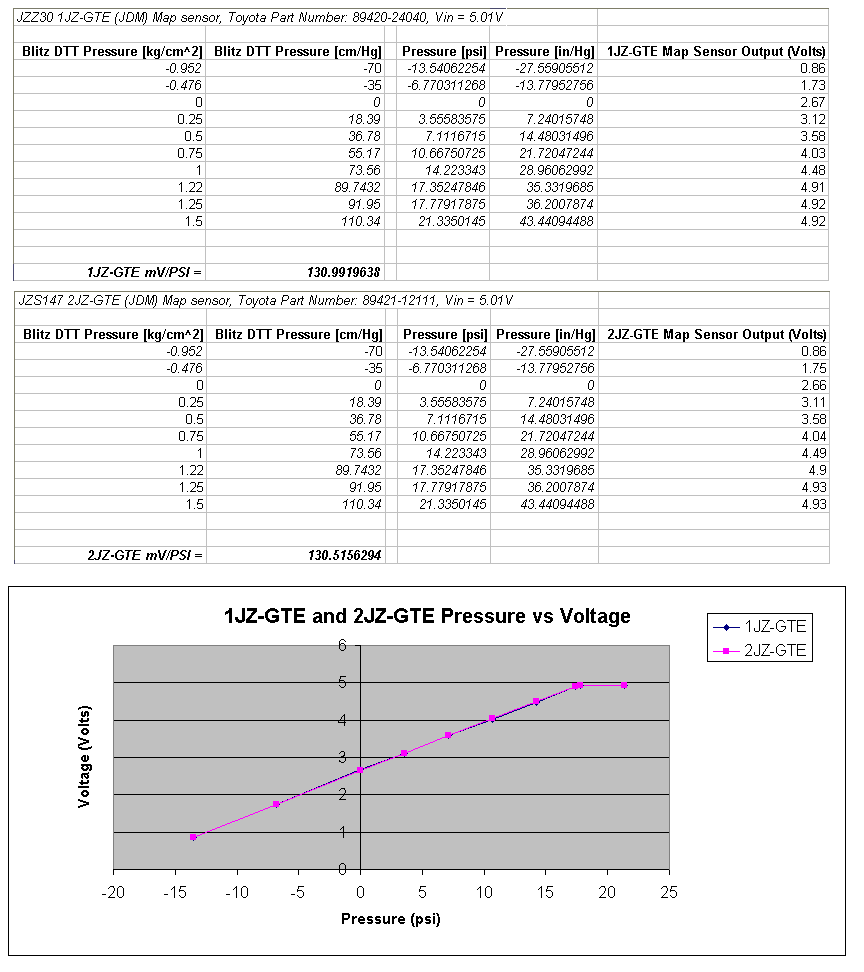

So for those of us with out standalones. Have any of you tryd this map clamp trick to raise or eliminate your fuel cut on a 1j ..
Here is the link if you have not seen this http://www.thedodgegarage.com/turbo_map.html
So I am contenplating on trying this and just controlling boost with the saftey features on my true boost. And controlling fuel with the afc. What are your thought and does it work? I don't see any reason why I wouldn't work. I already have the diaods in my garage and they keep telling me to put them in..(don't act like your parts don't talk to you either.)lol
