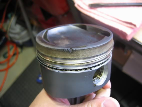

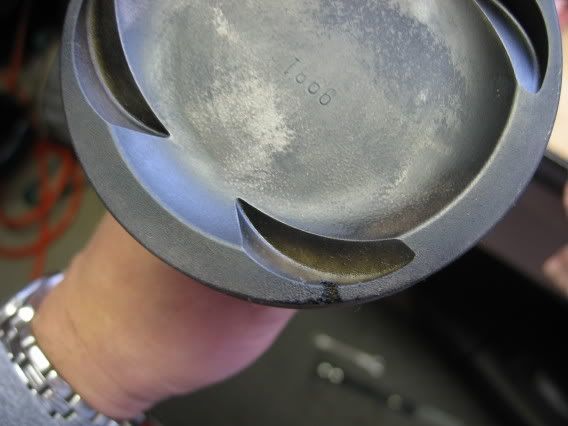

I drove this set up for about 3000 miles and loved the power it delivered, but we could never seem to get it tuned correctly. I bought an Innovative LM-1 WB to help, but still couldn’t get the car to run as strong as it could. Then I decided to go standalone and bought and installed an AEM EMS, Magnacore plug wires, colder iridium plugs, had it tuned by 9Second Racing, and loved spinning the tires at 80+mph! She went from pretty strong to HOLY SHIT Strong! The problem was that the tune was terribly lean and I ended up melting a piston. 9second didn’t want to help out so I started another rebuild.

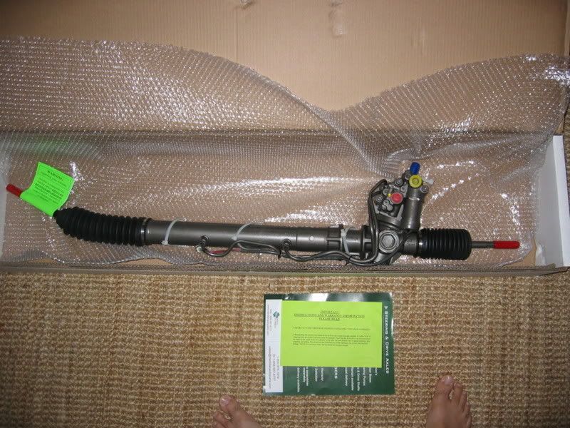

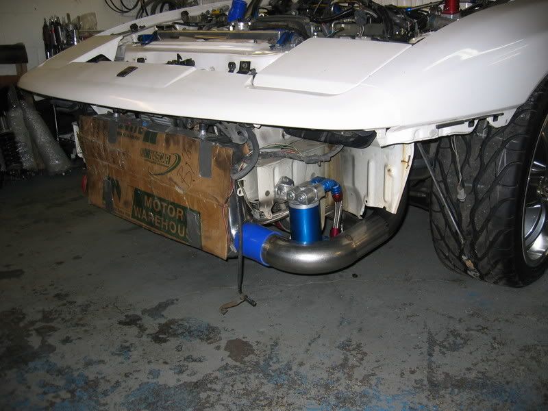

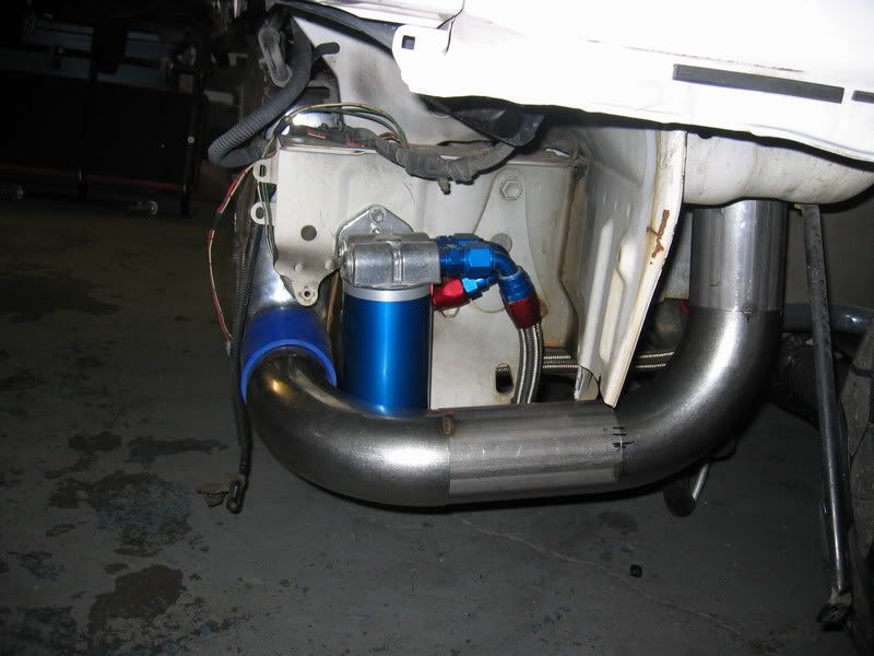

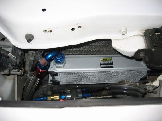

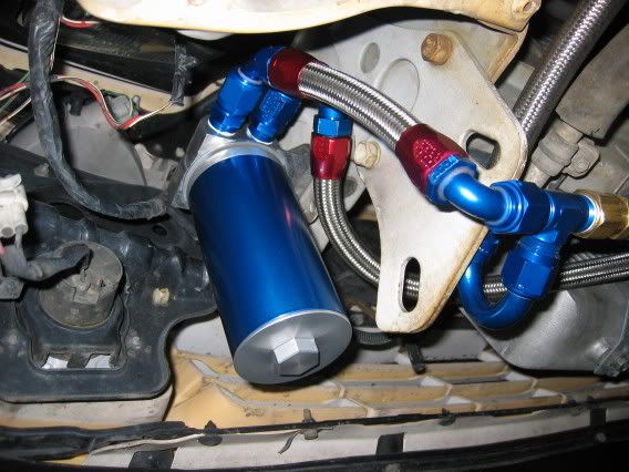

Into the new engine went 0.040 Wiseco coated slugs, new bearings, new water pump, brand new factory wiring harness, new oil cooler, and Canton Mecca Accusump and 8micron remote filter system, new starter and alternator, new factory Toyota battery cables. Remanufactured progressive steering rack with SupraSport bushings.

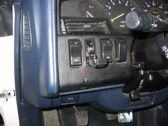

Wired the on/off switch for the Accusump into one of the coin holders:

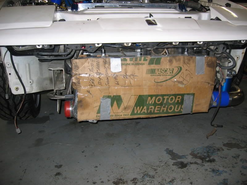

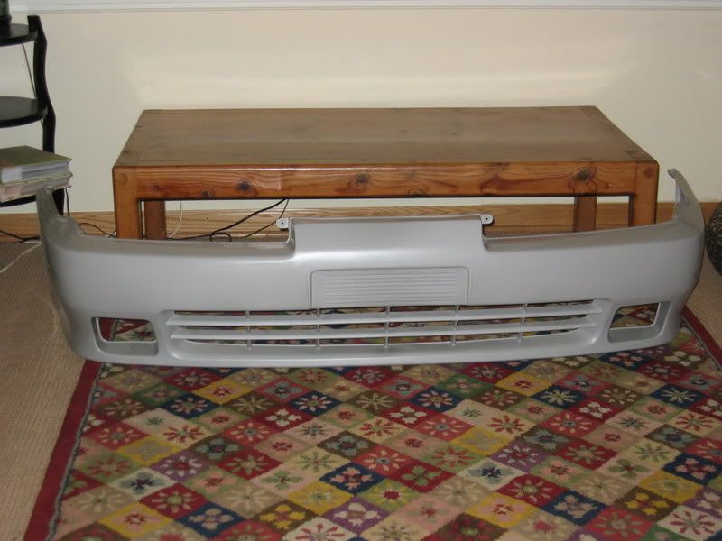

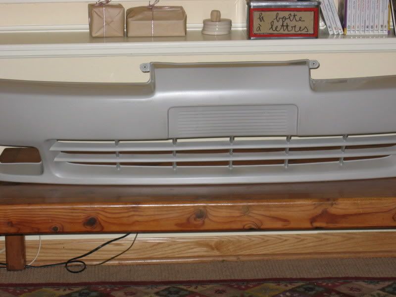

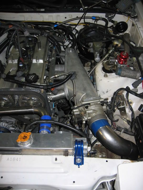

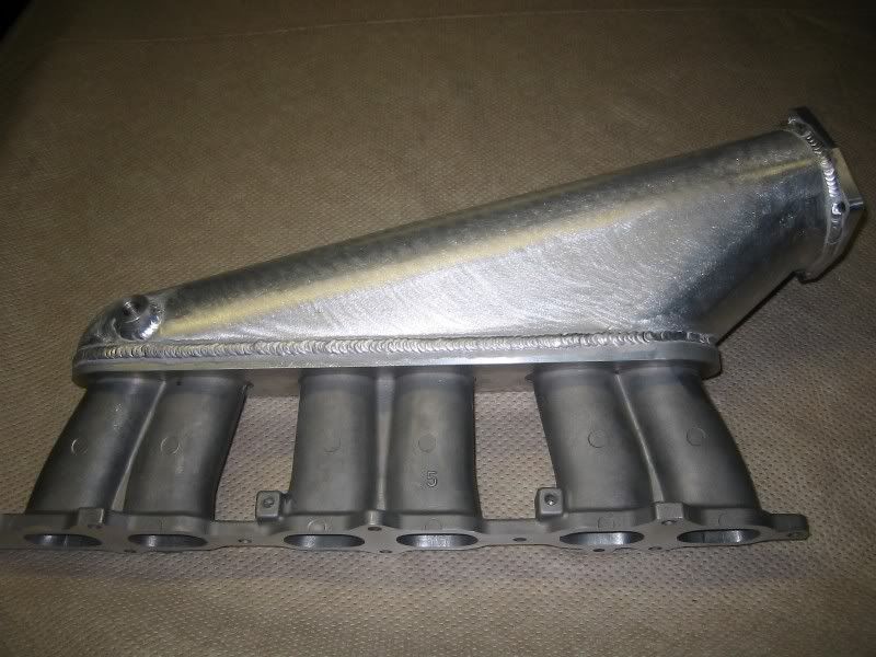

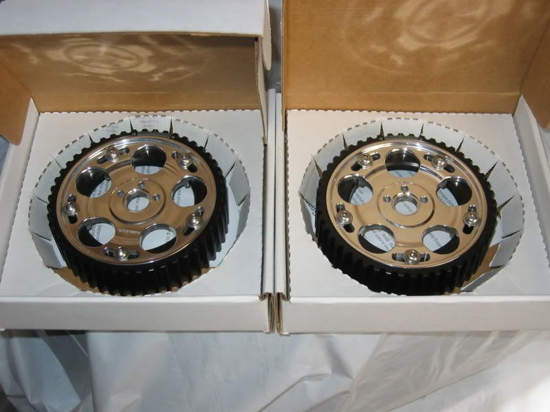

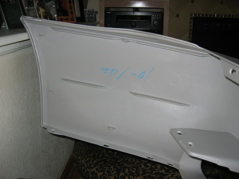

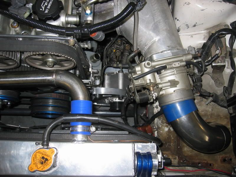

The latest set up has a Ron R. short runner manifold and alt bracket, 780cc injectors, Q45 throttle body, Hayabusa coils, MSD-4, 12x24x3 intercooler, HKS SSQV, AEM UEGO with gauge, Lo-Tec triple pillar pod, custom stainless steel hard pipes (2.5” hot side, 3” cold side), custom upper and lower radiator pipes, stainless 4” intake, N/A PS reservoir, Greddy catch can vented through the exhaust, Titan adjustable cam gears, LIPP traction arms, brand new factory Toyota bumper skin with a Chargespeed Turbo-A-Duct, Shineauto East Bear lip (being prepped for paint as you read this).
Once the IC pipes are all finished they (along with the manifold, valve covers, rad pipes and a few other items) are going to be sent to the polisher for some bling bling love. The Q45 throttle body is probably going to be powder coated black or silver.

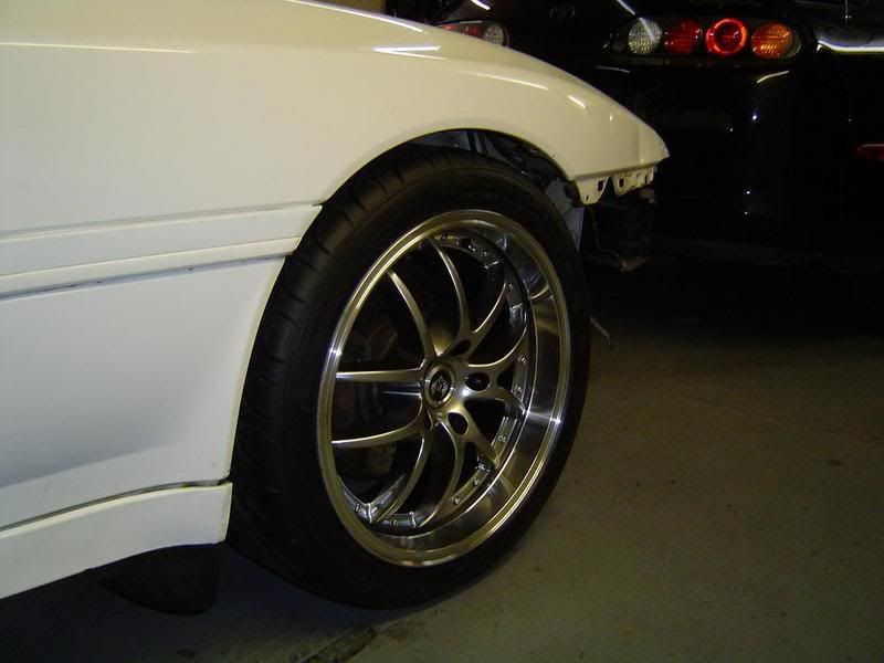

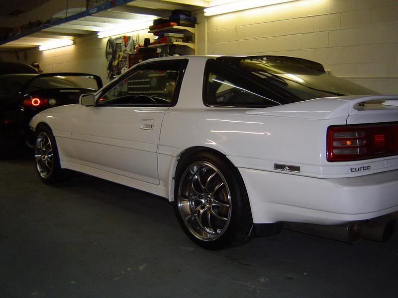

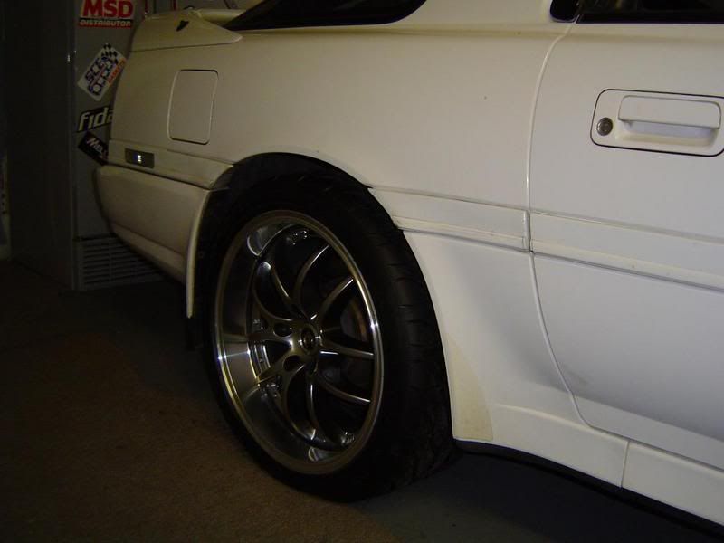

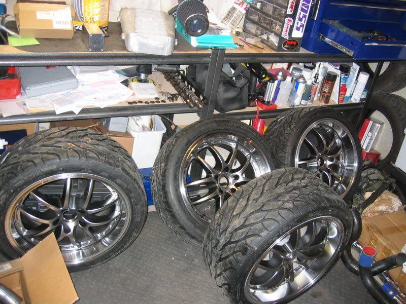

The new 18's:
They are by Stern (ADR) and are 18x8.5 with 245/40 front and 18x9.5 with 265/35 in the rear. Offset is 35 and 32The tires are BFG KDW-2s that I bought from Tire Rack. Here are some mounted pics:
(Kevin M. sunshade from the first GB a couple of years ago).

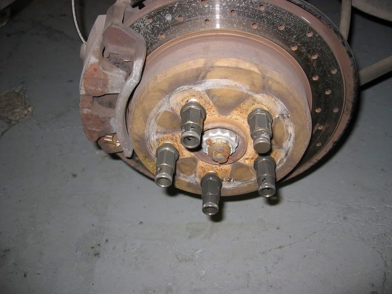

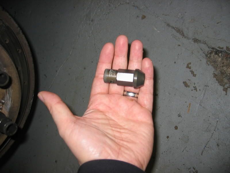

I also picked up some lightweight forged aluminum lug nuts and locks, these are amazingly light compared to the regular steel ones. These are by 5Zigen, but I have seen lots of other companies making them, they run about $100-135 for a set (16+4 locks and key), certainly not cheap but a good place to save some weight.

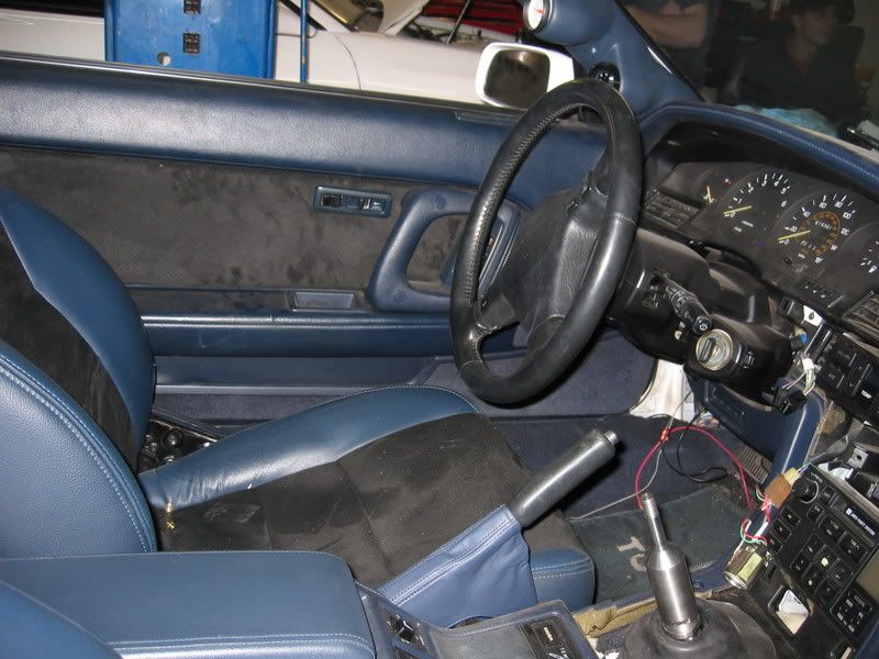

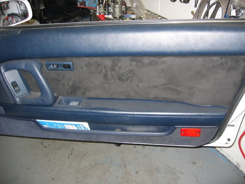

I got in on that leatherseats.com group buy in 2005, and had them put black perforated alacantra (fake suede) in the center and on the door panels. Loved how it turned out, but for the money I think the fit/quality could have been better (one of the tabs was sewn in the wrong spot, so it had to be corrected before they would fit; and there is alread a small wear spot on one of the side bolsters).
Some interior shots:
I do have the TRD GB knob and it fits great, there is no point in putting it on just to take it off to install the shifter boot (also brand new factory Toyota, along with the e-brake cover).
