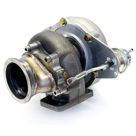

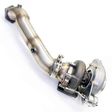

what about using a 3076 with internal wastegate? IMO the new design internally gated turbos up to that size range work quite well with internal wastegates.
Here's a typical one by ATP showing their latest and greatest internal gate design:
ATP blah blah:
Introducing the Ultimate Internal Wastegate!
For those that just prefer to go "internal", we now have a "no compromise" internal wastegate design available that will knock your socks off! Whatever the reason for sticking with the internal gate....whether it's to keep exhaust plumbing simple, or to minimize the amount of fabrication work, all of the flow benefits of the external are now available internal form.
